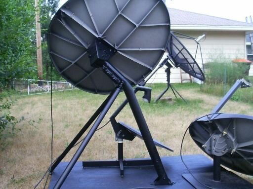

Here is an example. This is my StarChoice dish (which sees 107.3 & 111.1) and a DBS LNB added for 119
so in that picture from L-R it is 119, 111.1, 107.3
2nd picture was my G3/Nimiq1 setup
G3 is the "rectangle" LNB and 91 is the closer LNB (again, put on the opposite way)

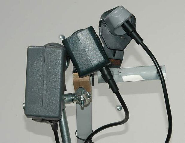

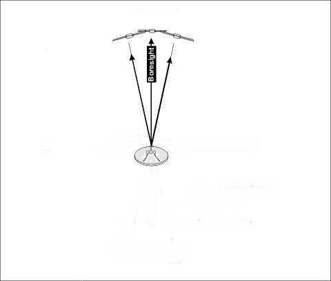

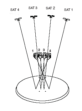

I found a better picture that should help visualise how the signals bounce into multi LNB's.............
PSB,

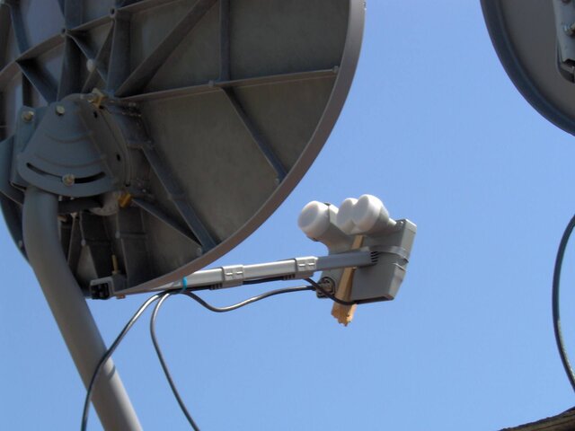

With a setup we see in the picture you posted, is the signal strength the same as pointing directly at the satellite?
You will NEVER get as much signal as pointing directly at the satellite with one LNBF in the main focal position, but its not so much of an issue with oval dish.

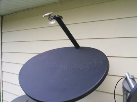

Ok thanks guys understand it now.That last picture its neat never seen the LNB arm from the top before
So an oval Primestar dish would work great for that.

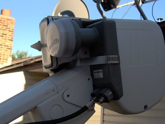

The SC dishes can be skewed. Both are made by ChannelMaster
