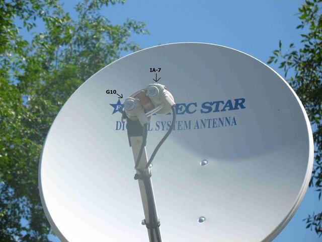

ok will try that.I will have to add that sat to my menu and put in that TP and see..I can try that Dtv lnb if I get no signal then I know I can't use it.
A DirecTV LNB will work fine for Echostar 7 @ 119ºw with your L.O. set to 11250
Question Can this be done and work.I have that old Primestar which is 36x39.I just re-disassembled it and flip it over to where the Diameter is 39 instead of 36.I would have to re calculate the focal distance.I just wonderd if this would work since its an eliptical dish and not an oval
Thanks was hoping to get IA-5 but realized the Distance between G10 and IA-5 is too great unless I have a motor.just have to see what else I can add to that staionary Dish for now
question .I bought a DMSI 4x1 diseqc switch and have the LNBF at echostar 7 and have all FTA channels thats available plus the music ones.I am using the directv LNBF now is the settings like this in the menu.I'm getting 94% quality
LNB 3
L.O 11250
22khz off < is this supposed to be ON or OFF?
Diseqc on
is this correct?
