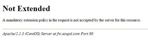

Trouble logging on to the AZBox FW release site
If you are having trouble logging on to the site: http://fw.azupd.com/ just keep trying. There is evidentally a server issue, which has been reported elsewhere, but if you keep retrying it will eventually open.
You might see this error:
