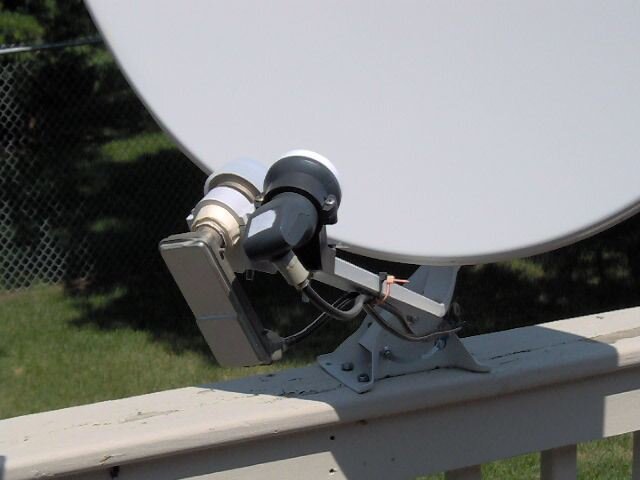

Like the left LNB in the below pic? (that is my 123/119 setup at one time)
if its the body you dont need plastic on it...its sealed already :)
Yep! That's it Ice! It doesn't matter if it is covered, does it?:confused: Otherwise, i have to go and unrap that LNB. :(
