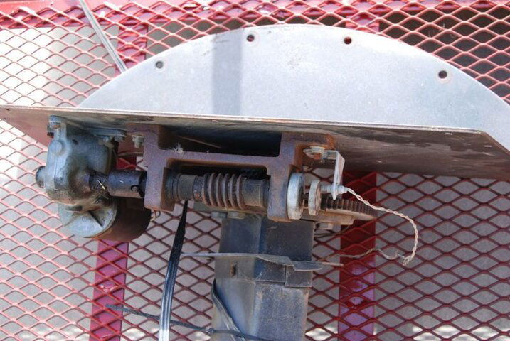

Fred I'm also going to take some close up photos of the gears so you can see the condition of them and maybe you can advise me on them and also point me towards a place where I can get replacement parts for the missing plastic gear box cover and plastic feedhorn cover. It looks like it is set up for only C-Band too.

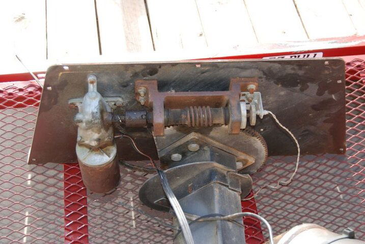

I doubt you will be able to find a cover for the gears, so you will just have to make one. It doesn't have to bolt on, but if you can find some plastic pieces that have a flange, you can drill holes in it and start the frame of one. All you need is something to keep the worst of the weather off the electric parts. The gears can be greased periodically.

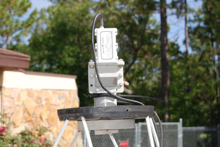

As to the feed-horn cover. The OEM covers don't work with a Co-Rotor on it. Too short. The new one I got from the dealer in Nashville was a one of a kind find. I made the one on my Perfed out of a 5 gallon bucket and cut it off at the 4 gallon mark. Works perfect. I used some L shaped aluminum and made 3 brackets to hold it to the scaler. It has been hanging on through some heavy snows and pretty good storms. :)

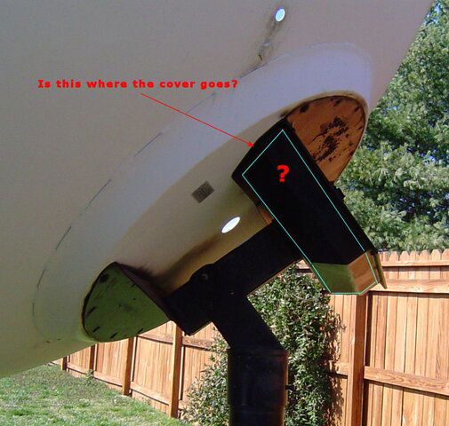

I'm also enclosing in this message a photo of your mount and what appears to be where the plastic cover goes. I'm hoping that I'm right in thinking that. I may know better after I take a look at it closer in the trailer later today. If I do have to fabricate one myself, do I glue two sides to a bottom with a flange on the ends of it to fit onto the mount? Do you have any ideas as to how to make one? Or maybe one can be made of light weight aluminum?
Thank you very much,
Tom
That is the plastic cover. It attaches with 7 bolts around the top. It does not attach to the dish itself. Can't think right now of where to start on making one. Aluminum or plastic would be the best bet for materials. Might get a gutter guy or aluminum siding guy to make one with a metal brake. That would be easiest. :)

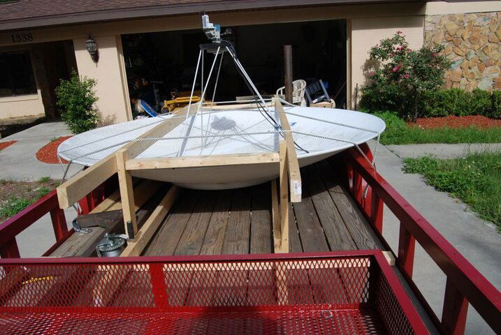

It's Tuesday afternoon and I'm still trying to make up for lost sleep! It was a long trip to get there and to come back, but well worth it. Not only did I get my first Birdview Dish, but I also met such a gracious and kindhearted couple! It was an indeed pleasure to meet the both of you Steve and Beth!

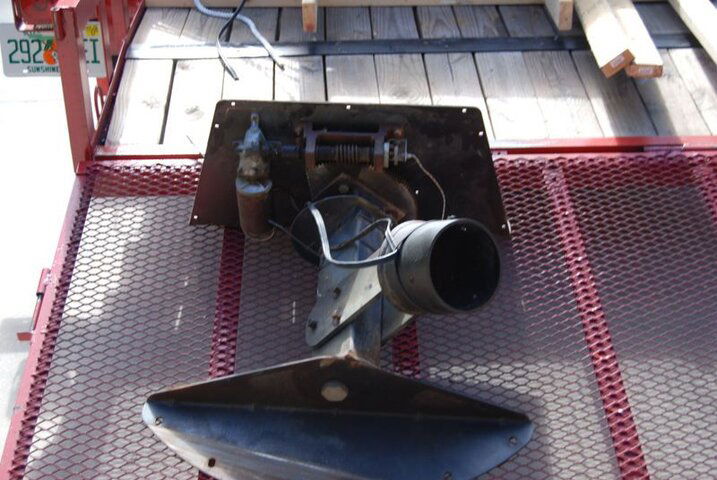

Today I went out to try to clean up the dish using soap and water to get off the years of grime that was on the dish. Some came off. I'm thinking that I will have to take it to a car wash and use the pressure gun to get it to a clean state. The decal of the Birdview logo is mostly missing. I have been trying to find a decent image on the Internet to duplicate for this dish.

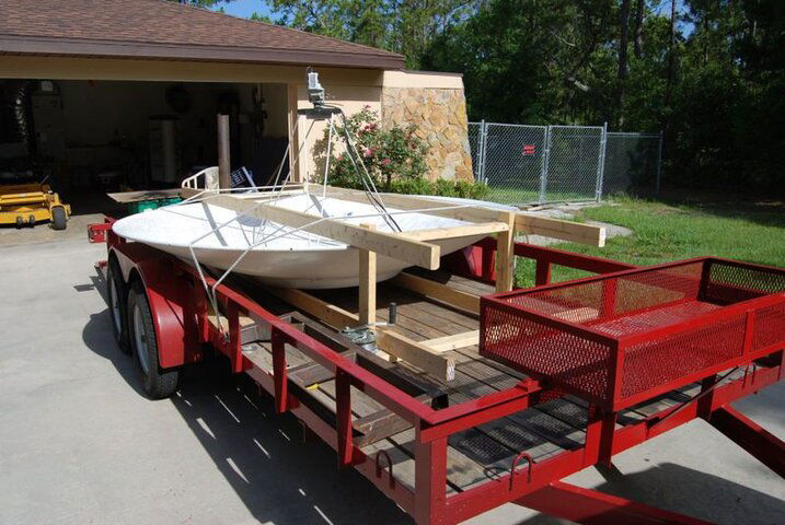

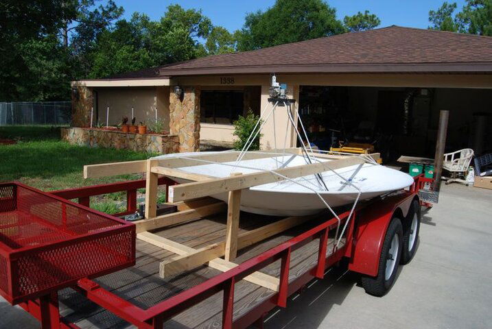

I have taken some photo's of the Birdview on the trailer in its custom packing crate. Thanks go to Fred for that idea. It kept it snug on the way back here to Florida from Texas.

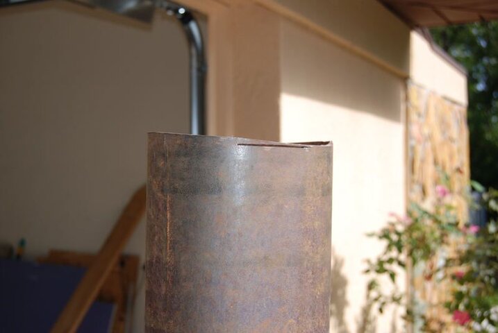

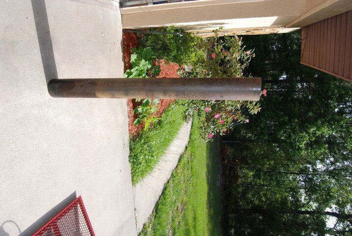

I took other photos too of the feedhorn, mount, and support pole. It looks like its set up for only C-Band. I'm missing the Feedhorn cover, however Fred has suggested in making one of a five gallon bucket and cutting it off at four gallons in size. Sounds like a great idea, unless I come up with a feedhorn cover for a Birdview that will hold a Chaparral Corotor II??

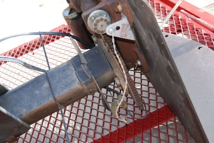

I tried to get close ups on the mount and to show the motor and the gears. Hope that it looks ok to you guys. I think I stated here that its missing the plastic cover that goes over the gears. Fred also suggested in having one made up from a place that makes aluminum gutters. If any of you have a photo of this type of cover I sure would appreciate it, knowing that these companies would want dimensions for such a cover. Thanks in advance for that request.

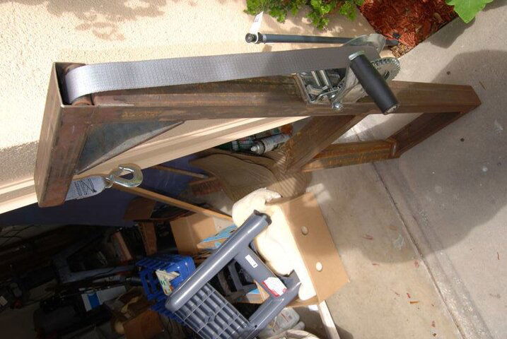

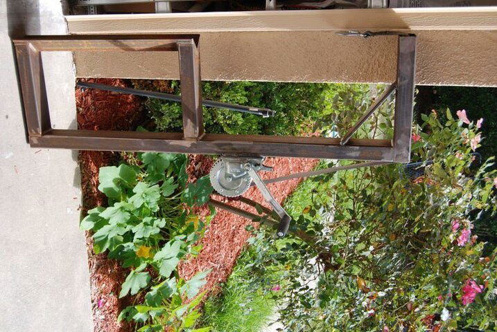

I didn't get the use of that Dish Crane from the former owner of the satellite shop. So I had one made up to my specks. Turned out I didn't need it to take off the Birdview since it was not that high off the ground. Plus my buddy is about 6'5' tall! Lol
At any rate I will be using it to erect the dishes going up the tall poles I have because of tall Pine trees in my neighbor's yards. The support pole for the Birdview I cut down with a grinder with a cutting disk. The sides appear to be thin. Can it be welded onto another cast iron pole to increase the length in it without damaging the thin walls of the Birdview support pole?

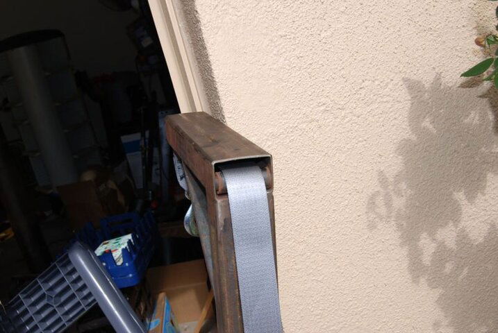

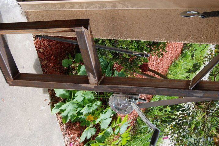

Well part of your work is done already.
Your dish has the scalar adapter for a Co-Rotor/Polarotor already installed, and you have the reed sensor magnet kit already installed, but it looks like your wheel has 10 magnets. More than half your work is already completed, unless you want to try for more magnets than you have. It makes a big difference in accuracy.
If the motor and gears work then all they need is some cleaning and a lot of grease and they will be fine.
The pole on the dish I got in Nashville had already been cut at the ground and welded once with a piece the same thickness, and it held fine for 10 years. I would suppose you could weld it to a thicker pole, but I wouldn't go down on the diameter size at all.
You can get the dimensions for the cover yourself. Just measure the top flat steel on the mount it bolts to, then measure the area needed for the flange and distance between bolt holes, the distance away from the gears etc which will match up with the flat ring around the mount in the center.
The cover needs to be split where the ring is so that it can be slipped on and off. Nice crate. :)
Looks a lot like mine. :)
That's good to hear!
How many magnets should one have for top performance and accuracy?
It's pretty nasty in there. The grease has a lot of dirt mixed in and is caked on all around. I plan on scraping and blowing out most of the grime as best as I can then grease it up with what I think is called "White Grease" if that is the best I can use?
I'm planning on going back to the Well Digging Company near me and getting another matching pole and having them welded together.
I'll follow those instructions, they were what I had already been thinking. What is bothering me is what you say of having a split in it.
If I do go ahead and go to an aluminum dealer and have them make me a cover for the gear box. Won't the split in the cover become hard to work with after a while? I don't want it to bend the wrong way or start to let in extra dirt and grime. Wonder how I could make it using Plastic as you also suggested?
Nice crate. :)
Yes it is nice, and I did follow from your photos of your crate. :)
I want to see it up and operational in a week. :D
So do I however I have to see what time frame the welder has and the well digging company has for a schedule. When I do put in the new pole in the ground…. How many feet should I separate them from the other dishes. Right now my two poles are about 11' feet apart. Should I make it further away from the others?
