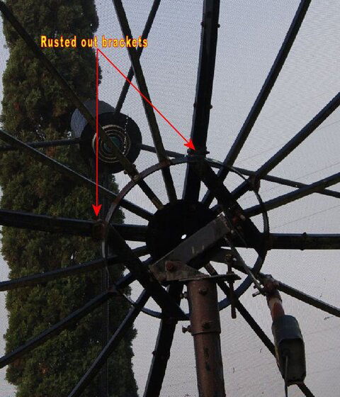

It's pretty nasty in there. The grease has a lot of dirt mixed in and is caked on all around. I plan on scraping and blowing out most of the grime as best as I can then grease it up with what I think is called "White Grease" if that is the best I can use?
You could douse it with some solvent and scrub it with a small brush, but you would have to grease it well when finished. I use White Lithium Grease. Comes in a spray can or you can get it solid.
I'll follow those instructions, they were what I had already been thinking. What is bothering me is what you say of having a split in it.
The split is for using plastic so that you can take it off the mount. If using aluminum just have them make a screw on section maybe with a hinge, so you can slip it on and then put on the closing section.

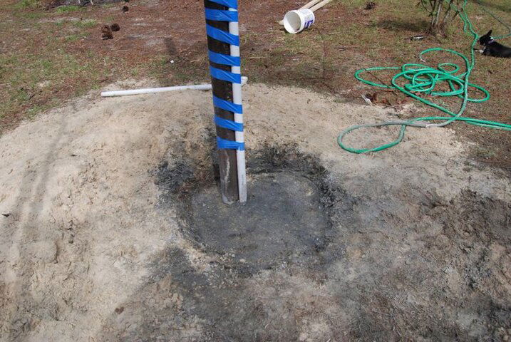

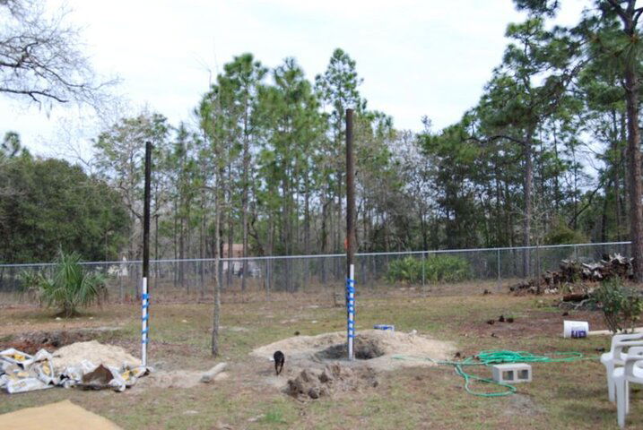

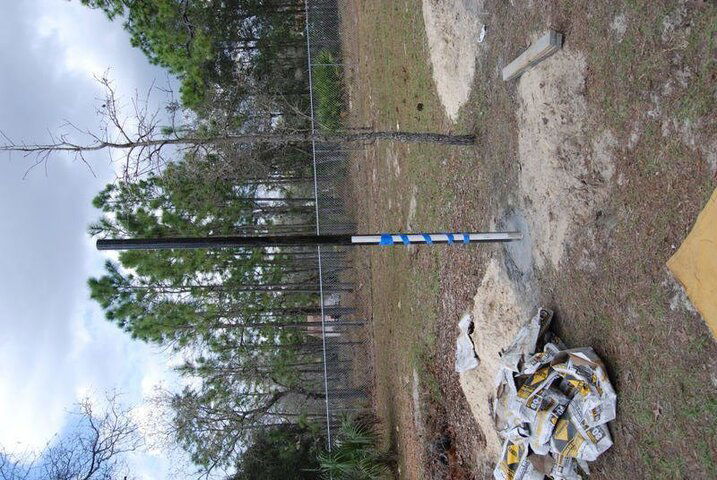

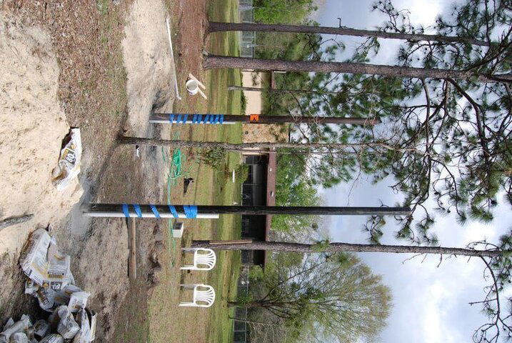

Right now my two poles are about 11' feet apart.
My BUDs are all at least 25 feet apart so they don't interfere with each other.
