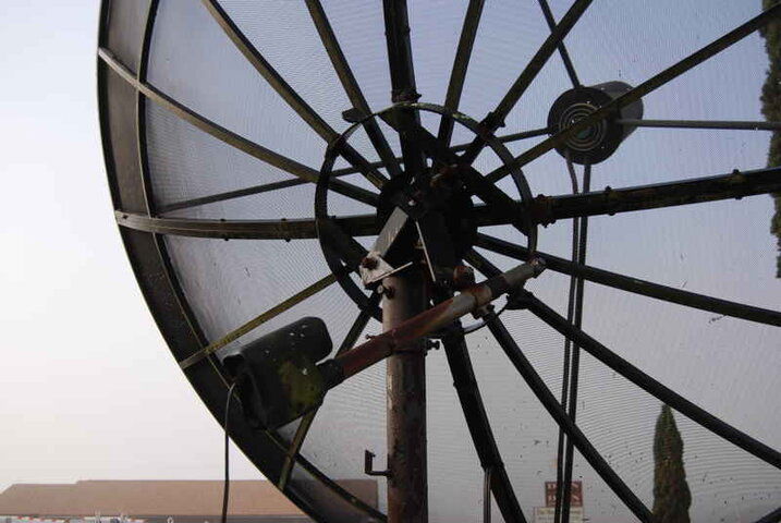

Thanks for the info 14karat! I was real happy just to see it move! Did turn it back to the starting position that it was in to begin with and di a re test just to see if it would move again. It did so I put it away. Went to Home Depot and got a bunch of stainless steel bolts, nuts and washers to replace the rusty and old bolts and would you believe it>>>> I forgot to get the emory cloth! So maybe I'm showing my age!
I'm thankful for your advise about testing it too much. I don't want it to get damaged like you stated in your post. Just going to leave it alone except maybe painting it where there is rust with a non meltalic paint Just as long as painting it won't cause problems??

Yes. If the actuator arm is not mounted, it will just turn with the motor.
Problem with doing that tho'... if you run the motor with the arm loose OR if you turn the arm by hand, the limit switches will then be off.
You will definitely want to get that straight before you mount the actuator.
If the arm is too far extended, it could come completely out and drop the dish.
Too far in and it could cause a lock up and damage the motor.
The way I've done this in the past is to run the motor all the way in (in my case that has always the westward movement) until the limit switch stops the motor, thread the arm in by hand all the way in until it stops - then back off a turn or two.
Of course I then mount the arm and run it all the way east and make certain that the other limit switch catches before it drops the dish!
