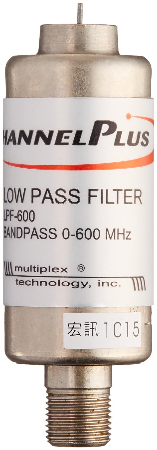

Well, with everything beyond RF36 being cut for tv stations, IF you aren't going to have any channels higher than RF35 in your area, we can use these for LTE filters on our tv antenna systems. They don't pass anything above 600mHz:
Amazon product ASIN B00006JPE6
