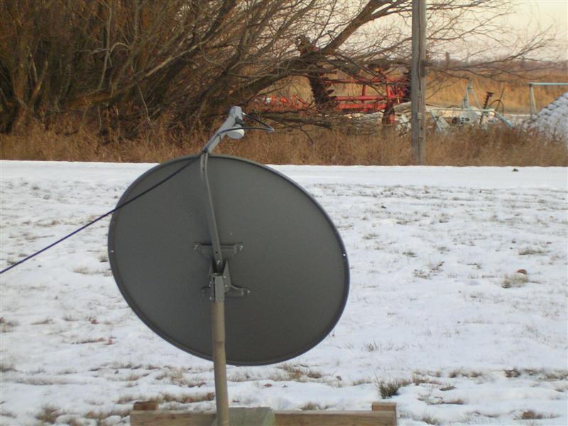

Attached are pictures of my 60cm Channel Master dish adjusted at 30.0W Hispasat. Receiving 55 channels on 10 transponders with the signal quality ranging from 69 to 76. Cubavision has a signal quality of 72.
The first photo is the view directly in front of the dish.

Can you believe between 70 and 75? Perhaps with the dish inverted you adjust the elevation 21 degrees in the opposite direction? When I had the elevation adjusted yesterday to 45 degrees (24 offset of dish + 21 Hispasat elevation) I spent hours and received nothing.
This morning I decided to raise the elevation as you and others suggested and I received the CNN signal within minutes. I then turned the dish and received Hispasat shortly after and then adjusted the azimuth, elevation and LNBF skew for the highest signal quality.
I currently have the skew markings on the LNBF facing towards the top of the dish to prevent water from entering the coax. I believe the H transponders I received are V and the V are H. This is probably because I turned the LNBF 40 degrees in the wrong direction and / or because the skew markings are facing towards the top of the dish. As long as I'm receiving Cubavision I don't really care for now until I get time to correct.

I want to better understand the elevation of an inverted dish. I currently have the dish aligned to receive Hispasat which in my area has a 21 degree elevation. If the dish was installed normally the elevation scale on the mount would be adjusted to 21 degrees. With the dish inverted I first read that you set the elevation to the offset of the dish (24 degrees) + the satellite elevation (21 degrees) which is 45 degrees. With the elevation scale on the mount adjusted to 45 degrees I received nothing.
I also read that you double the offset of the dish (24 + 24 = 48 degrees) and subtract the satellite offset (21 degrees) which would be 27 degrees. My elevation scale on my dish is currently set to roughly 73 degrees to receive Hispasat. Why 73 degrees? I'm thinking perhaps you adjust the elevation scale to be 27 degrees from the bottom of the scale (100 degrees) which would put you at the 73 degree mark the dish is currently set at.
If my dish was installed normally and set to 21 degrees it would be facing directly at some trees, but set to 73 degrees it is aimed way above the tree line. I know the satellite position doesn't move, so does it hit a different area of the dish if the dish is inverted?
Now that I think about it I placed my angle locator onto the front of the dish and adjusted to 45 degrees which enabled me to receive Hispasat. So the answer is you probably go by the angle locator on the front of the dish rather than the elevation scale on the mount to determine the correct elevation.

In theory, an inverted dish angle would be calculated by adding the satellite elevation angle with the offset angle. This sum would be adjustment reading of the vertical plane angle on the face of the dish. If you wanted to aim at 21 degrees above the horizon with an inverted 24 degree offset dish, set the dish face angle to 45 degrees (21 + 24 = 45 degrees).
If you wish to use the elevation scale on the back of the dish, add the 24 degree offset to this calculation. (45 + 24 = 69 degrees).
