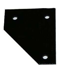

The distance between the actuator mounting points are much closer on the 10Ft CM dish than the old 7.5 KTI dish.So it was pushing at a sharp angle and binding @ only 30 degrees east of zenith.I made an actuator plate yesterday out of a rectangular steel plate the salvage yard gave me.Similar to what sells online for a crazy price.Total price = <one hour to saw off a corner,drill 3 holes,and mount.(Oh...I forgot the time spent searching the scrap yard..but that's pleasure.lol) Retail version pic here:
It brought the actuator out 3 or 4 inches.Gives me more clearance when driving the dish to the east.I'm scared to push the old,stripped actuator much further,but I see that there is now room to travel.I plan to make a larger plate out of thicker steel later,but this one is good for testing.Also plan to put an extension out from the mounting ring and see what that gains me.
