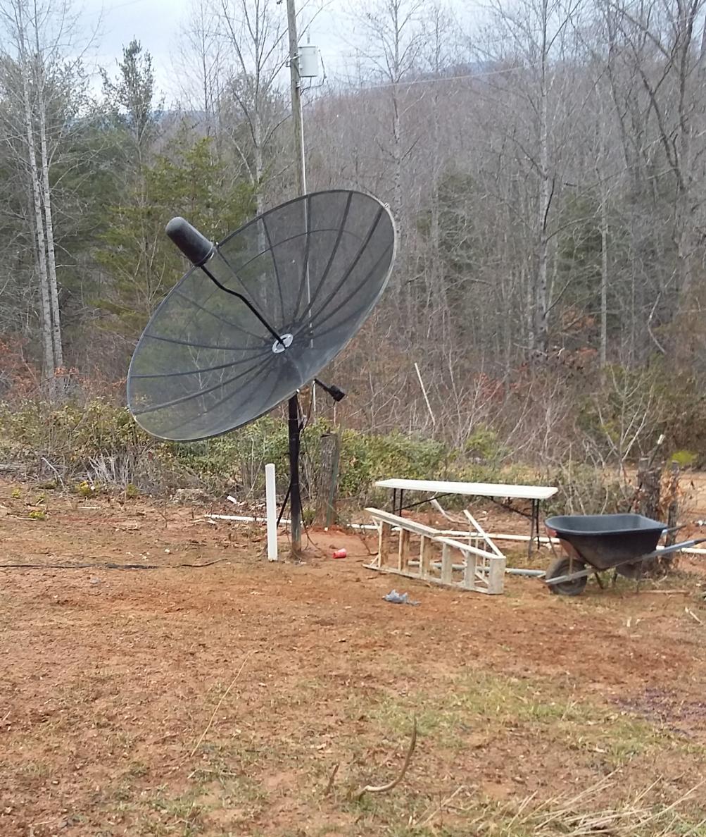

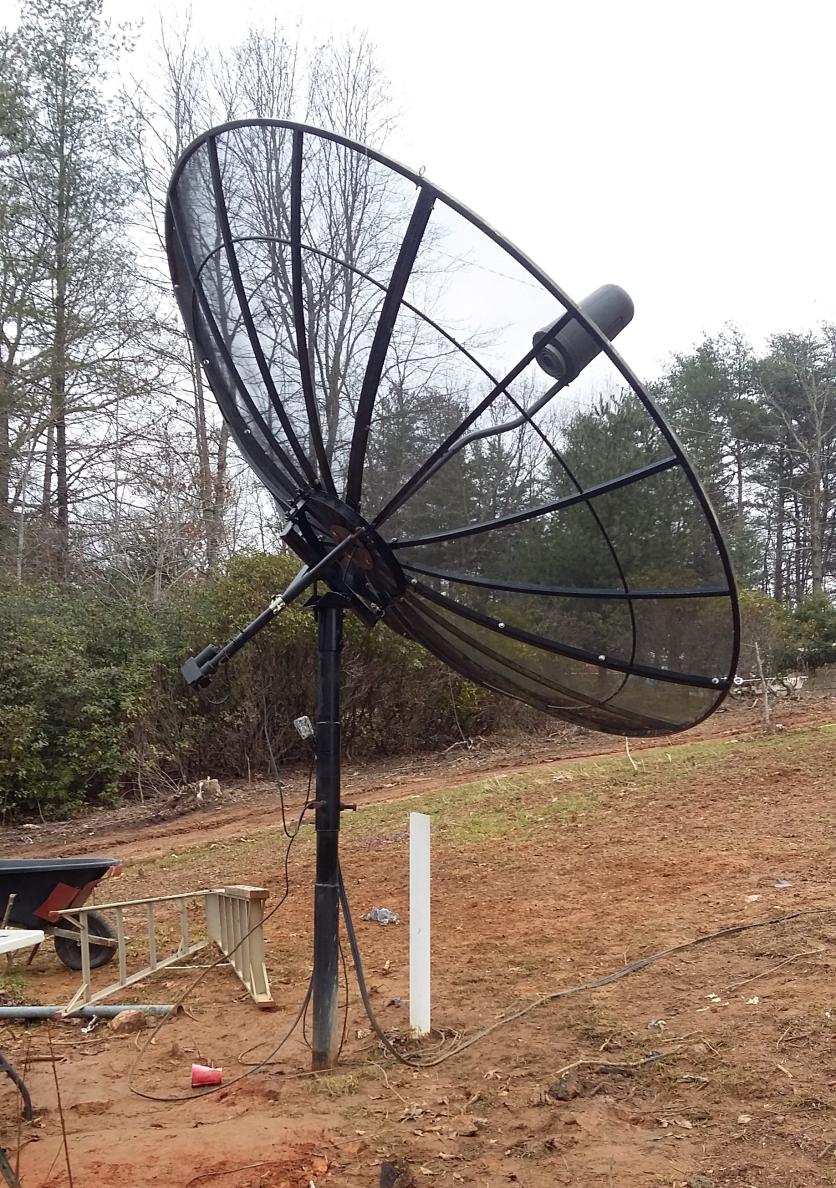

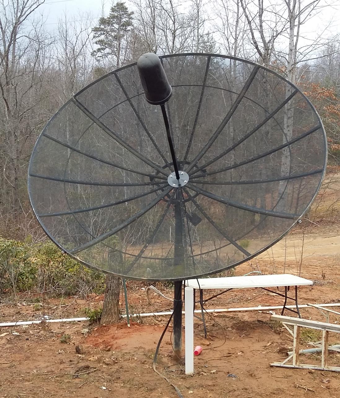

I got down to the dish this morning.Adjusted the true south better and reset the actuator bracket to travel more to the west.Elevation is spot on,but declination is still sketchy.Will need to place a board on front of dish to get an accurate dec reading since there is no good place on the back side.Dish pointed more or less toward 90W-95W in pics.Ugly places on dish are mud,not missing paint.It's now pouring down rain...grrrrrr.Six foot table and ladder give size reference. Wheel barrow is what I set the dish on to get enough height to bolt up.Still plenty of height for a future 12 footer. ;)

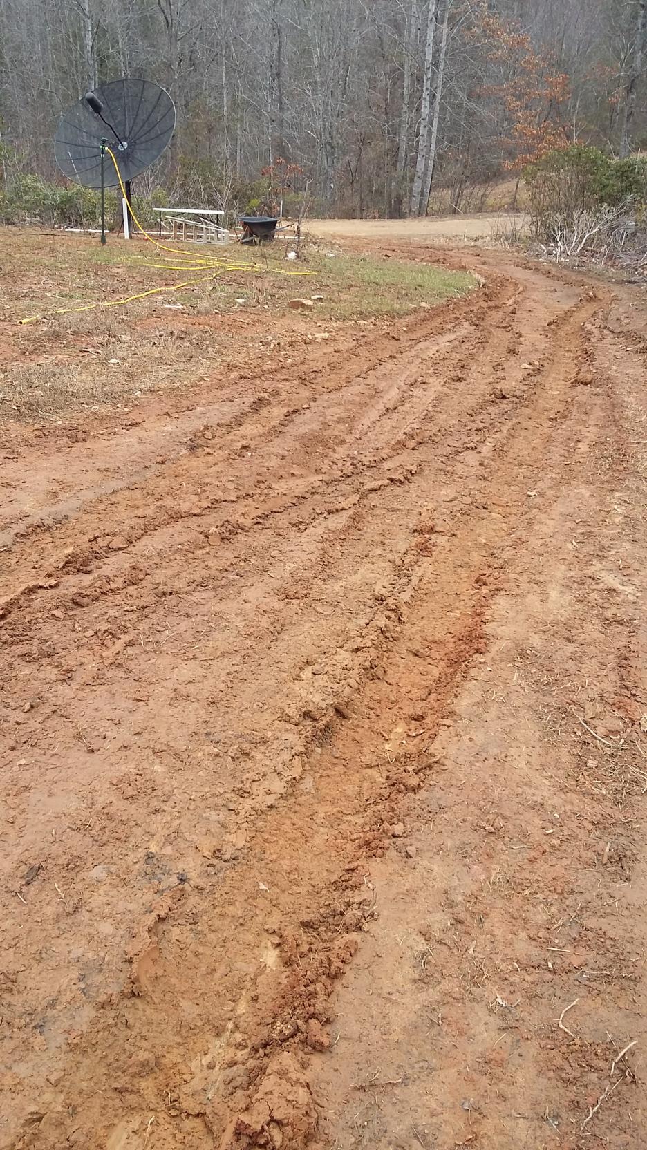

First pic shows the muddy driveway and what I've been dealing with.

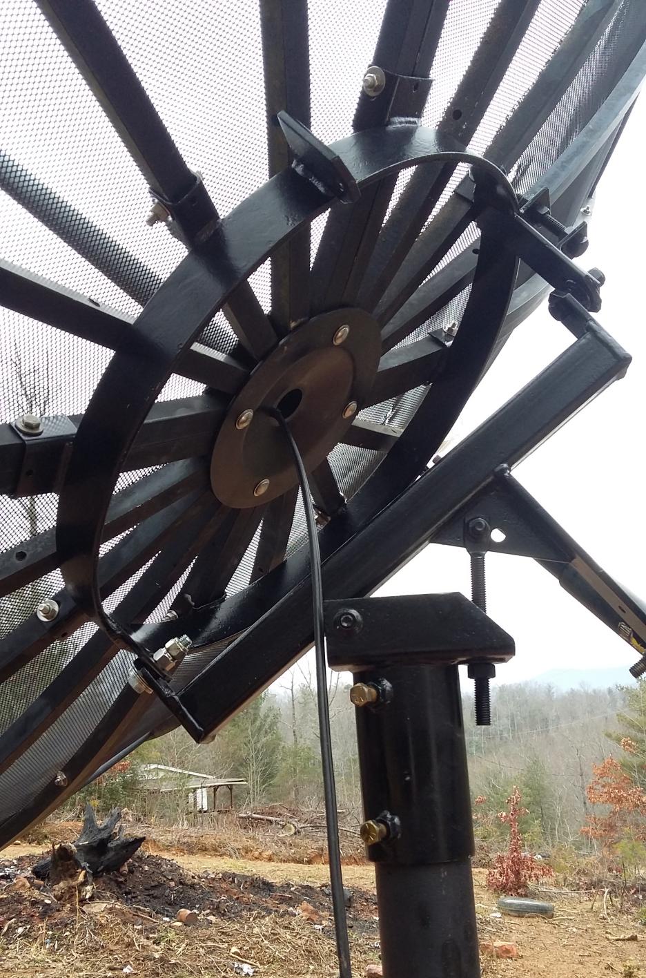

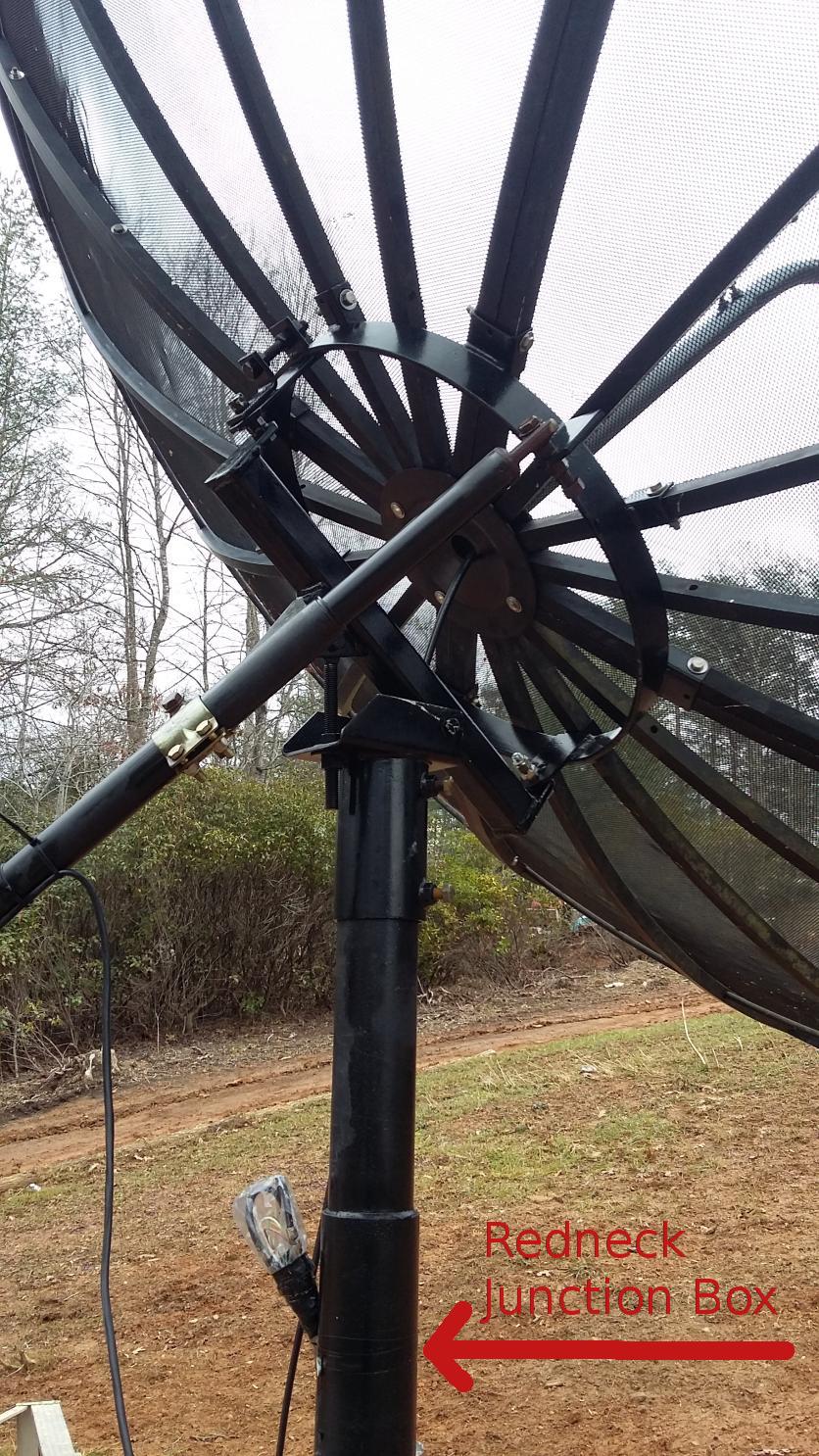

Second pic: Red arrow shows two small puncture holes I made while mounting the dish.Ring bracket poked through.Ooops! Flattened them out and will stitch them up later.Green arrow shows shortness of original declination bolt...the nut does not even thread all the way! I meant to put a longer bolt in before mounting but I forget in my haste to beat the monsoon.lol.It's a wonder the dish didn't flop over years ago.I'll fix that when I have some help to hold the dish.
Remainder of pics show different angles of view.BTW....How do ya like my hi-tech junction box made from a heavy duty plastic bag and electrical tape?
