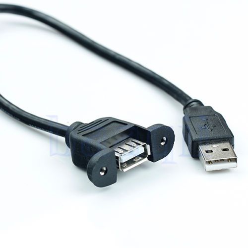

Also found this if you want to turn the internal into an external by removing the 9 pin serial, and replacing with this: USB 2.0 A Male to A Female Socket Panel Mount Adapter

Also found this if you want to turn the internal into an external by removing the 9 pin serial, and replacing with this: USB 2.0 A Male to A Female Socket Panel Mount AdapterView attachment 111552
I don't see a problem with doing that but I wonder if the vendor would void your warranty for doing so. I would imagine that it won't cause problems but it could void the warranty, at the vendors discretion of course. You're "safe" as long as nothing goes wrong with the product during the warranty period.
No voiding warranty unless the board is damaged.
That would be a question to ask the vendor, but my post was liked by SatelliteAV, so I'm assuming he liked the idea, I know I was told it was OK to open and remove the internal USB drive, so this really isn't much different, you're not really modifying anything, just adding an extension to the USB port for easier access.
We do not void the warranty unless there is a damage to the main board. and yes i did like your idea, apparently.
