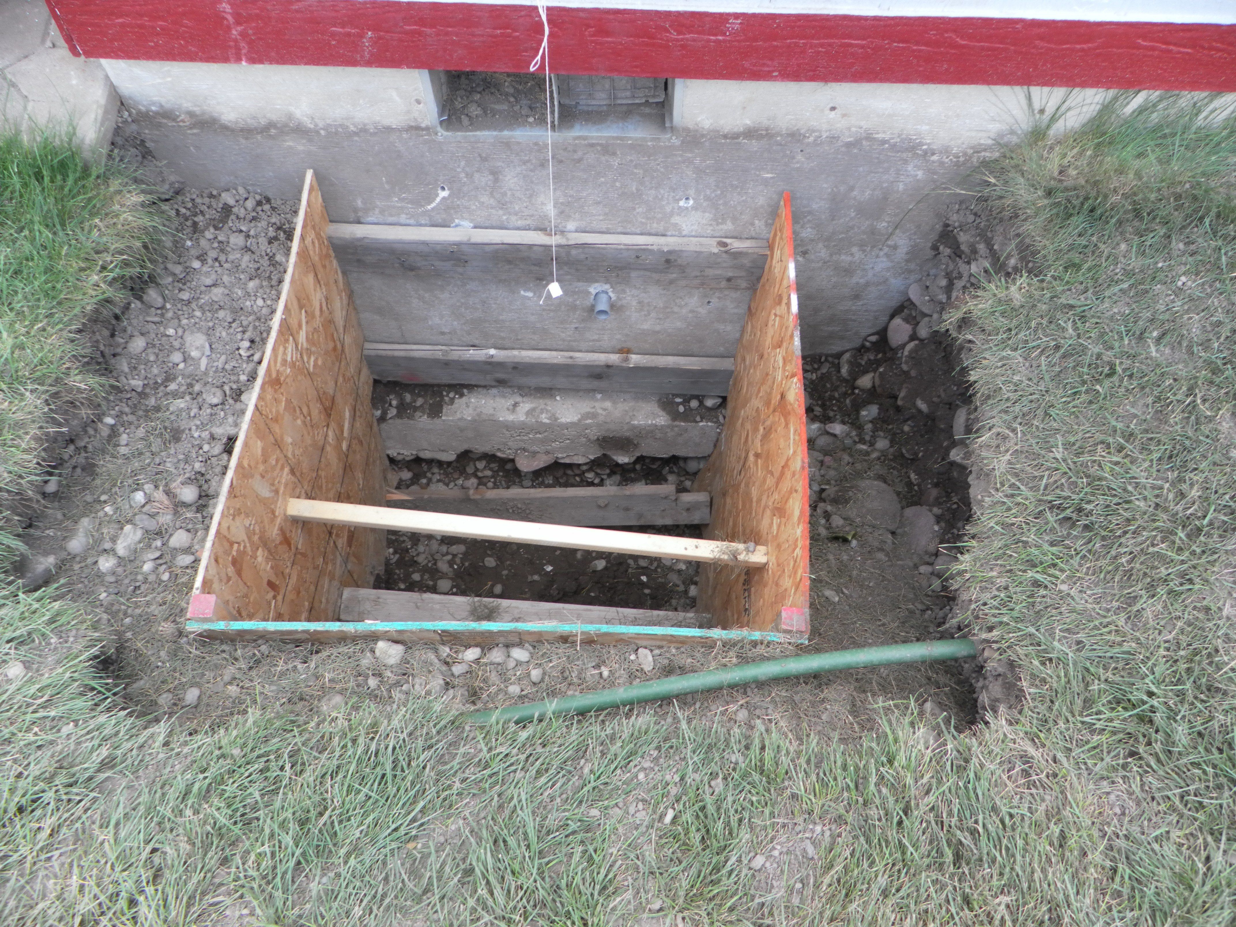

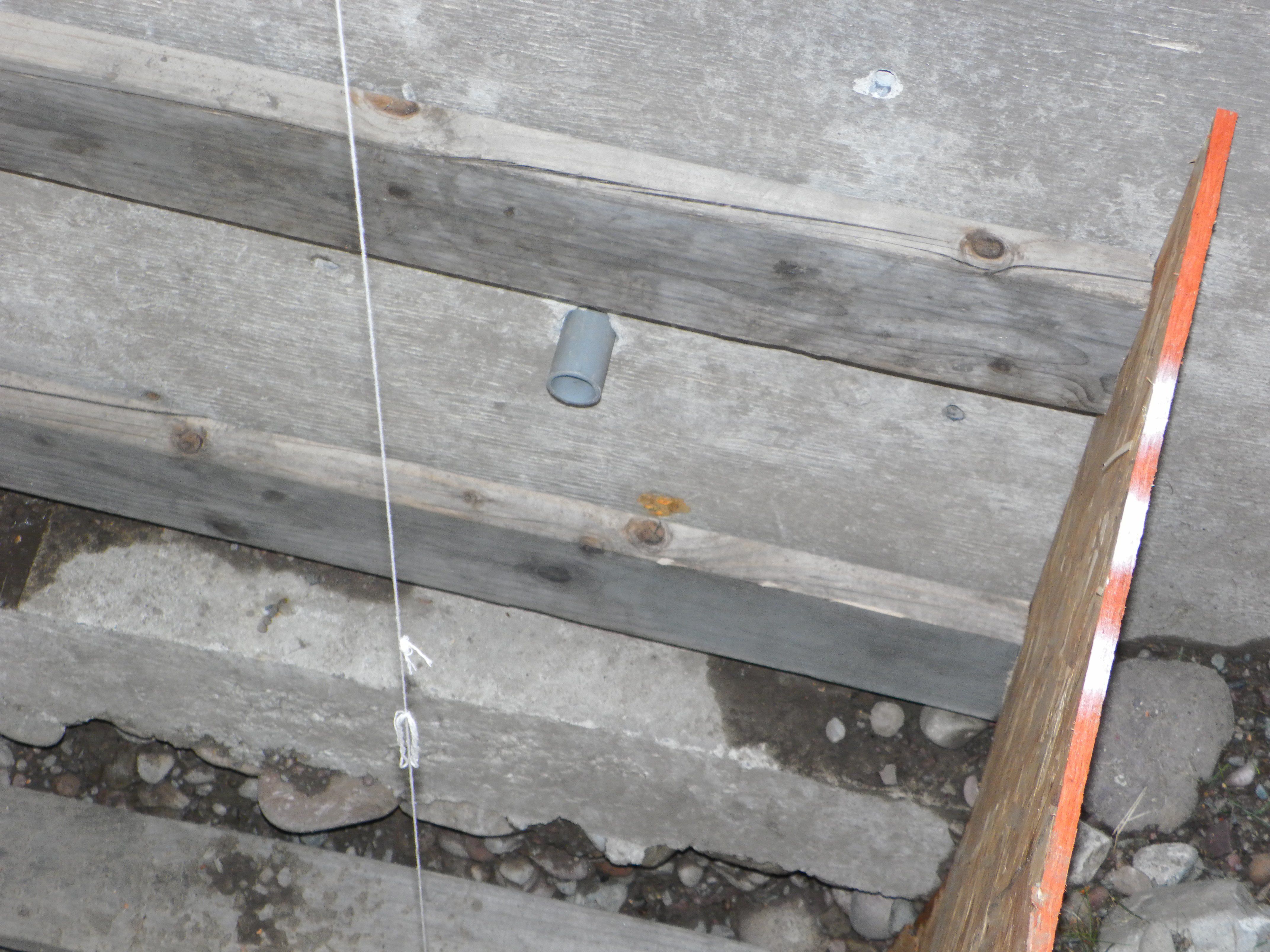

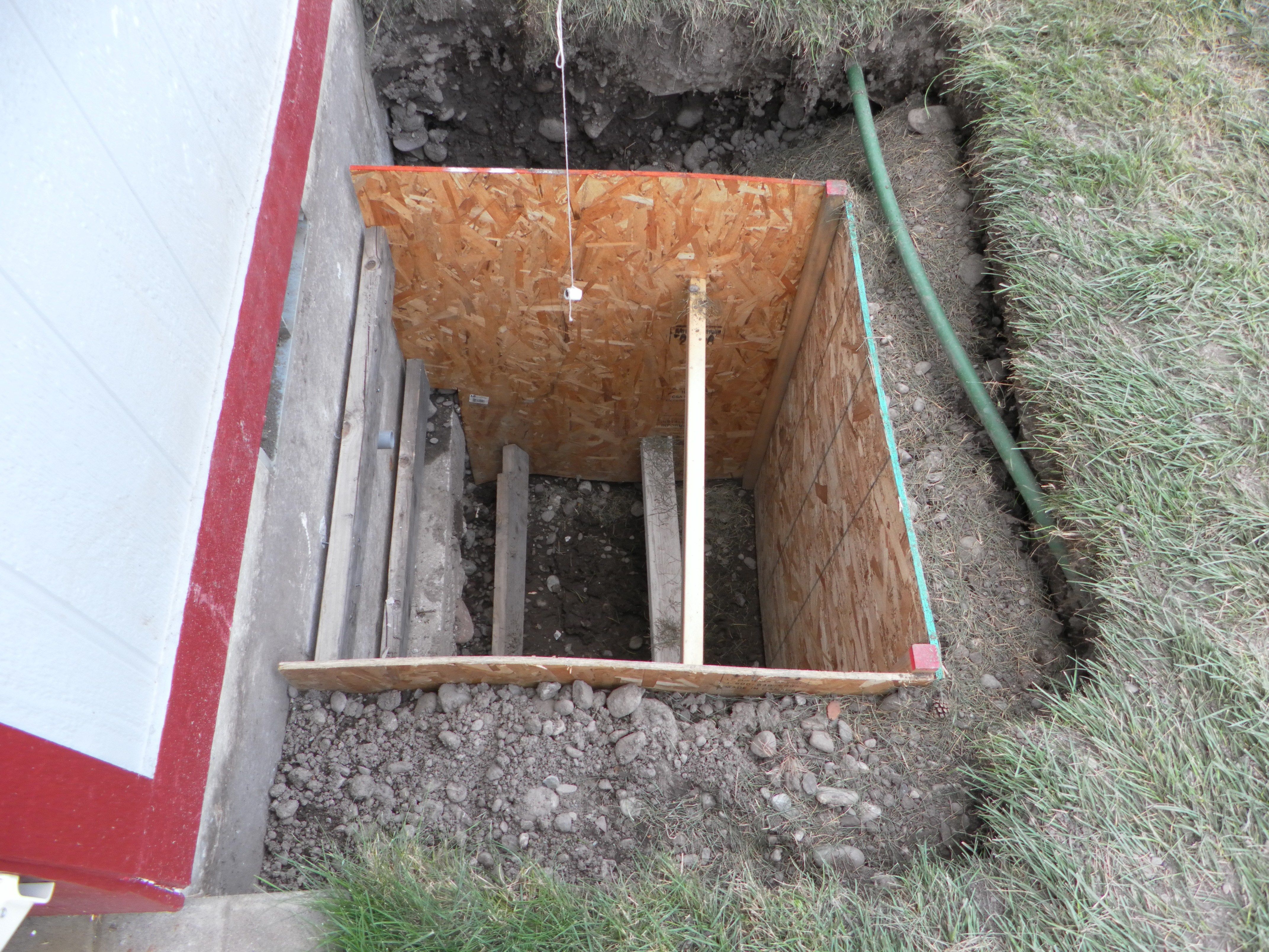

TheBox 004.JPGTheBox 012.JPGTheBox 011.JPGOK now there is a box in the ground.
I'll stick the pole in there and then the rebar structure. I ordered all the rebar precut only $17. The foundation wall was drilled for the conduit run from the pole and the conduit in place waiting to be glued to the pole. Then comes the concrete. Trying to avoid some hefty load fees, I'm gettin a couple yards tacked on to a local contractors daily run. Won't be for a week though.
