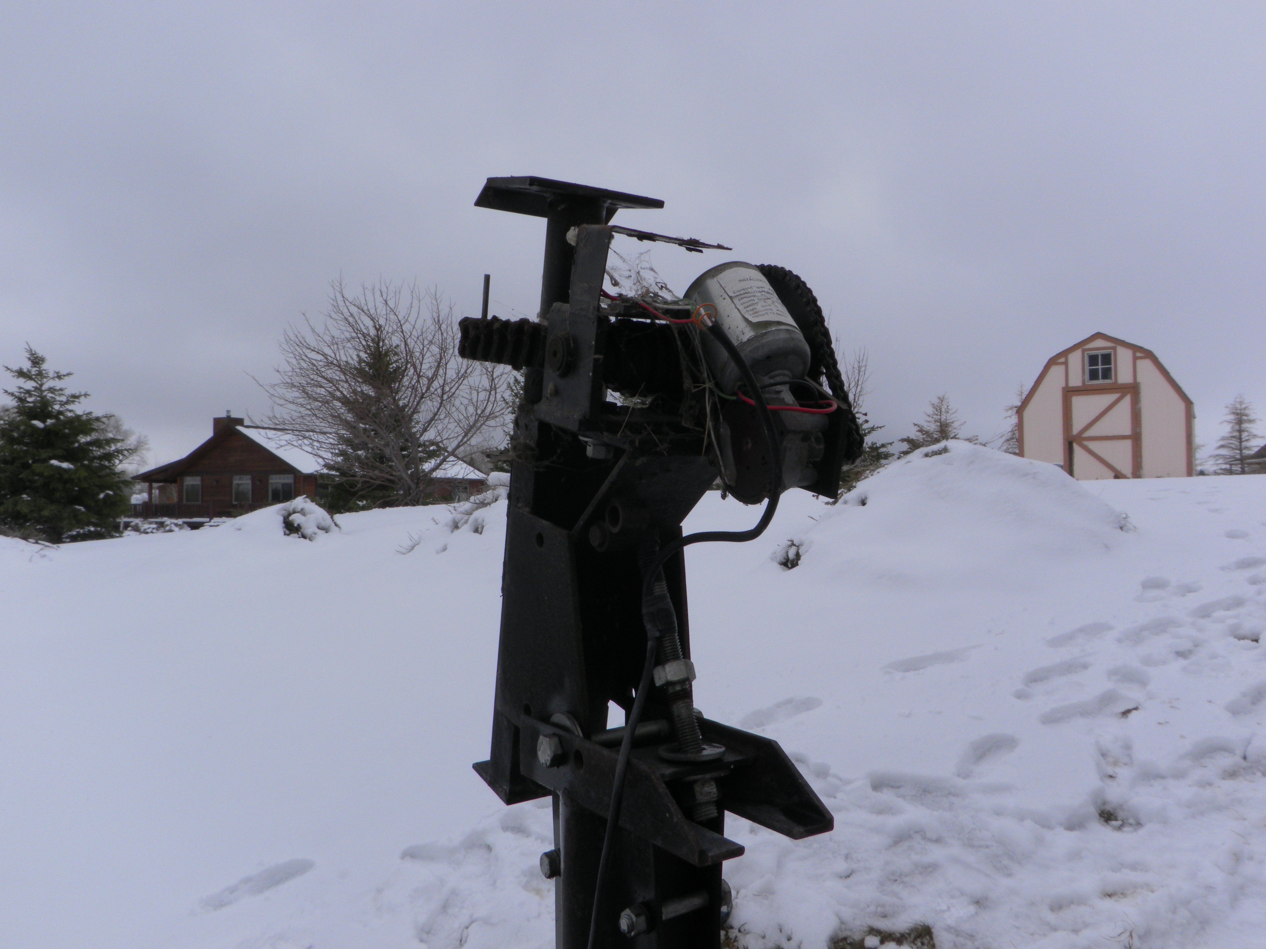

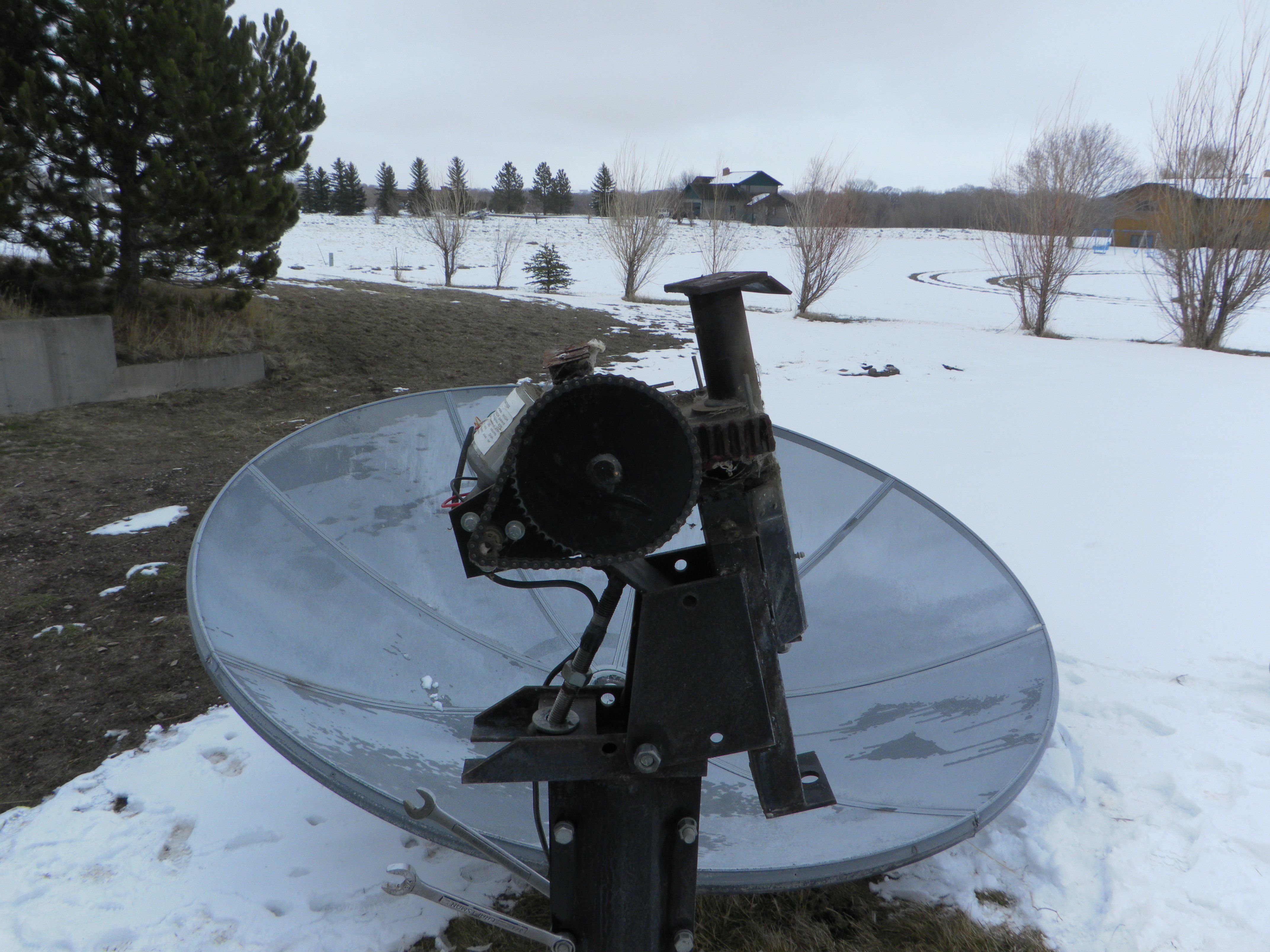

The panels are super stiff for sure. The hitch in removing the mount from the pole was a rollpin. They had drilled thru the mount and pole after it was aimed and pinned it. Fortunately for me the pole was not full of concrete and I just knocked it thru. I googled the Ajak mount and found the manual right on this site. (naturally) When I disassembled the mount I didn't see the declination ajustment, but now I do. No fine tuning that. Just set and go! It's a nice deep dish also. should give me good signal seperation. But now that I got greedy and grabbed it all I got to do now is figure where to install it.

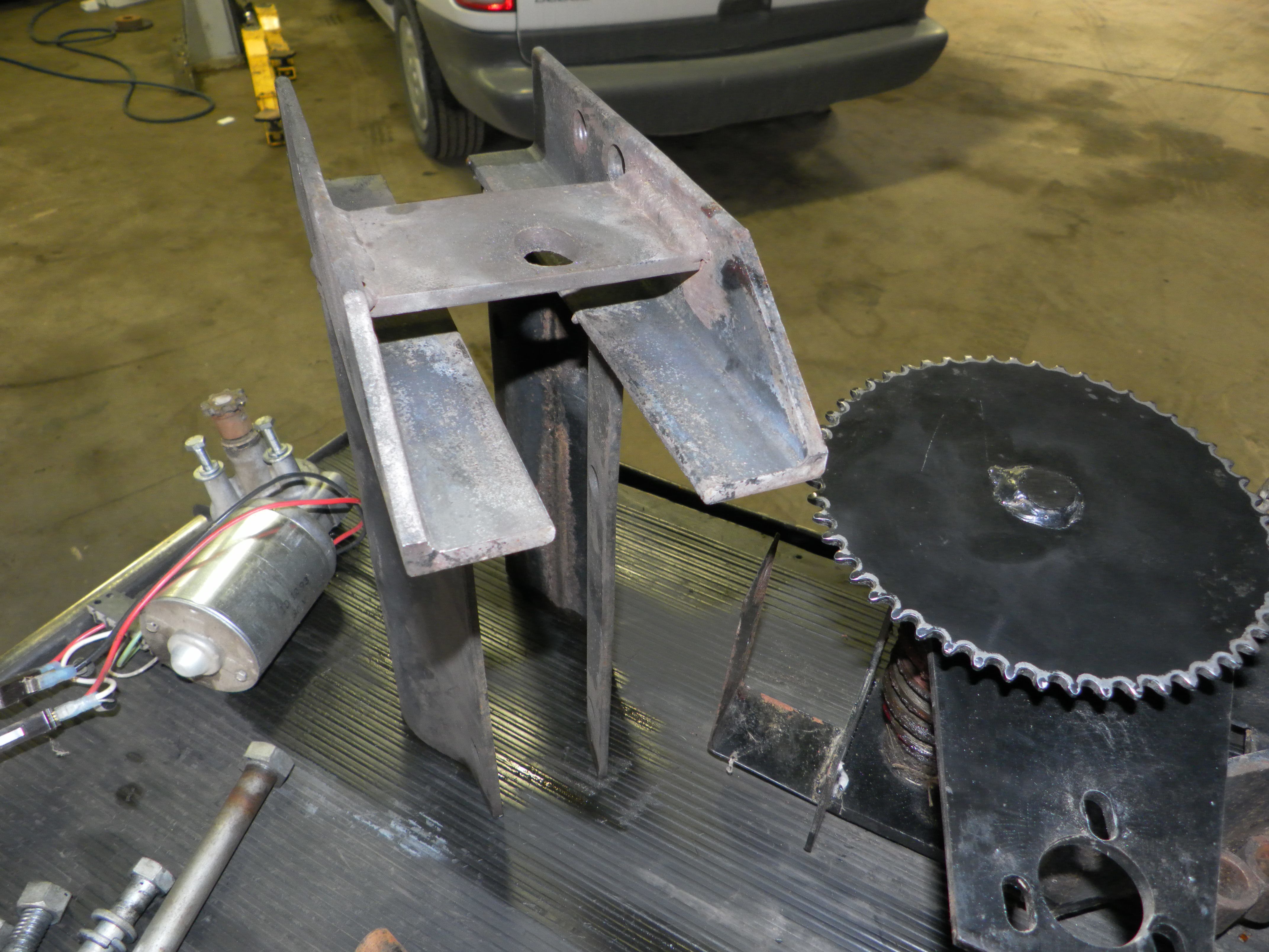

I've disassembled the Ajak. OMG!! Looks like this thing lost a hatchet fight. It definately was up against a gorilla for an installer. Though I suspect that the manufacturing process may leave something to be desired. The main rotating shaft is a pipe that has been machined to a smaller size. This (smooth) surface was full of strike marks wich left severe scoring in the bushing material. The grease zerk for the main shaft looks to have been drilled and installed after the fact. You can see where the drill bit hit the main shaft. The pole clamp doesn't fit the motor. It was "moused" together and the Elevation angle pivot bolt wich should be very tight and not move was worn deeply. The distortion of the metal in the clamp leads me to believe this thing was barely on arc. I will remake the clamp to fit if I come up with a pole for it. I'm looking for a pole and will adapt the motor to what ever pole I find to use. I have polished the shaft and cleaned and reassembled the motor. It should be good to go now.

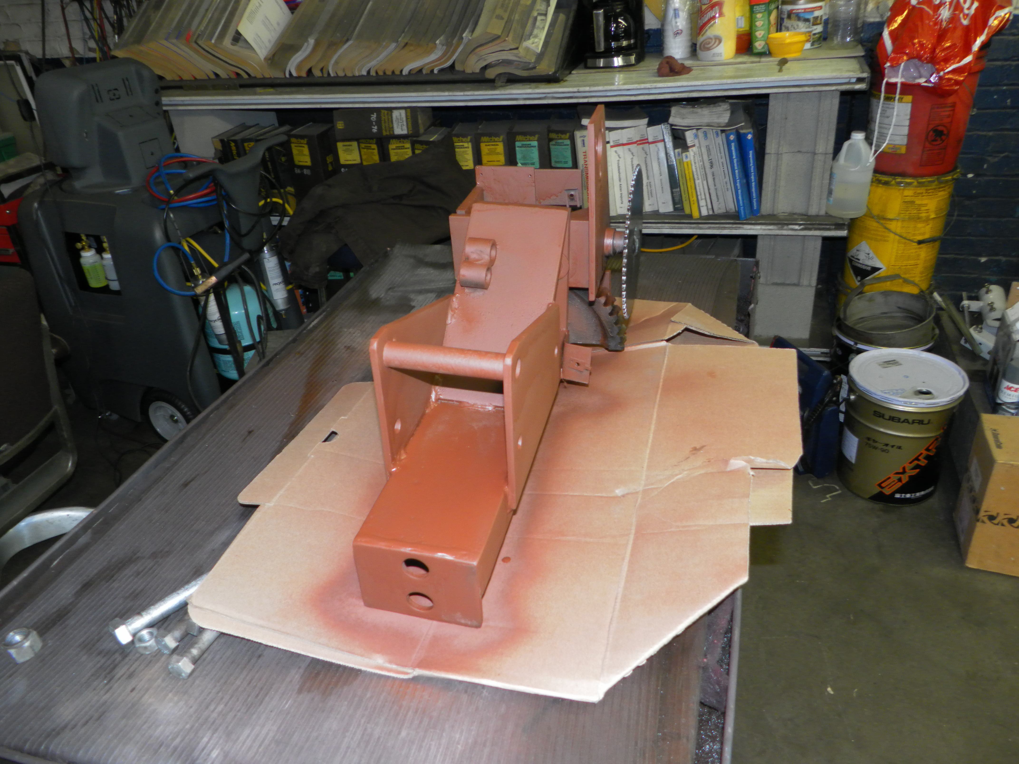

AJAK is ready
Some derusting and a couple coats of rustoleom later.

Most guys would probably do a grease it 'n go, and it'd likely last another 20 years just fine.
Looks like you did more of a full factory rebuild.
Your grand kids will still be using it, if we have C-band that long! - :cool:

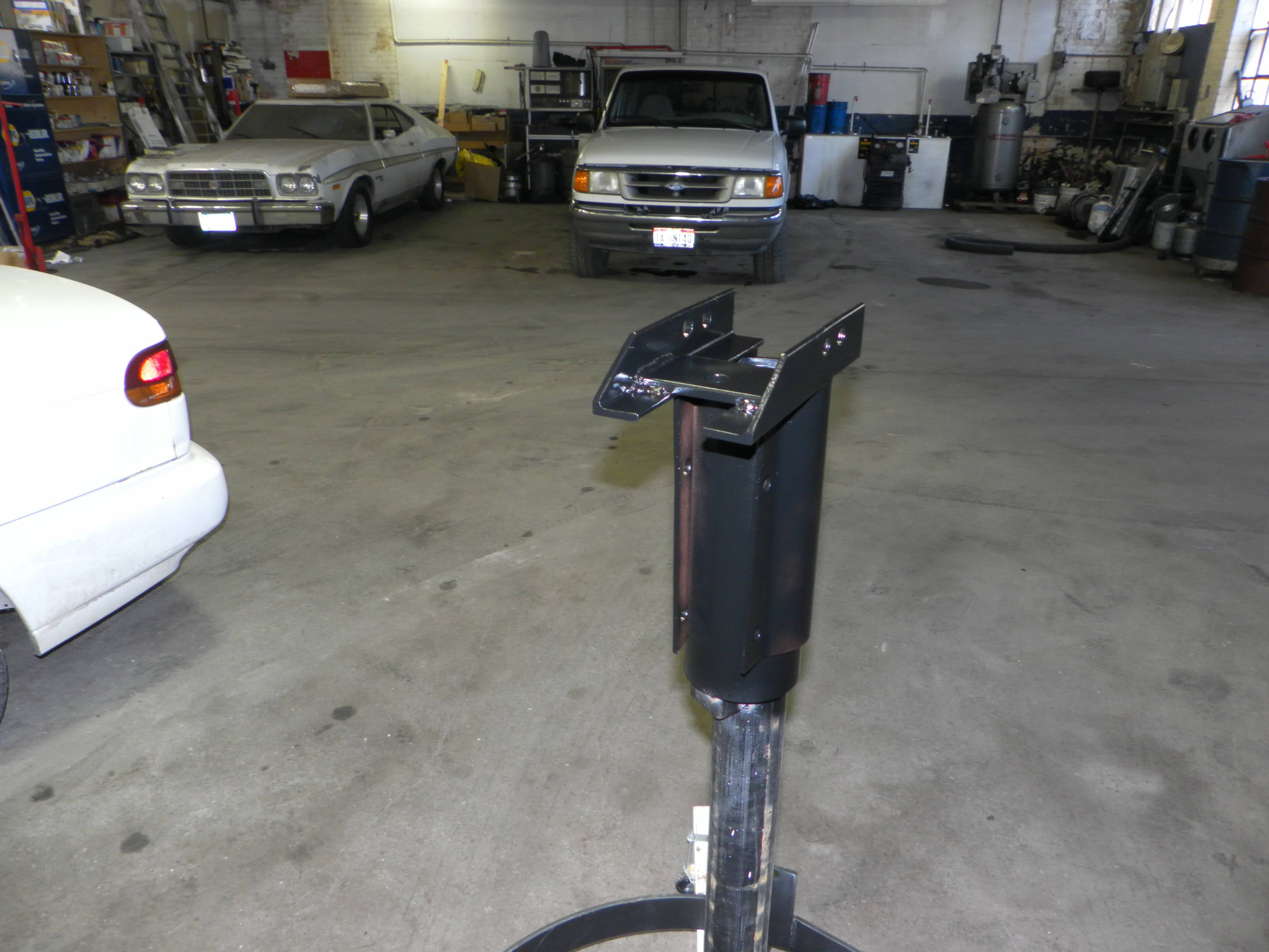

I guess it was a bit more than painting it. The original location had it mounted on a smaller pole than it should be. They had replaced the strap on the clamp where the elevation screw goes to allow the smaller pole. This made it impossible to attach the motor correctly and you could not tighten that bolt properly
I cut out that strap and put in my pwn so I could attach the motor and put it on a 4 1/2" pole.
I put in a crossmember in the motor so you can now tighten the bolt properly.

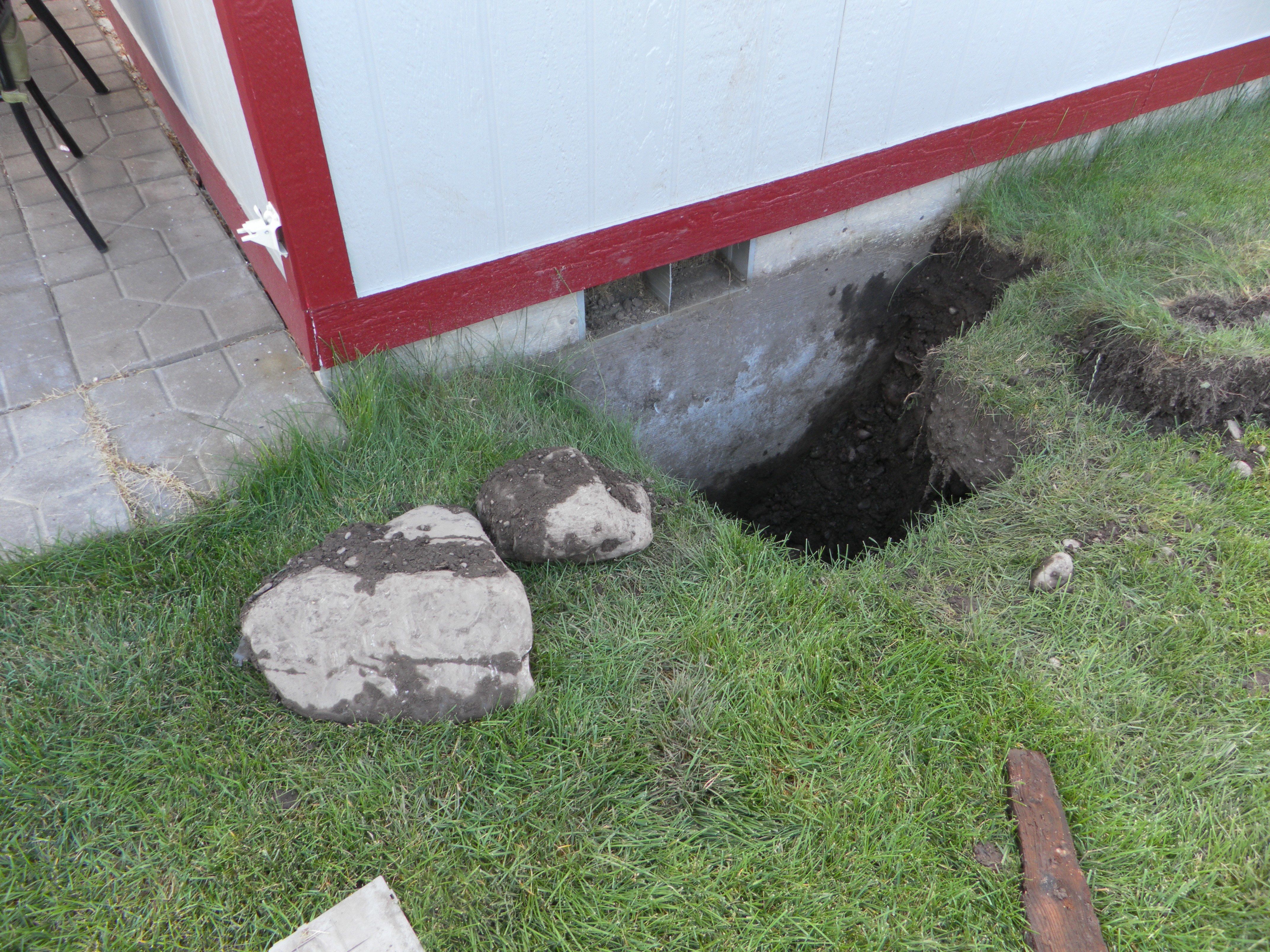

I am really bummed. I've have spend too many hours and hundreds of dollars trying to get this dish up and running. The weather has fought me for 8 months. Just today I'm ready to set the pole in the hole that took forever to dig and the biggest rocks OMG!! Beauitiful day and all of a sudden thunderstorm like you never saw. And rain! musta dumped inches in less than an hour. Washed the hole nearly shut. Theres a 10 foot crater in the yard around what is left of the hole. Gonna take some effort to fix this mess. Ruined the whole project. We have had so much rain this year. I never seen the likes of it. And the weather guys never forcast this stuff. We were suppossed to have a great weekend. Well somebody somewhere is but not me.

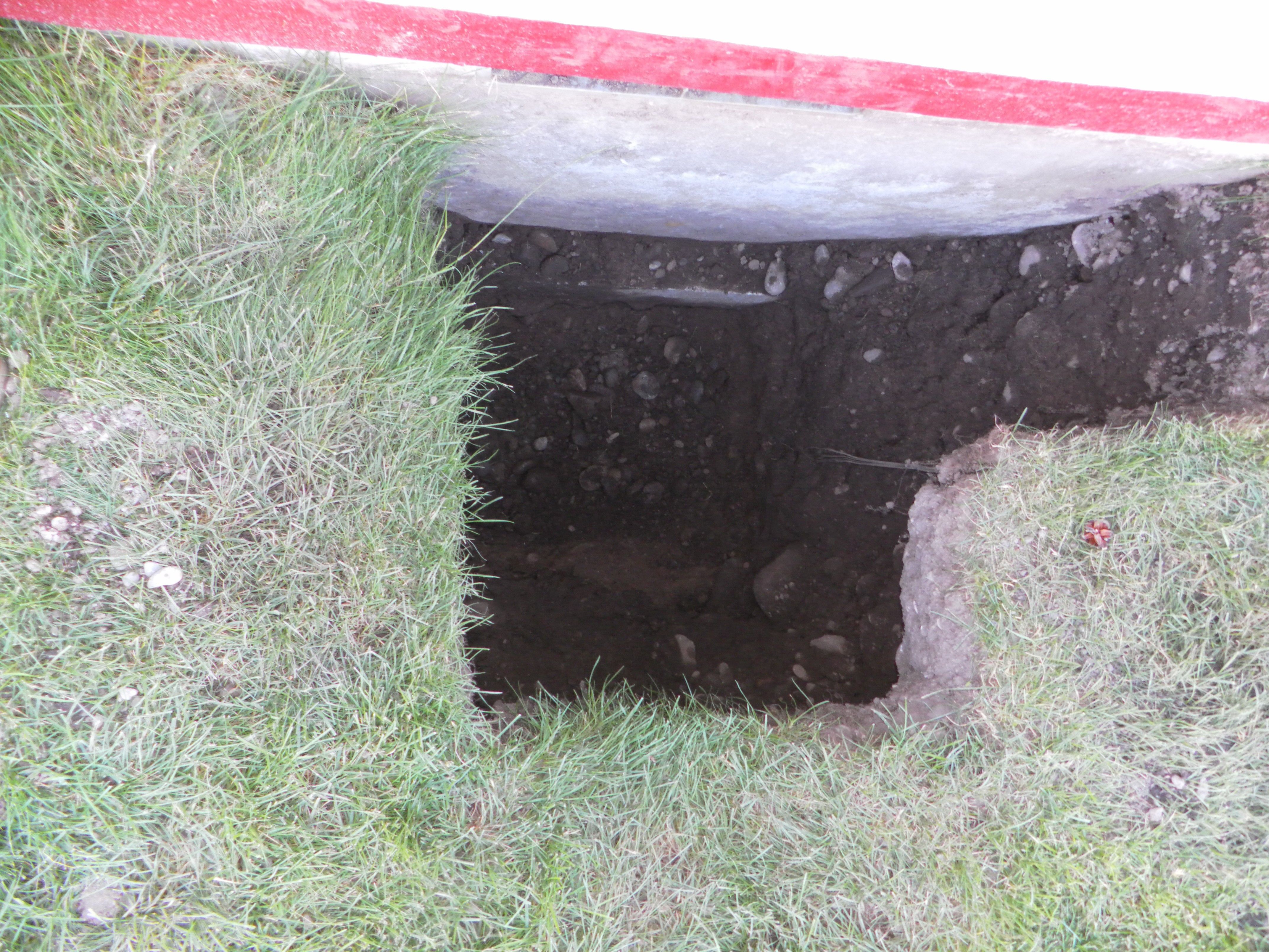

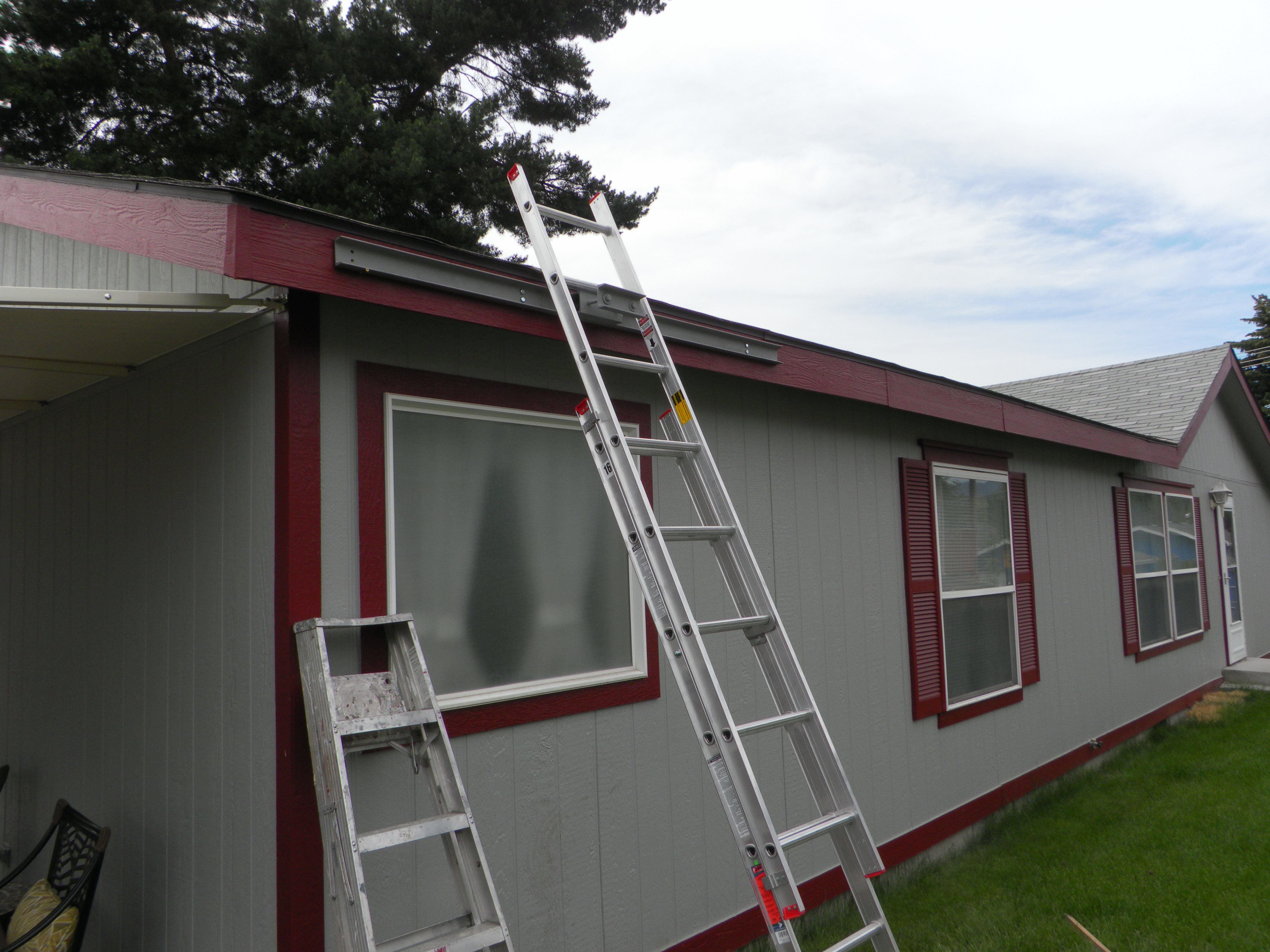

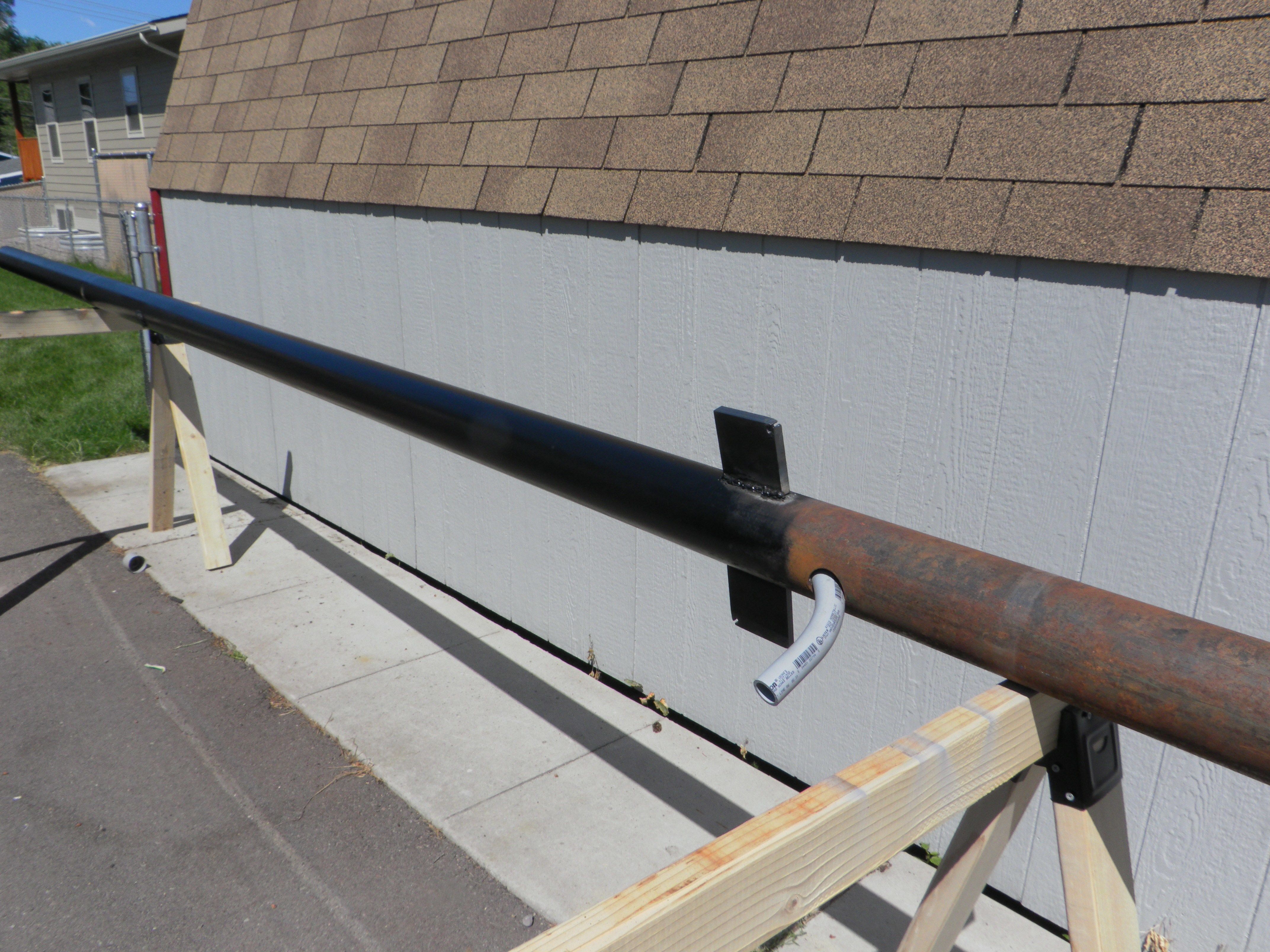

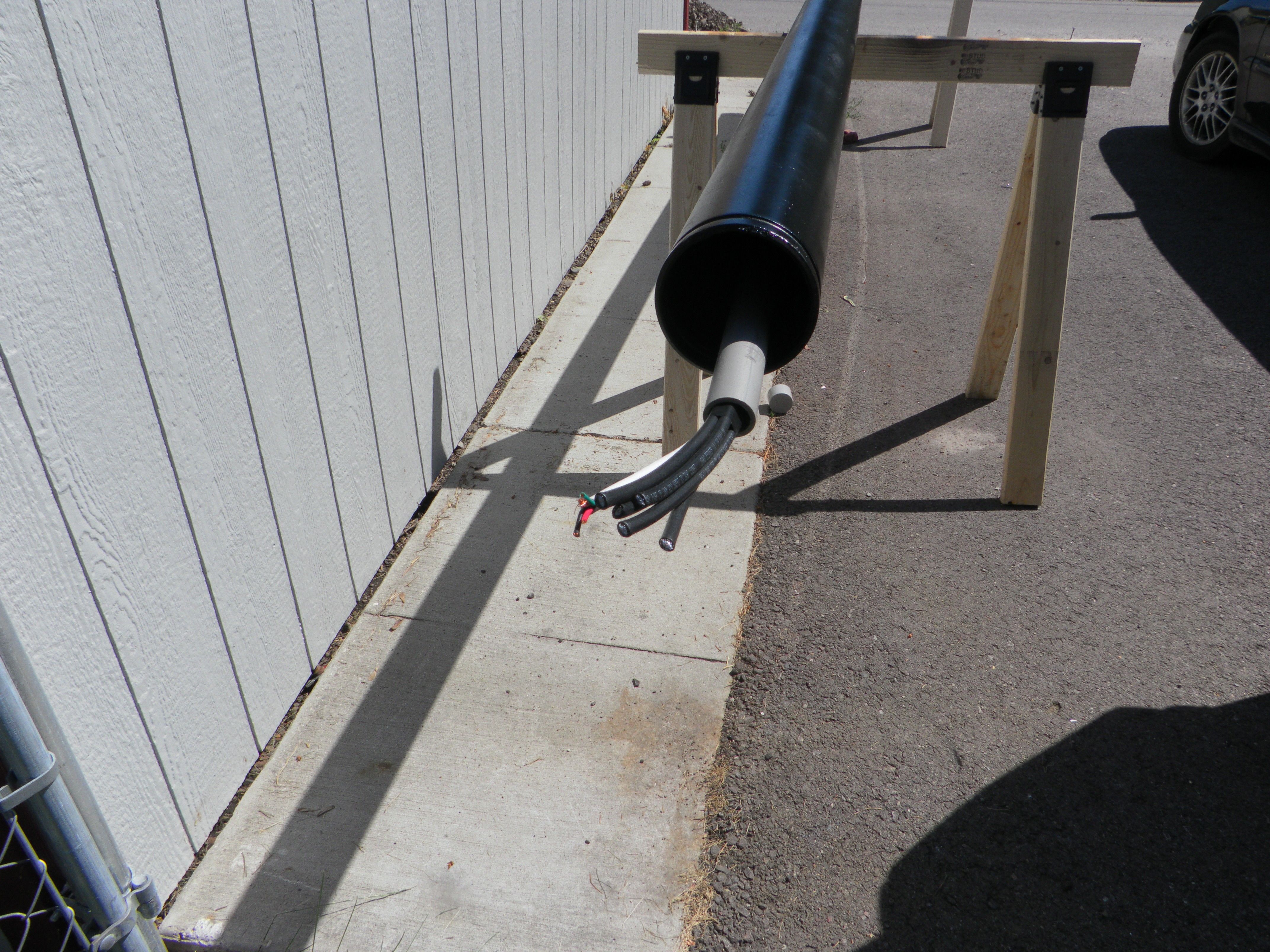

PoleCrazy 007.JPGPoleCrazy 001.JPGPoleCrazy 046.JPGPoleCrazy 053.JPGIt occurs to me that the mounting pole I'm putting up is going to be the most expensive and difficult part of this dish install. 14' above ground. I also plan to run all cableing through a 1" rigid non-metallic conduit inside the pole. The conduit will route through the foundation wall into the crawlspace under the house. I made a pole clamp to fasten it to four rafters on the house. The clamp is held with 8 3/8" lag screws 4" long.PoleCrazy 038.JPG

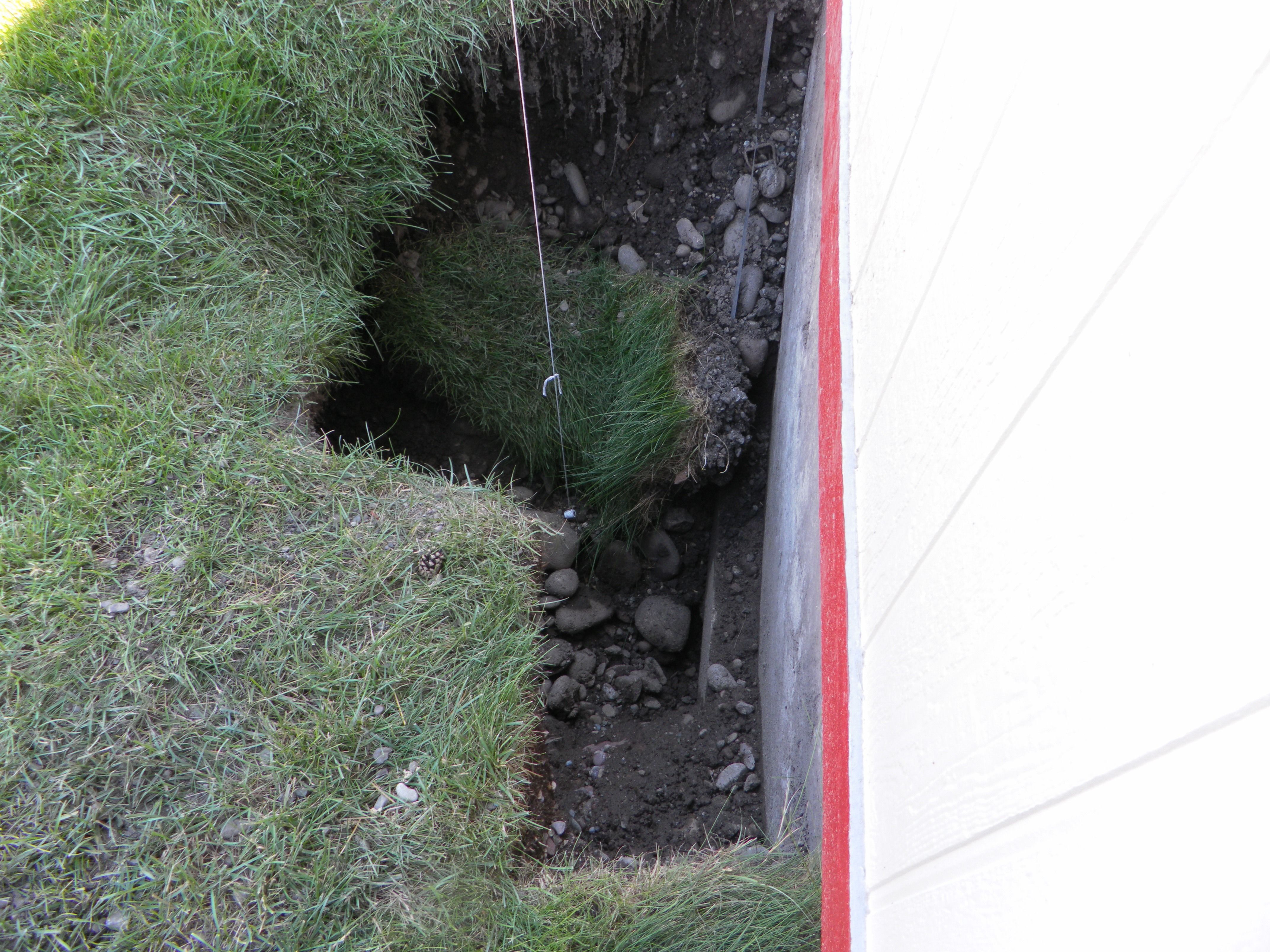

Unfortunately the hole has been a great headache. A huge amount of labor involved. And the weather has ruined it and essentially made me change the whole plan for the pole mount. I will now need to build a form for the concrete pole base.
