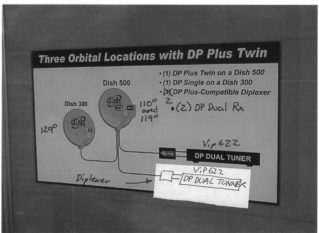

I'm in a Seattle suburb and would like to set up a dual ViP622 configuration. I can't see 129 and 110/119 from the same dish location but I could put up two dishes. Can I point a "DP Plus Twin on a Dish 500" at 110/119 and a "DP Single on a Dish 300" at 129? Then connect the DP Single" to the "DP Plus Twin" LNB IN. Then connect one Vip622 to Port1 and the other Vip622 to Port 2 of the "DP Plus Twin" via a "DP Plus-Compatible Diplexer".
I'd like to use a single cable to each of the two ViP622's (two total cables).
Or do I need a DPP44 switch to do this?
Other options?
I'll try to attach a drawing.
Thanks,
Charlie

I think your configuration sounds OK but you shouldn't need the diplexers. Feed one of the outputs from the DPP Twin to each 622 receiver then use the "separator" that came with each receiver to split its cable to both tuner inputs. You shouldn't need the DPP44 switch unless you want to have more than those 2 receivers.
Welcome CV, BTW...!
Like bhelms said, you're good to go. You will use diplexers only if you want to add OTA signal from an antenna. I think you meant to say DPP Separator not "DP Plus-Compatible Diplexer".
You would need the diplexers if your planning on having 4 tv's hooked up to the two 622's and want to keep the installation as clean as possible.
I did not realize the difference between a Separator and a Diplexer. I got it now. I'll be wiring the OTA signal from a different direction to the receivers so I'll just put it in its own cable. The wiring to TV2 is in a different direction as well so it will get its own cable.
Thanks for all the info. It's not as complicated as I first thought.
Charlie
