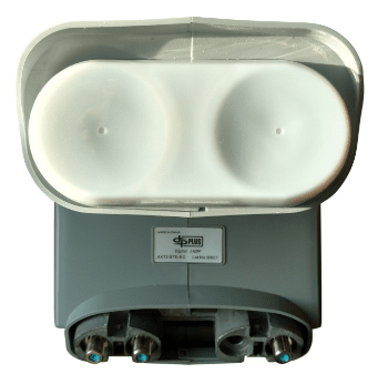

The A42909 is an eastern arc (61.5 & 72.7) LNBF typically used on a 1000.2 dish. I'm not finding a match for the other number in my reference sources. The 110/119 DPP LNBF for the 500 dish is pictured below, although there are other setups for the 500 that use two DP single LNBF's and an SW-21 external switch.

Your picture looks like what is up there now.

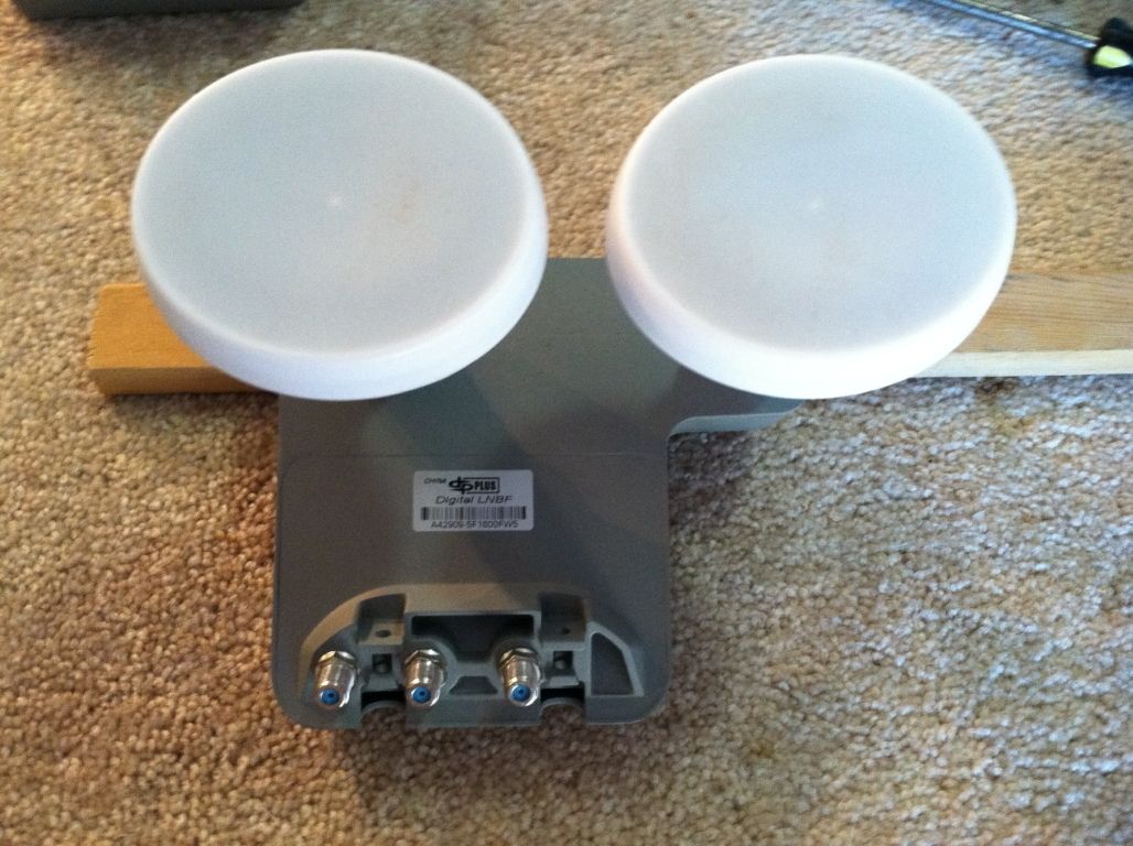

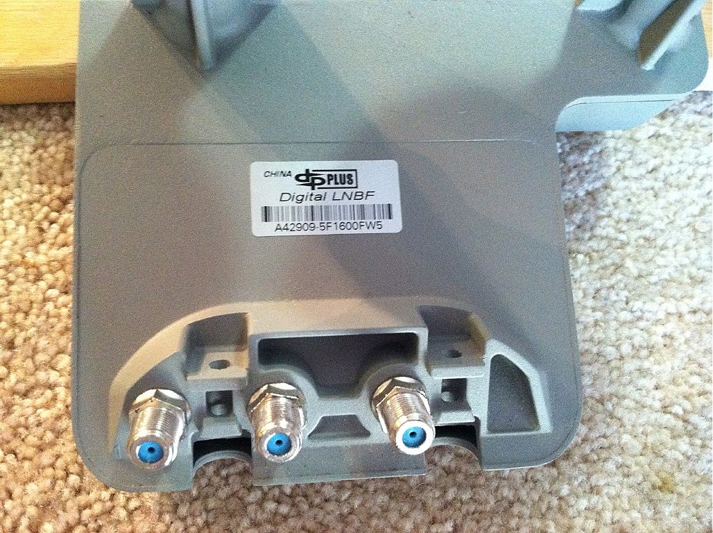

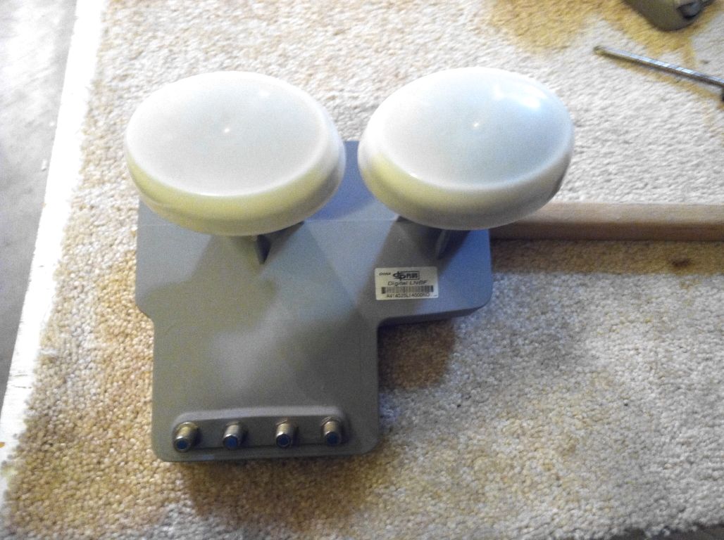

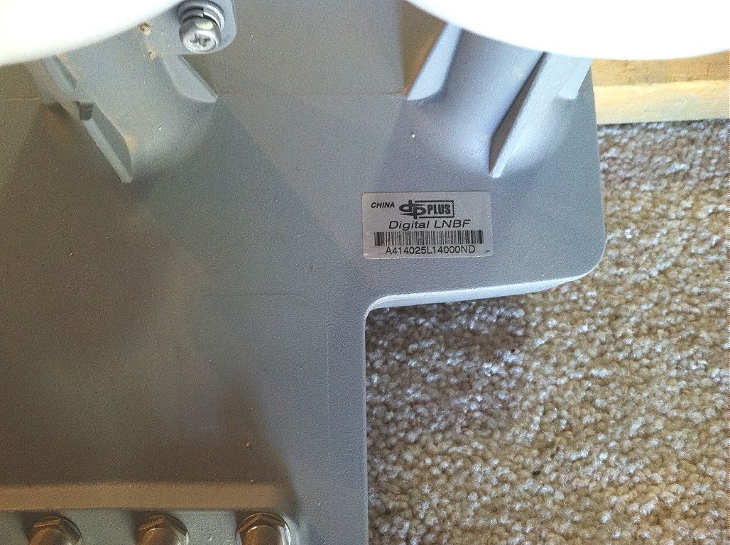

Here are pics of the two LNBs I mentioned in the first post.
A41 LNBs (Medium).JPG A41 tag (Medium).JPG A42 LNBs (Medium).JPG A42 tag (Medium).JPG
View attachment 141395 View attachment 141396 View attachment 141397 View attachment 141398
Neither of those look like Dish 500 LNB's.
Nuts. I was afraid of that. So what are they? Apparently "Dish Pro Plus" refers to a wide range of LNBs.
The first LNBF is a DPP500+ International LNBF. It will only work with a Dish 1000 kit and you'll need to add a sidecar, DP Single or Dual for the 129. But, not needed if the 129 is obscured.
The other is a 1000.2 Eastern Arc LNBF for use with a 1000.2 Dish Kit
