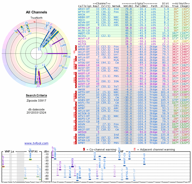

Ft Myers has a good selection of Channels
