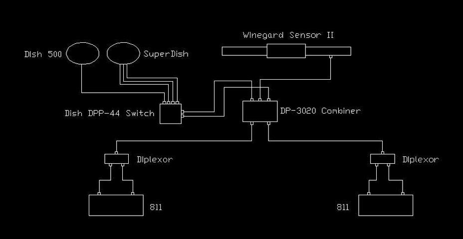

This is how I hooked everything up if anyone needs a diagram.
Nice diagram. However, something is amiss as it shows a VOOM dish (legacy LNB) hooked up to a DPP switch (which is incompatible with legacy LNB's).

good catch, thanks. Picture updated.
Much more better :). No biggie, just didn't want to see anyone following the diagram purchasing some stuff that won't work together.

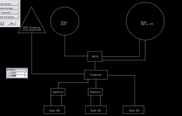

So the dish installers didnt have the diplexors on hand? I am having mine installed saturday with voom and planned on using my exisiting antenna for OTA however mine is not powered. Here is what I think the install diagram would look like....please correct me if I am wrong
The dish marked VOOM implies a legacy dish which will not work with a DP/DPP switch. It should be marked DISH 61.5 to avoid confusion. To feed three recievers you need three lines from the DP switch (two into the combiner to get sat/ota, one to the 311).
