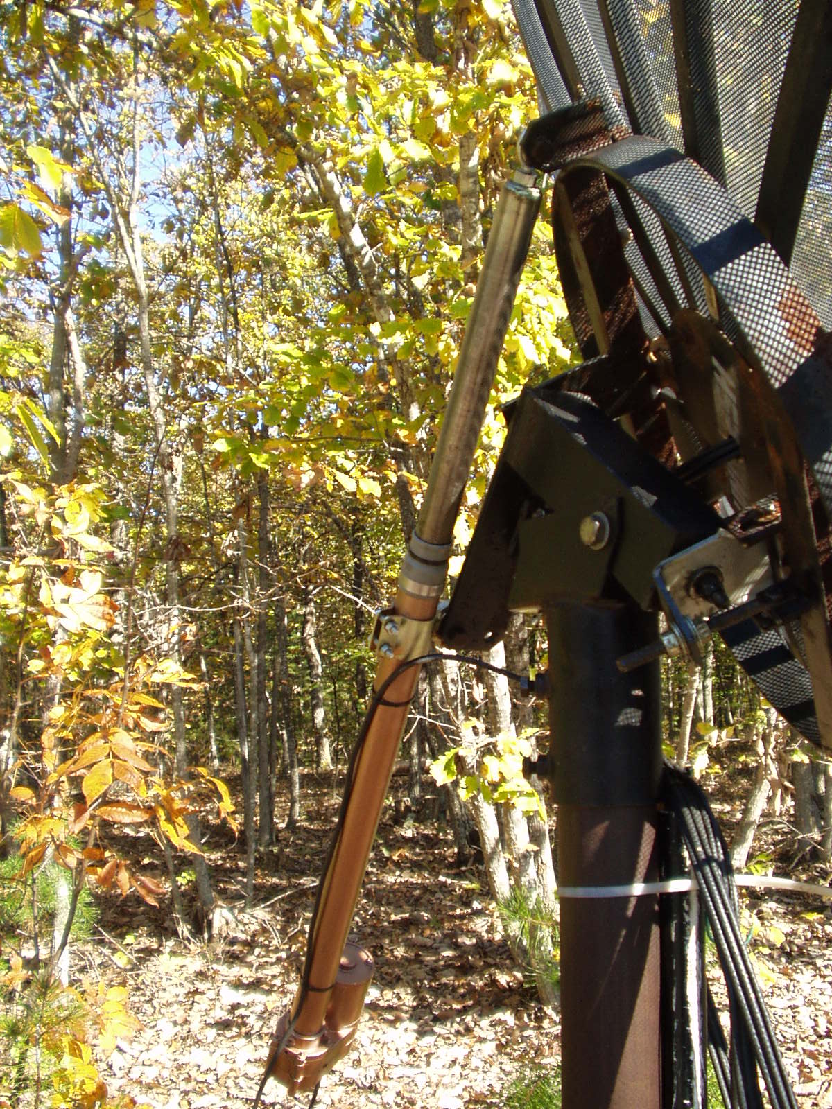

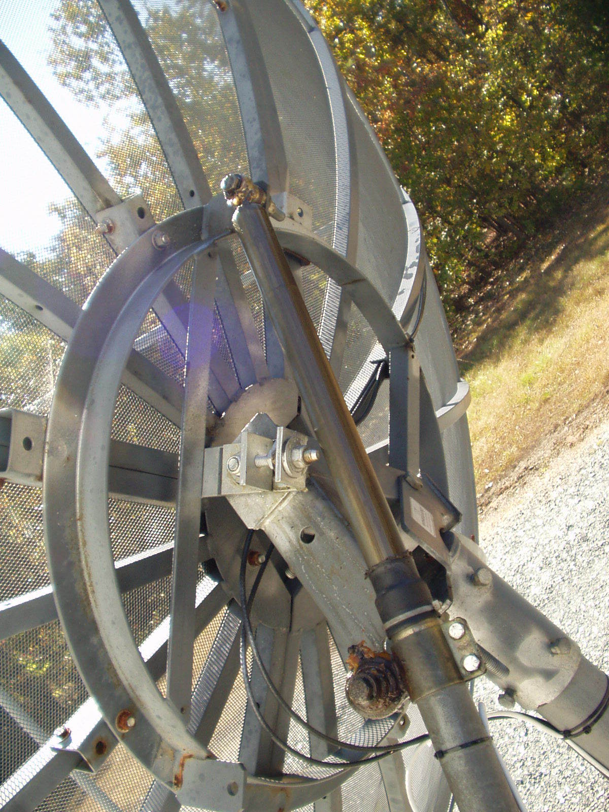

What limits my travel is the physical limit of the polar mounts in relation to the linear actuators. I took a couple of pics to show what I mean as right now both are almost at a point of contact with the inner tube of the actuator and the upper dish mount pivot. I could probably make some 1 or 2 inch spacers to lift the actuator up to clear these obstructions but I can't receive anything past 37w because of trees that I don't want to cut down. Keep in mind that I'm at 79* due south and my actuator is mounted on the West side. The Unimesh is the pic on the left and the Winegard is the one on the right.

View attachment 92184View attachment 92185

I have attached some pictures that you can evaluate my current installation any suggestions are welcome;)
picture: 012,013 (actuator), 019(elevation setting), 025,026 (declination setting),030 bubble tool (mast plumb), 032,034 inclinometer in the pole (mast plumb)

With the dish set as in picture 1. Check and adjust declination. That's the difference of the angles measured in pic 1 and pic 3.
With dish still set as in pic 1, Set angle in pic 3 to your Latitude. (elevation)
Rotate mount on pole to find 97W (don't use the actuator)
Adjust angle in pic 3 and rotation of mount on pole to maximize Q.
Lock down the elevation adjuster. DONE
Then look to other satellites with the actuator.
Adjust actuator and twist of mount on pole to peak.
When at furthest E or W satellite, and Q is 'maxed out' Tighten up mount on pole.
Go find all satellites and program the VBox.

The actuator is neither fully extended or retracted when setting up your southernmost satellite.
We will set up the actuator later, after the dish tracks the arc.
actuator on east side- set up. Retract the actuator fully, extend it just a little. Slide the actuator fore-aft in the clamp on the mount so the dish is just past your desired furthest east satellite. See if it will extend to your furthest west satellite. A compromise will have to be made if it doesn't. (or a longer actuator??)
Just past your furthest west satellite, set the limit switch in the actuator so as to not 'over extend'.
#1 rule :: the mount points due true south
#2 rule :: align the dish starting at due true south
#3 rule :: Set the elevation and decl. for your latitude when mount and dish are aligned at due true south
#4 rule :: The actuator should be all the way screwed in (like new out of box) at the lowest sat in the sky which you adjust with the clamp. This way you get the most out of the arm
These are rules you do not have to follow; but if you do not; you will take a day to forever (hourly waged?) to figure out that that is where the whole thing must be locked to anyways. If the closest to south satellite does get blocked after this, then move to the closest one you can get using the actuator and vbox; and tweek it from there (small adjustments to get imperfections out of the entire assembly)!
