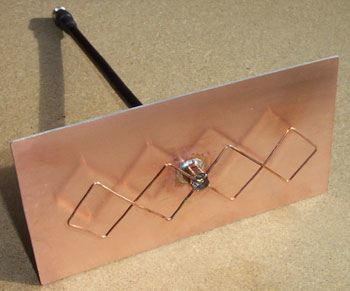

Okay, so I was still battling this issue. My walls are THICK!
So, after making a jumper cable, extending my antenna, and using a parabolic reflector, I still wasn't able to penetrate through 2 walls of 1.5' thick adobe. (The tv2 is only 25' away!)
So, I started to research this. The antenna is operating on a 2.4Ghz frequency. I figured any wifi antenna should work with this receiver. So, I built a Double Biquad antenna, following the instructions on this page:
Biquad Antenna Construction
I think the main reason why dish put a proprietary connector on the back of the unit, is because regular RG6 has an impedance of 75 ohms. I'm assuming that this antenna was designed for a 50 ohm impedance, and that's why we can't combine it onto the RG6 like we did with our old receivers. With a higher impedance, a lot of power is wasted as soon as it hits RG6.
This didn't stop me from giving it a shot. I built a double biquad that has a gain of around 13-14db. I don't have any 50 ohm cable yet, but I used regular 75 ohm RG6 because I figured the gain would probably give me at least a little bit of improvement.
It finally worked! I know this is going to the extreme, but it was a fun project, and I think the double biquad looks pretty good on my wall! I'm going to order some 50 ohm LMR-400 cable to get the best bang out of it.
Technician1313, cool looking antenna. Is it still working good for you? Did you try out the 50 ohm LMR 400 cable?
