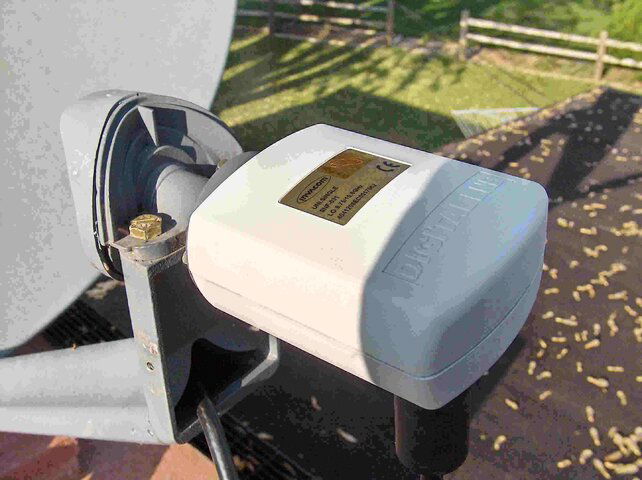

I'm sorry the Invacom pictures are a little blurred. Stefan it sure looks like the same.I hope these pictures get others to try the Invacom LNBs. I'm extremely pleased with mine! Mike
