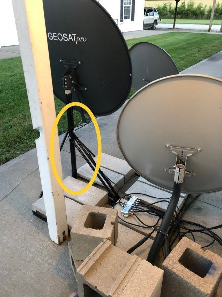

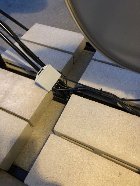

Do you have it mounted to something, or can it be freestanding? I am not allowed to attach anything to the building
BTW, I have gotten away with putting 8X1 switches outside in the rain. They are sealed, BUT.... water will seep in through the unused ports. So like Brian said, I cap them off with little water tight caps I have for F-Connectors. Don't use the 75 ohm terminators.

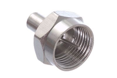

These are the terminators I put on the unused ports. Are these the right kind?
If you use those, break that stinger out of it. No need for terminated loads on unused ports with these types of switches.
Then put a dab of silicon in there before screwing on.

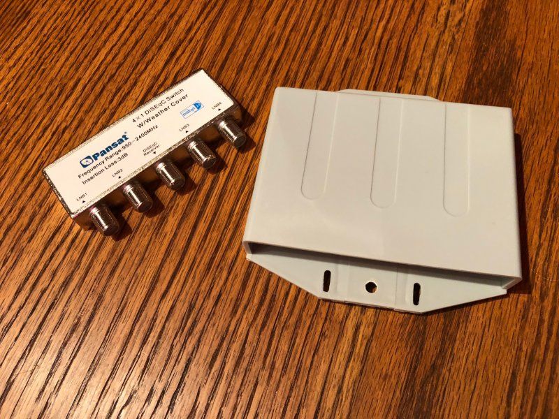

Bought this Pansat 4x1 switch w/weather cover from Casey @ Hypermegasat on Ebay. Was about $6 shipped. Will try it out this weekend.
