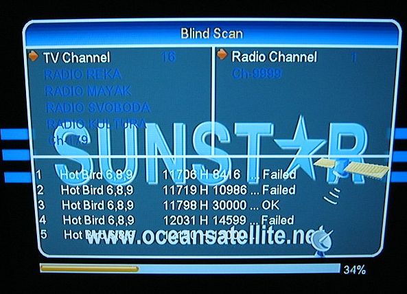

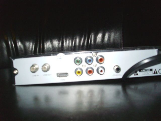

Well got mine today. Receiver is smaller than I expected,about the size of a openbox S10. Remote is also small and has clunky sounding buttons. Blind scan is fairly fast but it does miss some transponders. It does pick up news feeds that have a symbol rate below 4 . I was able to receive the CBS feeds on Galaxy 16 ku that are 3979 symbol rate. I did not pick up any transponders that had a lower rate than that. One really annoying think is it displays a Sunstar oceansat banner across all menus making them hard to read (see picture). This receiver could defiantly use a firmware upgrade. As it is now I am not impressed with it. My Openbox S9 is a much better unit. IMG_1063.jpg
3979 is close enough to 4000 so that might be why
That banner on the back looks gaudy. Wonder if there is a way you can get rid of that yet keep the rest of the screen?

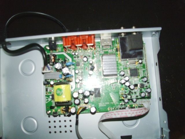

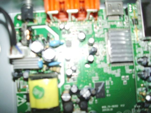

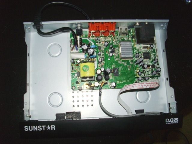

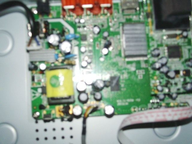

Thanks for all the updates Bugs. Can you get some better pics of the guts that aren't blurry?
