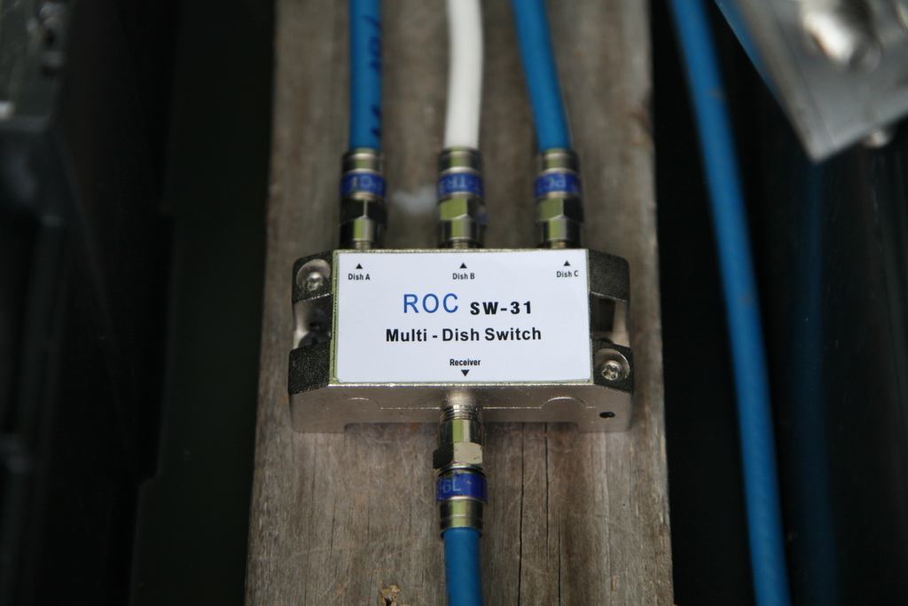

Ok, this is making me insane..
The switch is labeled with A B C.
I ~had~ dishes physically connected to the ports as follows,
Port A = 110
Port B = 119
Port C = 129
HOWEVER, The tuner reported to me that I had it connected as follows,
Port 1 = 119
Port 2 = 129
Port 3 = 110
I went outside and changed the wires ONLY on Ports B and C.
Now the tuner tells me things are connected as follows,
Port 1 = 129
Port 2 = 119
Port 3 = 110
:confused:
Are the ports on the switch backwards? The more I look at this the more I spiral deeper down the deep dark confusion well.
Such as C =1, B = 2 and A = 3 :confused:
I just figured I better stop now and ask because I had to do a check switch and then download a new guide all over again which was really time consuming.
And I'm wanting to watch the evening news for the next hour and a half so I don't want to play that game all over again until I know for a fact how to connect things up.
Thanks..
I can't seem to find a Dish "SW-31", now, I very well could be wrong, and most likely am, but would a DP34 not be a better idea? I have been out of the Dish end of DBS for a while, so I might be wrong. I think she may need a DP34 though, what with combining three antennas (110, 119 and 129). Even though she is just going to one receiver, she could just terminate all of the unused outputs.
shes using Legacy LNB"s which require that aftermarket switch
huh never thought of it. It must be. When I originally hooked it up I did 119,110,129 on the ports but 129 & 119 were flipped after the switch. So I just flipped them ;)
She is using an aftermarket switch, not a Dish branded switch along with legacy lnb's. She would have to get Dish Pro lnb's in order to use a DP switch
