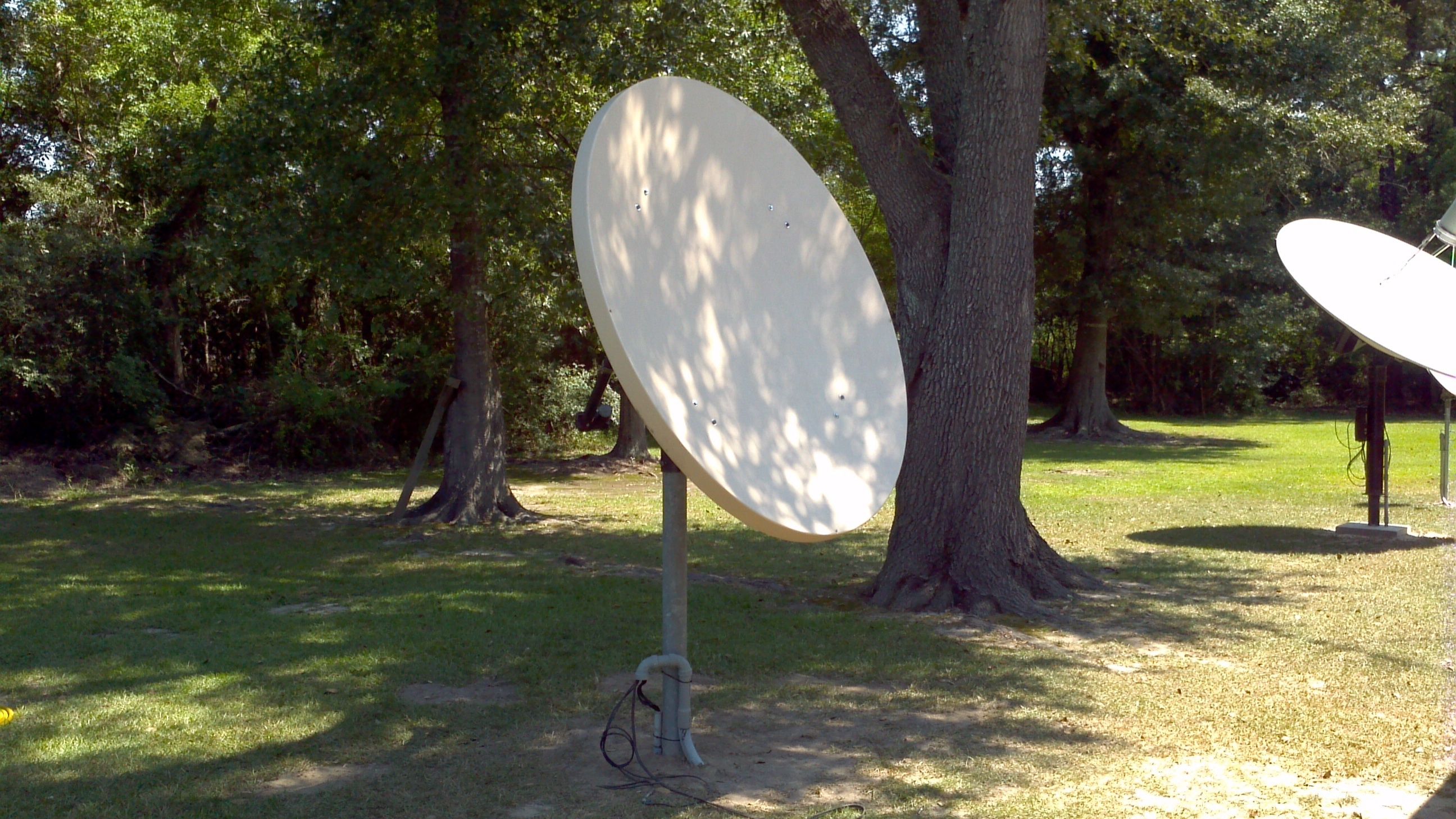

I wonder if that sealer/primer for housepaint would stop the stain from coming through the paint? Works great on wood anyway.
Nice work there, if that was all the damage he could do with that big ol Komatsu, lol.
Seeing that dish on the sawhorses gave me an idea about playing marbles for some reason!
If I had to do it again Turbo that's what I would have done, Kilz it, then paint over the Kilz. That ship has sailed though, it is what it is, now.

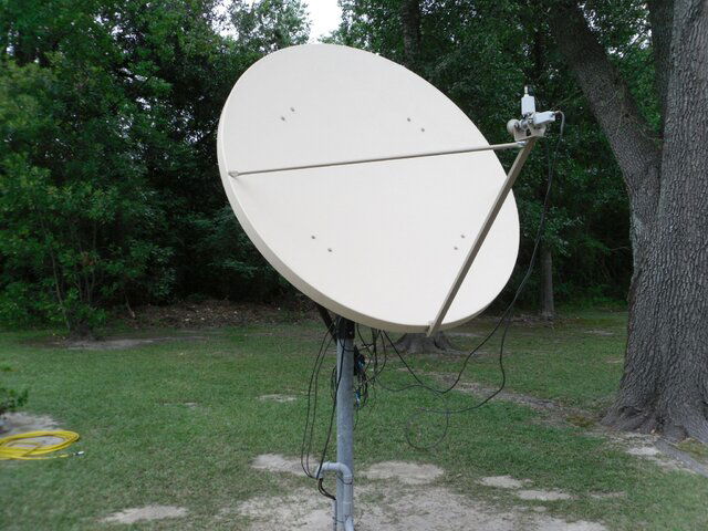

I was bored this morning so I mounted 'er up.
Mount:
....and here's the dish mounted up, ready for the arms.

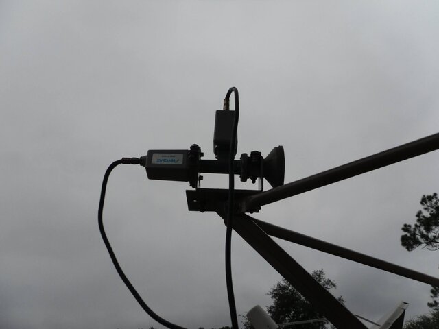

Looks great, Stogie! Is that an SG-9120A motor on there?
EDIT: After further examination, its definitely not a 9120A. SG-2100 with optional large mounting tube? :)
Yeah and I don't think the tube I have is for that motor...time for some re-engineering....LOL

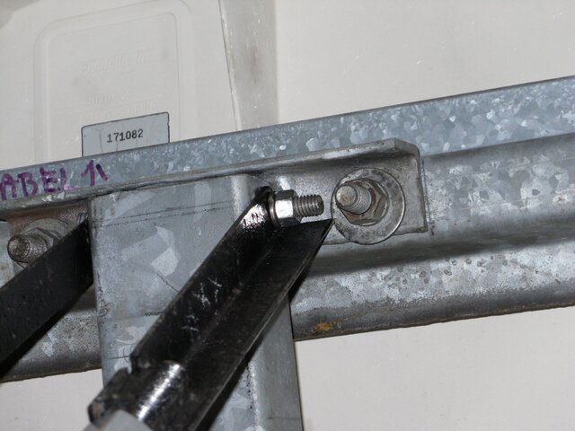

Then set about how I was going to bolt the winegard mount to the Prodelin frame...immediately I thought of my old friend the U-Bolt...centered the mount on the Prodelin frame, drilled holes through the winegard square tube...
Then I realized the bolts were too long, so I broke out the sawzall...:D
...and here it is ready to mount up. Soon as I get some help. ( its HEAVY!)

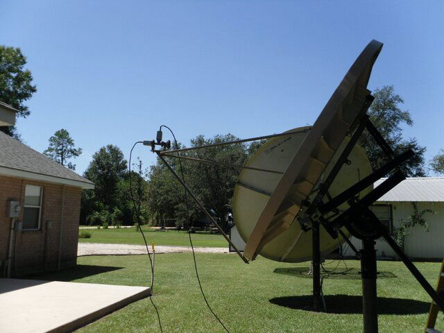

I went out this morning, and with a little help from my understanding wife....did this...I didnt tighten anything down just yet just wanted to get it up there to see what it looked like...LOL
Thanks J.
View attachment 69172View attachment 69171

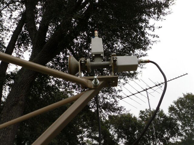

Man you guys sure have a a lot of confidence in me....between Tropical Storms, Vacations, and numerous reworks due to backyard engineering cockups, its coming along. I have put it on and off the mount three times now reworking the bracketry.
And yes, Tony, I do take pains with the details, just because I have to LOOK at it every day. :D
Sneak preview: But it has changed since that picture was taken.

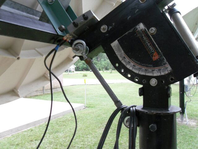

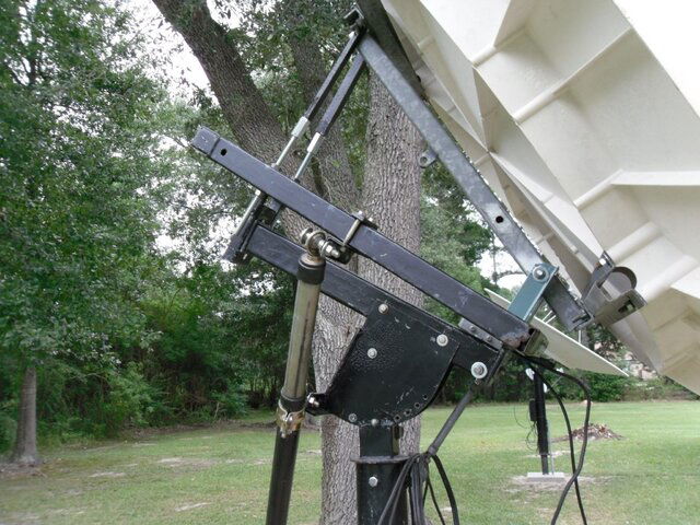

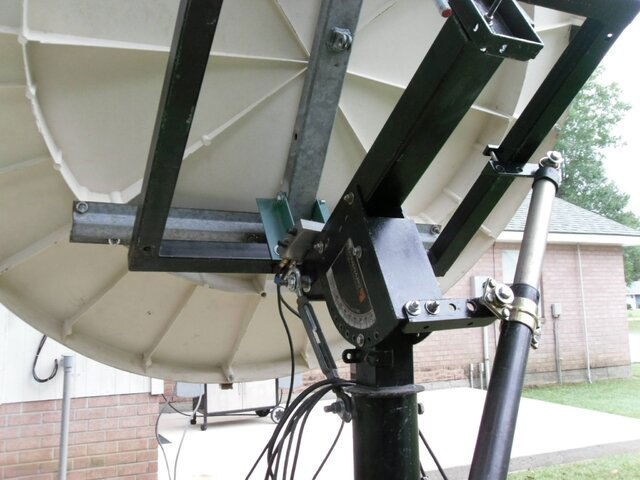

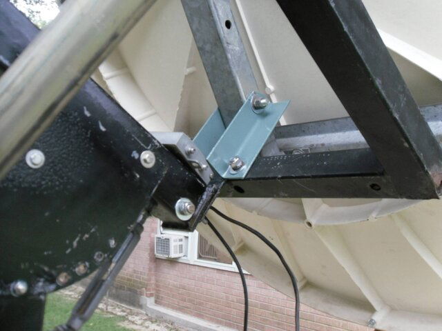

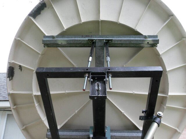

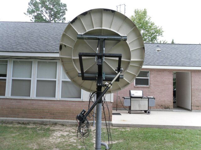

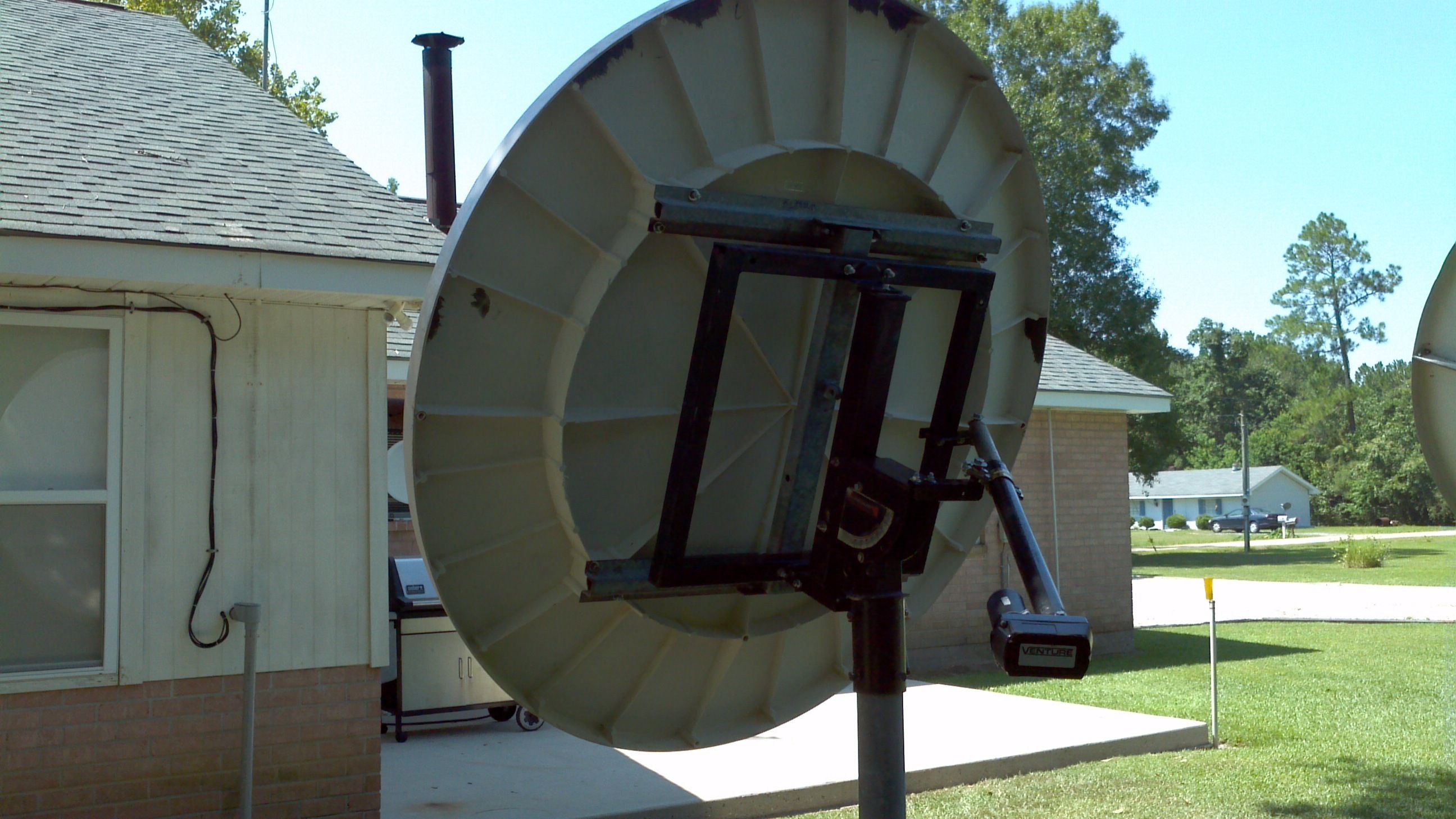

Its getting there. After many trial and error reworks its finally tracking the arc, only for me to find out my mover box was bad, so I am waiting on Sadoun to ship me a new Gbox for it, figured I might as well get the Cadillac if I was going to have a Cadillac dish... :D
Pics, pics pics galore!
