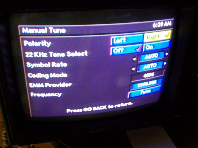

One of these pics is of the left or right polarization status that was different.

But,did you get it working yet? The manual tune thing i beleive is neccessary on some 4DTV's due to the Homing satellite change from GO to G1. I know thats what i had to do to get my 920 to get a digital lock on G1 3. After i got the lock it then preceded to download the channel maps. Yours maybe something completely different. I don't know. I would call NPS and ask them if there is a different sat you can get a lock on.
No it is not working.
When I hit the tune button it was still tuning 3 hours later, so I assumed it wasn't going to do anything.
On that manual tune window the polarity was on the left when I first open this window, I changed it to the right to see if would help, but it didn't so I have now changed it back to the left.
Is there any reason you said NPS rather than skyvision? I seen on one of those windows there was a 800 # for somebody, don't know if it was the previous owners provider or not.
Bob

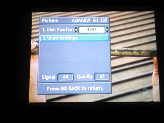

Do you have an "adjust picture screen"? Like this. And does it give you the same 20 signal, 99 quality?

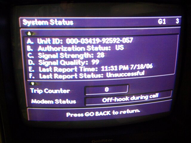

I also did take the 905 out to the dish, connected a FTA and tried peaking everything, wasn't able to do much. Was getting quality of 44 on the FTA but don't have any idea how that number would related to the 905.
Anyway it did not cause me to get a green light.
I brought up the diagnostic C window and it does not make a difference with anything I do. It still shows the -3.00
bob
Also did you try slaving the 905 off the FTA receiver instad of the analog receiver? I read somewhere that the 905 will display a Q of 99. When in reality its actually zero.
