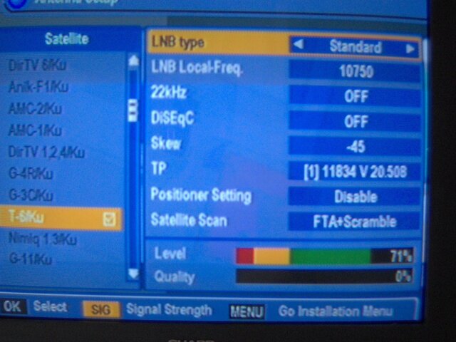

Go into the antenna setup and select T6 (thats the old name). Set up the screen in the right EXACTLY as I have in the below picture (the 1st one)
scroll through the transponder list (TP) until you see one of the follwing
11710 V 14310
11865 V 3615
Both of those are strong and should be able to help aim the dish. Now aim the dish straight south. As you move the dish, watch for Quality. You need to move the dish S L O W L Y (1/8" or less at a time) and see if the quality bar moves. Until the quality shows up, you won't get anything.
You may have to adjust the elevation a little bit but you shouldnt have to move more than an inch or so off of the straight south.
Once you get quality, try a smart scan and see what you get.

swapped out the invacom with a plain ol universal lnbf (a part I ordered via ebay before ordering the invacom) - still no go... I was thinking maybe the other lnbf might have been the problem?
this is quite frustrating and annoying! ...
The reciever is set up like your image Iceburg, with the sig button in the installation setup pushed... annoying having to go down to receiver to hit remote sig button and then up the ladder, etc. but the real annoyance is having been out on the roof all this time (about 3-4 hours so far) slowly moving dish left and right (moving the motor's U bracket)... and then nudge up elevation a degree or two and do it all over and over and over and over... with none of it bringing any success... urgh!

If you switched the LNB to the Universal, then the LNB LO has to be changed to Universal from Standard.
Honestly I would remove the motor temporarily and get youe true south locked in using a fixed dish. Then you can mark it on the mast because your true south is in the same spot whether on fixed dish or motorized (just the elevation is different)

mastermesh, it might help us to help you if you could get some screenshots on the tv screen of some of the set-up pages in the menu, to see if we can spot something you may be overlooking.
