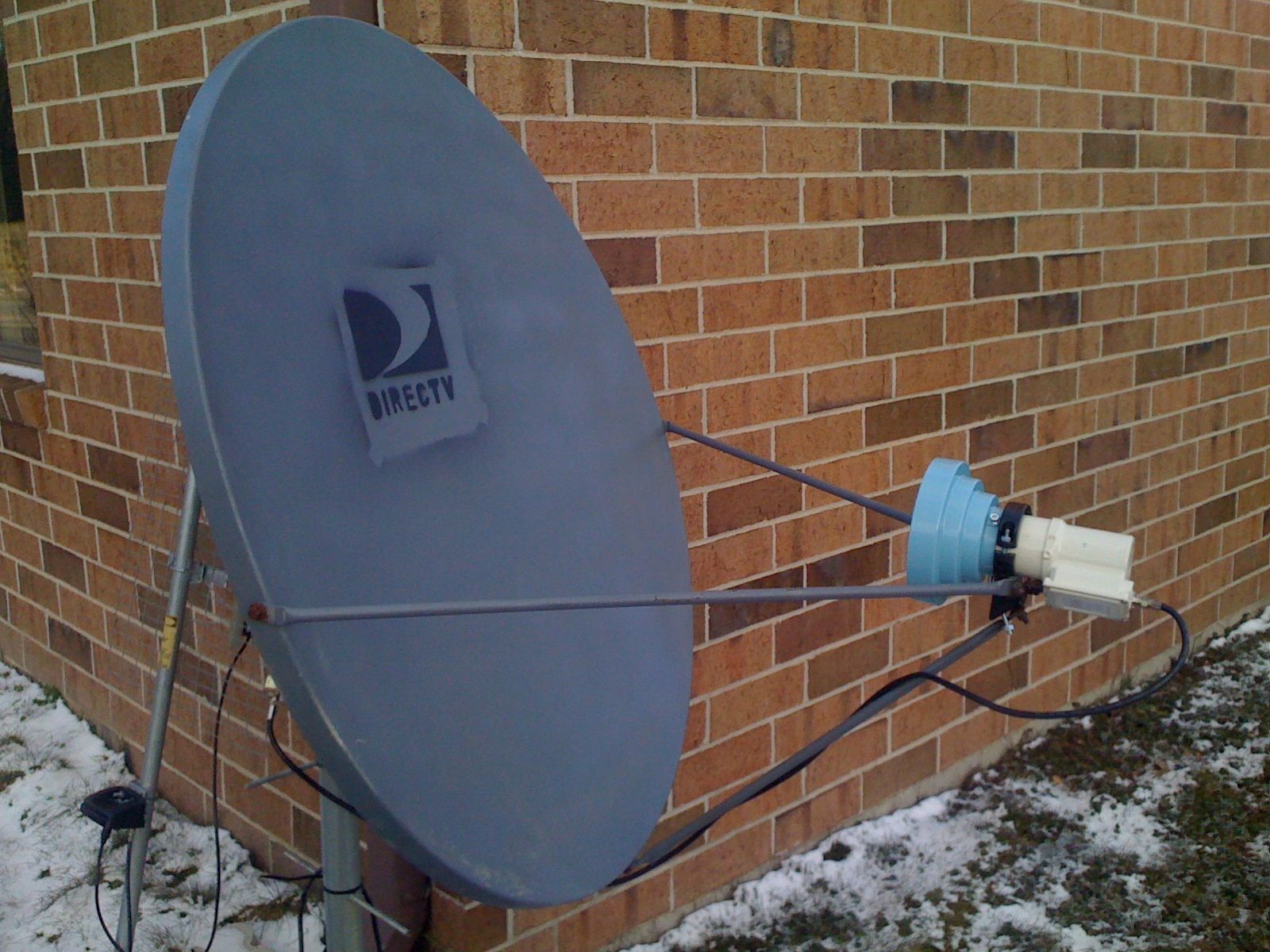

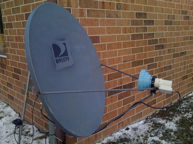

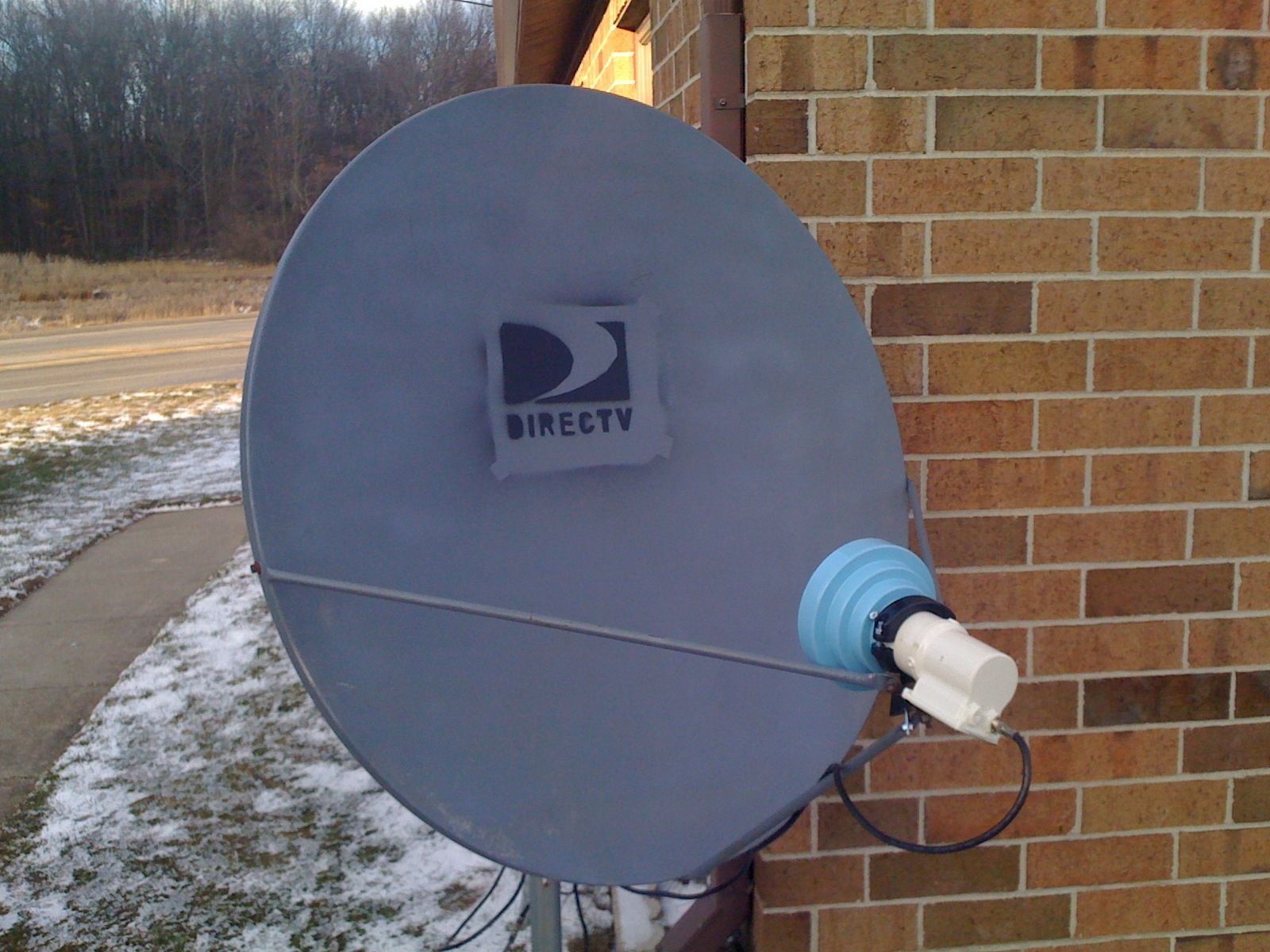

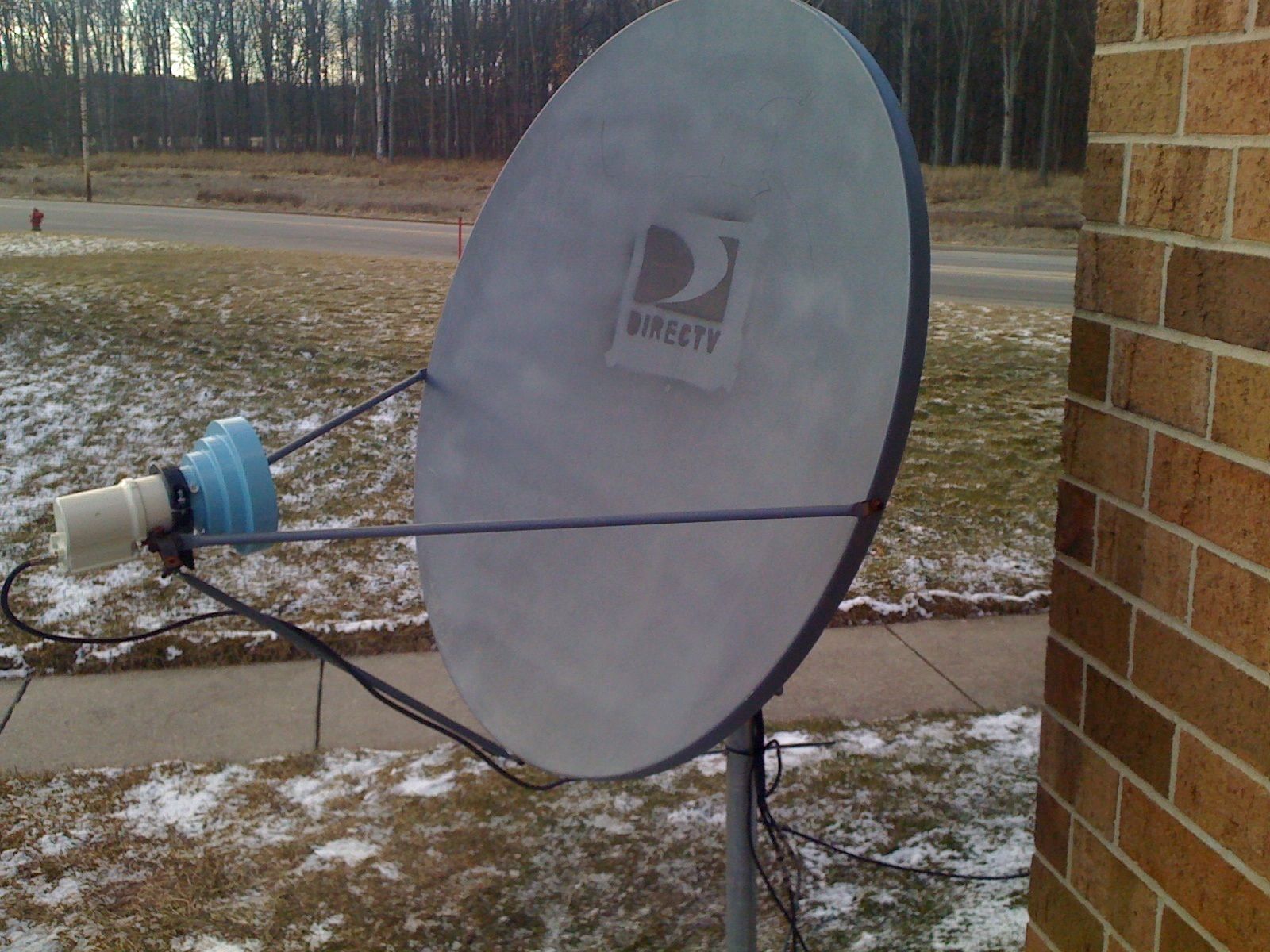

Its a 1 meter dish measured it myself falls under 1 meter rule reason why I call it slimeline mods is I still use a slimline mounting bracket that the dish sits on.

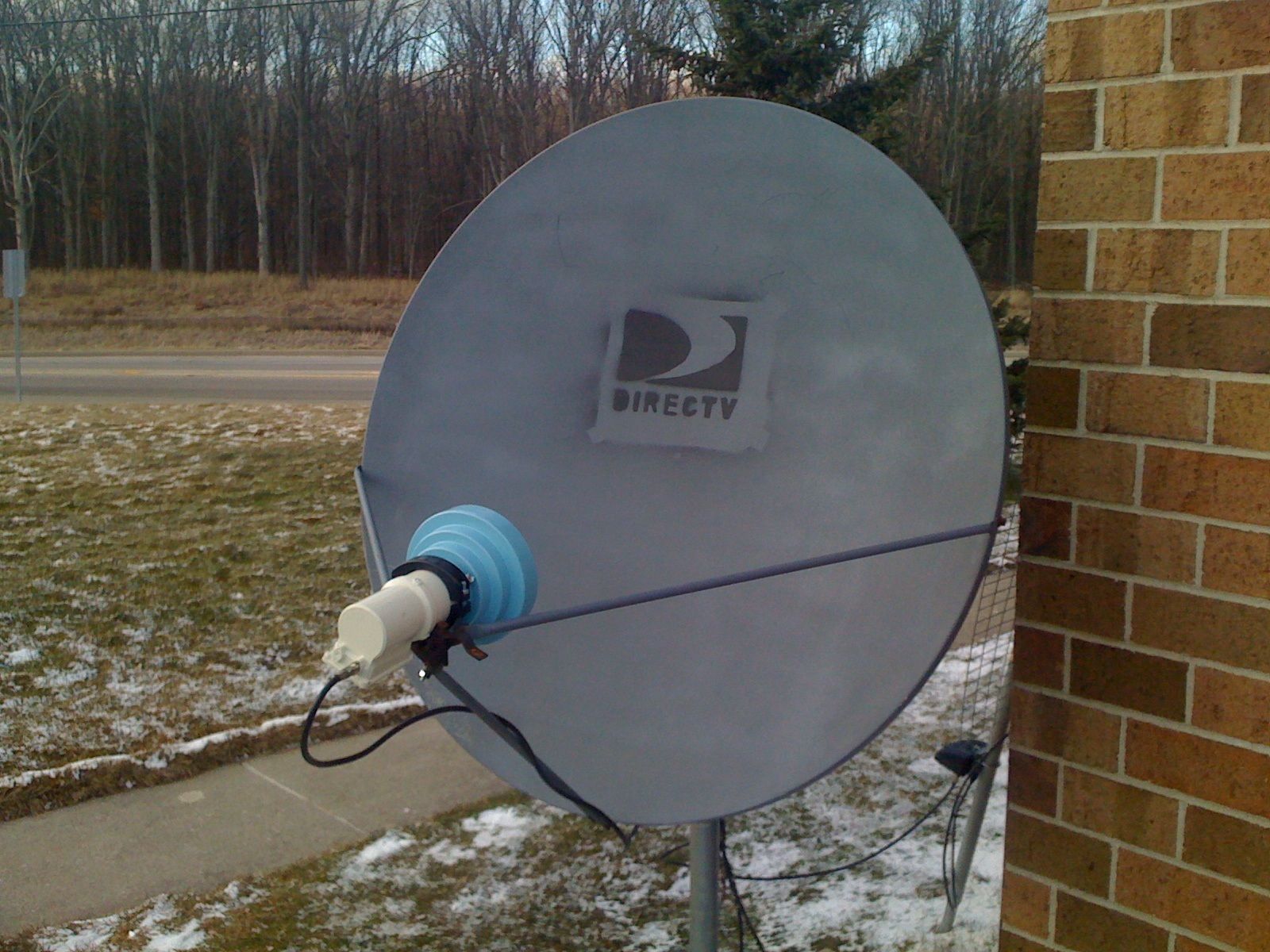

i love it when you just drop the lnb in place and not even set it properly and you get something to watch. A C band satellite installer told me I would never get c band on a 1 meter dish told him he can eat his own shoes. What receiver would be the best to receive more channels micro HD, Manhattan, or any FTA HD recever? This is one fact about C band is true with using a offset dish you do get a lot of interference from other satellites. I have a good question for Anole. To eliminate ground scatter can I put metal shielding on the lnb support arms? to pieces of metal would hang down from the side support arms connect to the bottom support arm. it would look like a metal V.

The thing about adjacent satellite interference, is the dish beam width.
Only solution there, is a bigger dish.
Or, you could set your sights on birds where adjacent satellite interference is minimal.
Perhaps the next SEVERAL satellites. ;)
A lot of studying Lyngsat and The List would be a good start.
As could reading threads where others have used undersized dishes.
An ortho feed and PLL LNBs might get you a little more, but wouldn't suppress adjacent satellite interference.
Most would call that, gilding a turd. :)
It also looks like that Directv was sprayed caned. But who cares.. your dish is cool. :thumbup:

I sprayed the logo on there to fool people that the dish hasn't changed at all well they haven't noticed since I put it up in october.

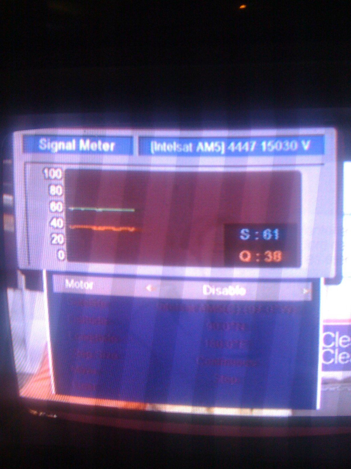

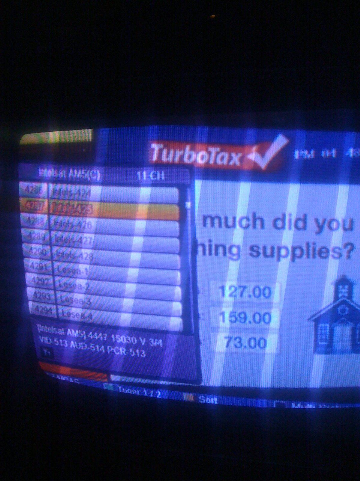

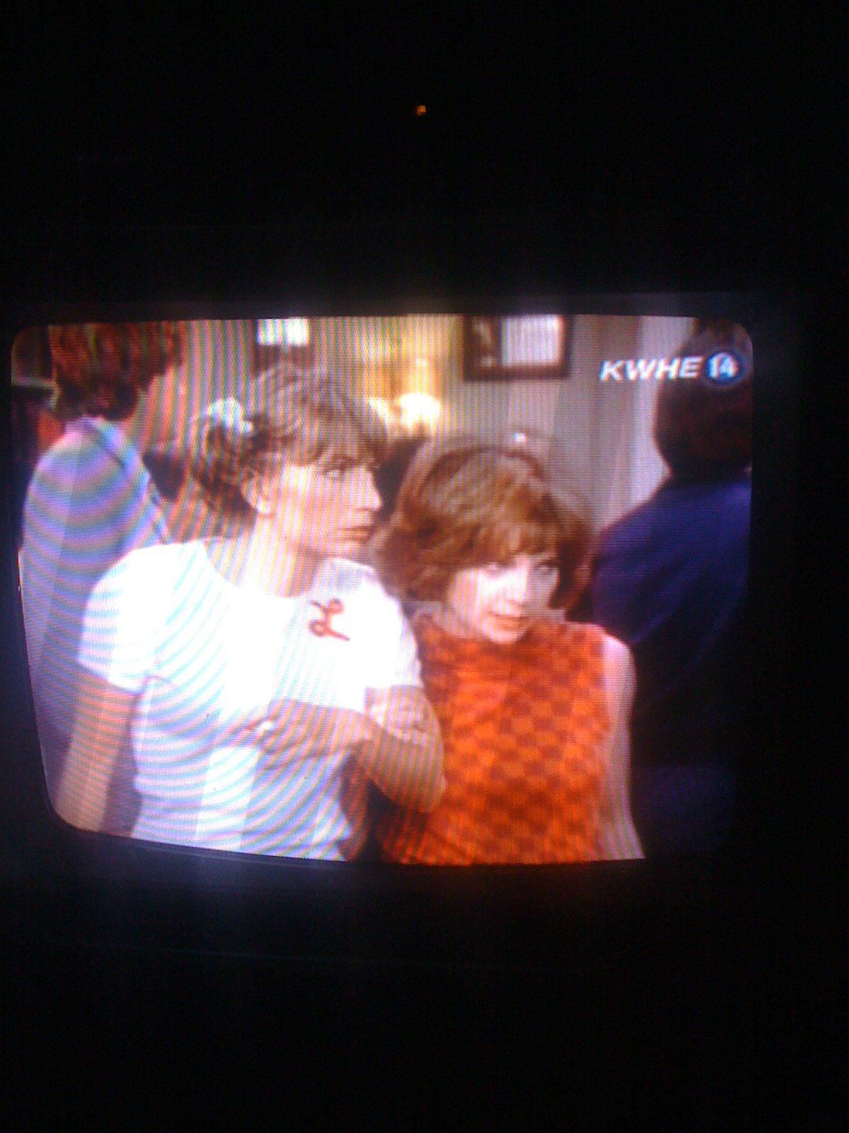

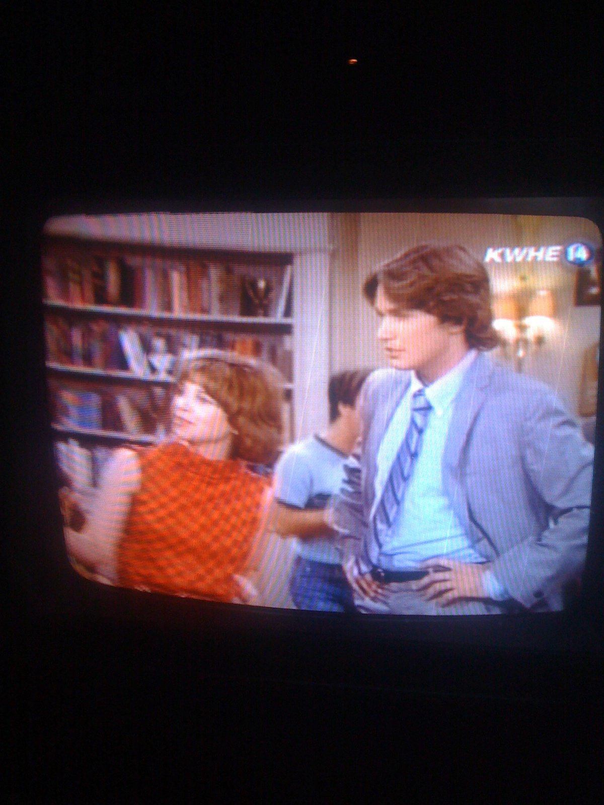

Hey guys I have'nt been around for a few days wanted to give you guys an update on my minibud project. I just got my Micro HD a few days ago I love this receiver way better than my old sonicviews. I want to give a thank you out to Brian at satelliteAV and wallyhts he is a good seller. Here are some more pics and plus I am up to 2 satellites I have picked up with the micro HD 99W and 91W. I am holding off for this summer to work on it further. 023.JPG024.JPG025.JPG026.JPG

Hey guys I have'nt been around for a few days wanted to give you guys an update on my minibud project. I just got my Micro HD a few days ago I love this receiver way better than my old sonicviews. I want to give a thank you out to Brian at satelliteAV and wallyhts he is a good seller. Here are some more pics and plus I am up to 2 satellites I have picked up with the micro HD 99W and 91W. I am holding off for this summer to work on it further.<img src="http://www.satelliteguys.us/attachment.php?attachmentid=86295"/><img src="http://www.satelliteguys.us/attachment.php?attachmentid=86296"/><img src="http://www.satelliteguys.us/attachment.php?attachmentid=86297"/><img src="http://www.satelliteguys.us/attachment.php?attachmentid=86298"/>
