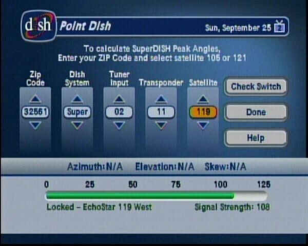

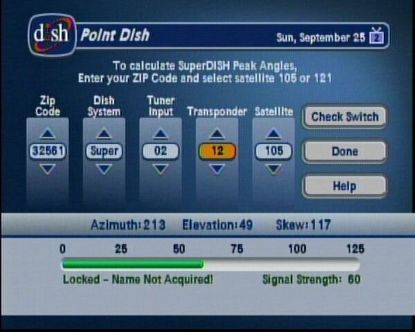

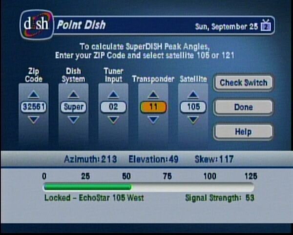

How about telling us your signal strengths for transponders 11 & 12 on 110 & 119 for BOTH tuners (not outputs) and BOTH receivers.
While you're at it, note the values when the weather is good, and then compare when you see rain clouds between you and the satellites.
Hmmm, well it is on one reciever
<attached images>
Looks like 105 ain't what it used to be.... :shocked
Same signal on both recievers.

Well, your pics are pretty, but just typing the numbers would've been easier for both of us - and then maybe you would've given what I asked for.
110-11-2 = 104
110-12-2 = 107
119-10-2 = 105
119-11-2 = 108
105-11-2 = 53
105-12-2 = 60
:river I apologize for my ignorance. I am sorry I did not provide the correct information you asked for. :shh :sorry:
Good? Bad? I know most are, but the 105 seems...low. :(
I agree with Dave. 105 signals are notoriously weaker due the them being FSS based. As long as it's at least a 50, then I would feel fine. You will start having problems with it around 40 or 45. At the other extreme, the best I've ever seen a 105 is 83. Had to call up a few of my fellow installers to brag about that one. :yes
Ya. Now that we know it's a 105 SD, and your other strengths are aces, I'll bet you're only having trouble with your locals. No idea what transponder they're on.
Tune to one and then go to Point Dish. Repeat as needed. Note the transponder(s) and track THAT signal strength - the others do not matter to you.
OK, the signals for 119 and 110 are perfect, the 105 is lower than the norm for your area, we have been getting the signal on average of %75 - %85. If your loosing all channels then there is an outside issue such as a faulty switch or a faulty 322. The dish itsself could be retuned by tuning off of the 105 lnbf to bring the signal for that sat up further, doing this will have little to no effect on the other two as I have been doing most of my work down here this way.
