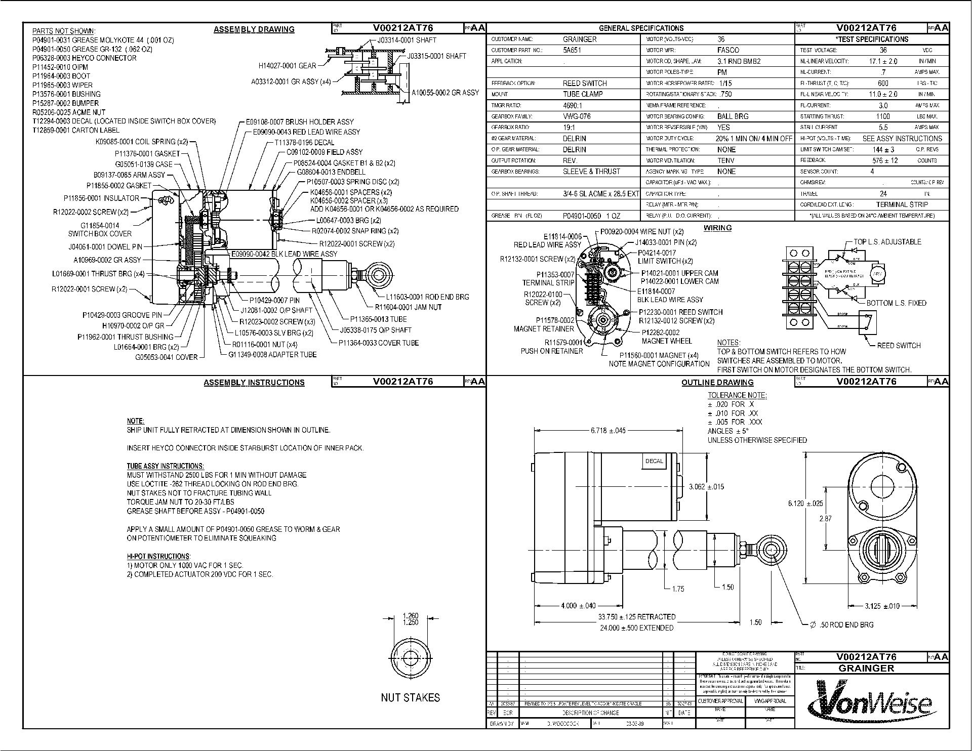

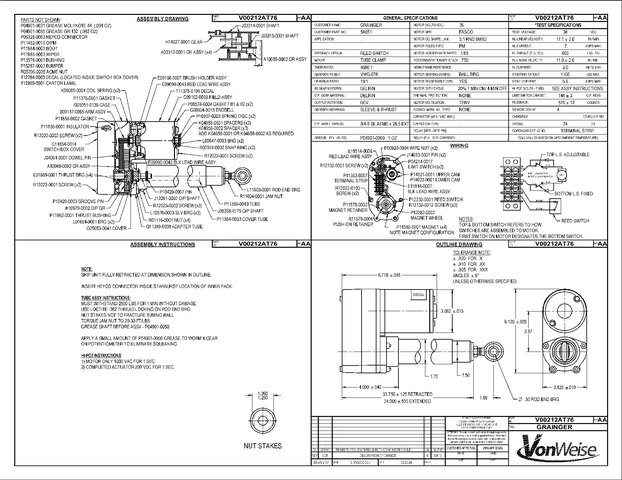

Ok, so I emailed Von Weise and Alan Signer cleared things up a bit. I still don't know the exact differences between the "V00212AT76 - VW76" and the V76-5 Actuator with telescoping tube. They both have the same tube mounting system with individual aluminum piece and the butterfly hole pattern instead of the three molded mounting tabs or whatever you call them. He also didn't tell me the resolution of it but I ordered the V00212AT76 - VW76 for a total of $225.70. The V76-5 has 8 magnets for a 48 count and the diagram he sent me shows only 4 magnets for the V00212AT76 - VW76 so that would make it a 24 count. They're the same horse power and speed (gear ratio 19:1) and I still don't know all of the exact differences.
I hope this is the one that is like the ones I have, he said it is but with a reed switch (mine was optical, I converted it). There is a model with a cheaper looking limit cam setup and I like the 2 screws to set the limit like I have now. I'd gladly pay the difference for the good one if it's that much better. If you're spending $225 you might as well go $300 if that's what it takes!!! If count is all it is I'll change it if I have to. I have magnets, nice small powerful ones that I can fit right on the wheel. I did email him back and ask for a couple of more details including the count but it was past 5PM. I think he assumed I could figure out the count and if it's 4 magnets then it has to be 24, and that's 24 per inch of extension.
I told him the models are confusing and he said that there is an error in the listing for the one I ordered. He said "The retracted dimension is 33.75" and the stoke length is 24.0". The print has a typo, it should read 24.00 ± .50 extension".
You can order them with "options" so there is no telling what you get if you buy a used one. If you get one that looks the same as yours...those options under the cover could be anything from a potentiometer or an optical setup. I have a feeling I should've gotten the $269 one, but if it's just the count, well, I wouldn't pay that much more when I can modify it so easily.
I'll let you know what arrives, photos and all. Here's the diagram he sent me. I haven't found it on SG but it's probably here somewhere. So I'm tagging this one as a Von Weise V00212AT76 - VW76 diagram or a Von Weise V00212AT76 - VW76 assembly drawing and I reduced it to 1920x1484. The original TIF image is 6600x5100 and I'm attaching it as a zip file so you can keep it if you want. The resized one is still readable but the original is much better.
