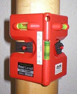

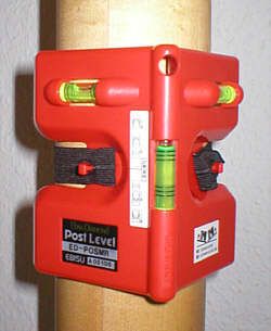

Roof installs can screw with the plumbness. The D* Tech leveled the mast while sitting on the roof. When he got back on the ladder, the bubble was halfway out of the inner circle! Needless to say ka did not work at all.
A tech was using the bubble in the mast? Moron! They are very inaccurate. The best way is to use a post level.

1st, it is imperative that the mast be level on all sides. Also, once you put the dish on, make sure its stay level.
