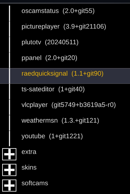

is it available in the Plugin - Dowload menu? Or did you have to install it manually? I can't seem to find it in TNAP 5.1... Or could it be that not all plugins are available depending on the skin being used? (I'm using the Glamour Aura skin)
I don't recall if I manually downloaded it using Download Plugins or it just appeared in my Installed Plugins. It's now sitting in the Extensions section of my Installed Plugins. I've always used the PLi-FullNightHD skin.
Reactions: Brct203
ok I see it now - looks like it's installed by default, i was overthinking it and looking only in the download sections - and on my images it's not listed there
it's also installed by default in TNAP 6
