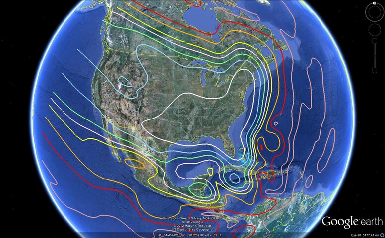

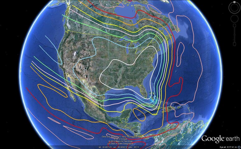

Quetzsat 1 61.5 Satmaps
The Satmaps for Quetzsat 1 at 61.5W have been uploaded.
Quetzsat has two Conus type beams which cover North America (excluding parts of Canada).
They can use either beam depending on the longitude the satellite location
Optimal coverage is provided at 77W.
Quetzsat 1 will be in service at 61.5W for the period of time between the departure of Echostar 15 (relocating to 45W) and the arrival of the new Echostar 16 satellite.
http://satmaps.satelliteguys.us/home/quetzsat-1-61-5w-tel
http://satmaps.satelliteguys.us/home/quetzsat-1-61-5w-twl
