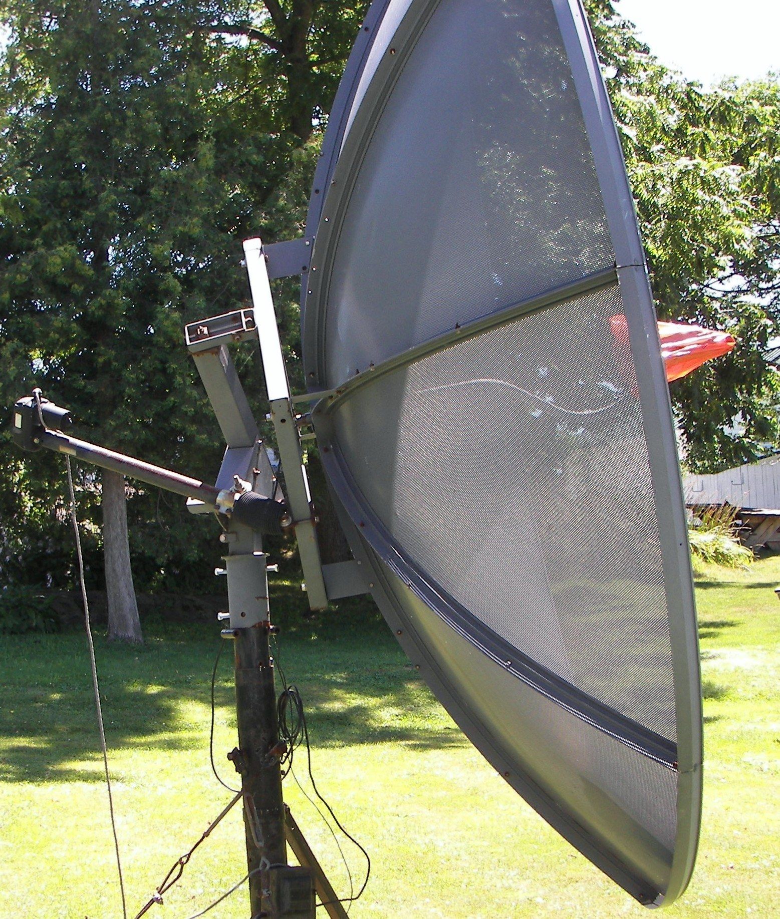

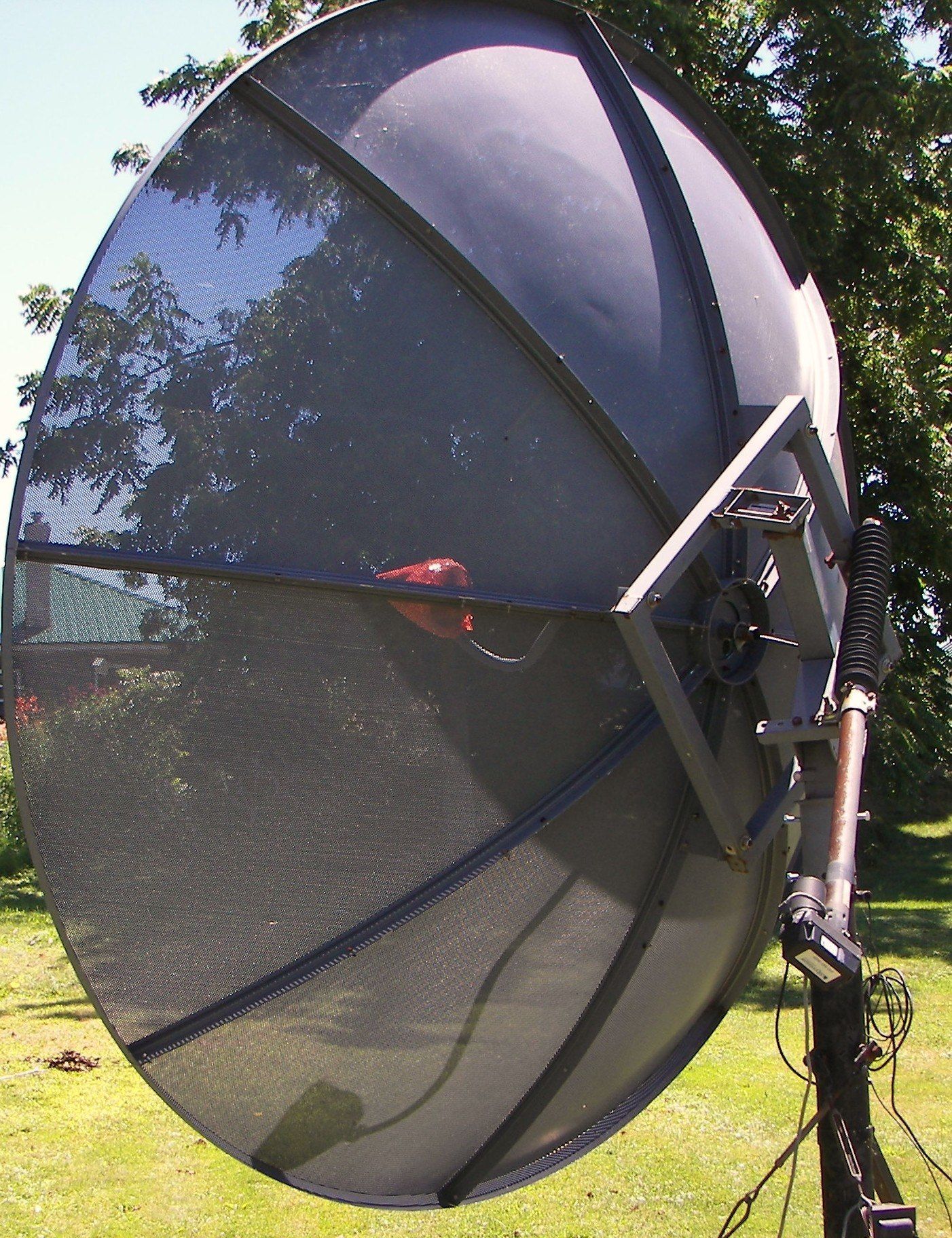

If you want to see the range with a 24",I haven't actually measured it but an 18" would probably do the same.Pic 1 is below my west horizon,my snow dump position(which doesn't work because the snow won't come out of the damn thing:D),pic 2 is all the way east ( could go a bit further but pointless due to trees/buildings).
