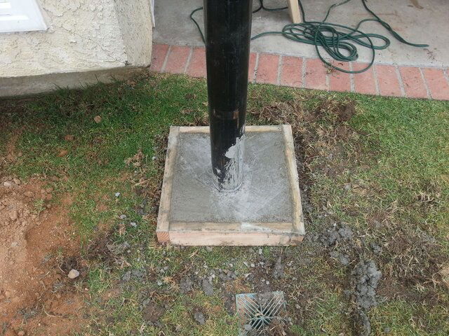

Did you make your hole slightly bell shaped like I mentioned should be done? The bottom NEEDS to be "belled-out", if you want to do a proper job of it.
Also, do not forget to drill a hole completely through the pole about 18-24" up from the bottom, and put some "all-thread" through it. This gets buried in the cement, and keeps the pole from turning due to wind load. Do not skip this step! That's also part of the reason why your hole shouldn't be a perfect cylinder, as the entire pole and cement can start spinning in a proper wind...

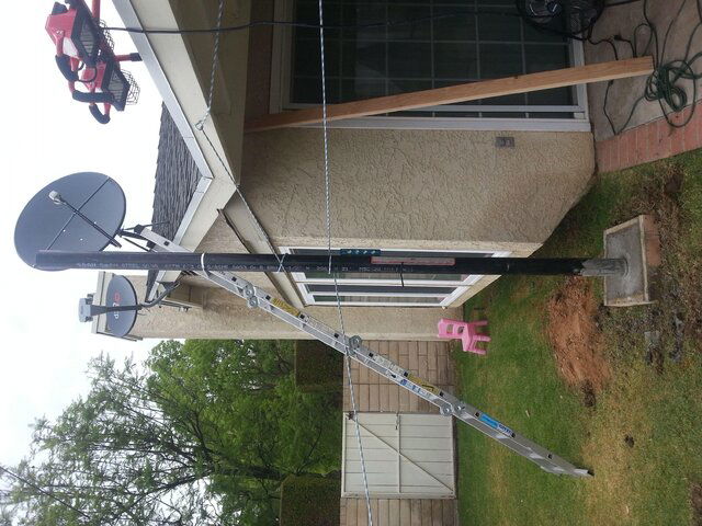

My pole has been installed! I don't have time to upload the pictures right now (but I did take some) to be uploaded later. The hole was 16"x 16"x 54" deep. The hole was bell shaped as suggested being larger at the bottom. There is 5" of pea gravel in the bottom of the hole with a patio paver laid on top of that. It took 12 60# bags of quickcrete to fill the hole. Initially the concrete was poured in with a shovel to keep the bottom of the pipe from moving. Once we had several bags in the bottom of the hole we then poured in the rest with a wheel barrow. I tied the pipe off with ropes to keep it plumb. I had levels on the pipe as we did the work to insure that it didn't move. This is all for now. I got allot of mess to clean up outside :D. The piece of 1/2" threaded rod was installed through the pipe 16" up from the bottom.
Did you check the level at the TOP of the pole, where the polar mount will be installed?
It's possible to have it level above ground where you are standing and checking for level, and to be off at the top a bit.
It only takes 1/16" inch to cause issues. More so if you also plan on using it for KU. IF the top of the pipe is slightly off level, you can shim the polar mount level, but it's a bitch to do that, and to be avoided if at all possible.
Yes I did ... it's perfectly plum. Now that the pole is in, it's possible that it might be too short. I'm gonna install the Polar Mount and put together the bottom sections of the reflector and mount them. I'll move the mount back and forth by hand to see if I'm gonna run into the patio roof. Due to the interference of nearby mountains, about the farthest East I can go is 60W. I'll attach a few pictures. I supplied a picture of the original dish elevation so you can see that it's tipped back a good amount at the center of the arc (34N here)

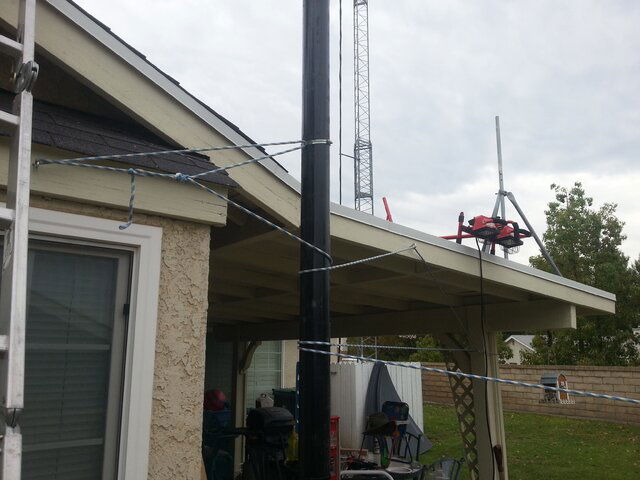

You will need to bracket the post to the house. Too tall to be free standing. It will be swaying like a drunk sailor with a medium wind.
You've changed your mind several times, and I'm lost on exactly how tall the pole is from the ground.
Last I remember, you were using 3" schedule 40, which is 3.5 OD.
Is that correct?
I took down a dish & heavy HH mount on such a pole.
It was 9-10' feet free standing just fine.
Not sure how high your patio roof is.
If your pole is too tall for free standing, get some structural advice before attaching to the house.
..?or especially to the patio roof!
?Edit: if your pole is larger, I suspect it's just fine, unsupported.
But then, I don't have a lot of wind down here...

Master 0B1Anole ... Good Morning! The pole is 10' 9" from the ground. The top of the patio roof near where the pole is 8' 9"
tall. The pole is 3 1/2" schedule 40, which is 4.0 OD. Here in Santa Clarita, we don't get allot of windy days. If wind becomes
a problem, I can buy a commercial eve bracket to secure the pole to the patio or the roof. My original calculations put the bottom
of the BUD 6" above the patio roof at it's furthest E position (i.e 60W). I intentionally kept the BUD as close to the top of the roof
as possible. I did this for two reasons, (1) so that it's within reach to work on, (2) so that it doesn't become so noticeable when
the Neighbors look in this direction. We don't have any HOA's here. However, with a 60' tower and large HF Yagi's here already,
I'm not popular in the Neighborhood. I've still got maintenance to do on the Polar Mount, and a couple more panels to clean. My
wife is on vacation starting tomorrow and she'll want to go everywhere. So, I doubt that I'll make much progress on the BUD this
week! In October if my FM Radio Station Application is approved, I'll have to squeeze in a few more antennas :D.

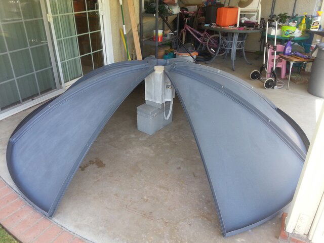

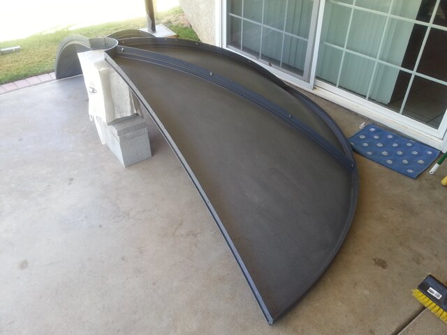

Reflector Assembly!
Worked on assembling the reflector today. A couple pictures are attached!
