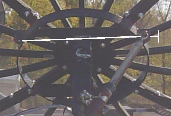

When I got back and the rain had let up a little, I went to the roof twice to measure the actuator arm at the West limit and the East limit.
The distance travelled is 12.75".
According to the manufacturer, that should produce 612 pulses at 48 pulses per inch traveled.
Well, right there is proof you could move the actuator out to the side of the dish, make it travel farther, and have more counts, more leverage, and less slop.
... that should produce 612 pulses at 48 pulses per inch traveled.

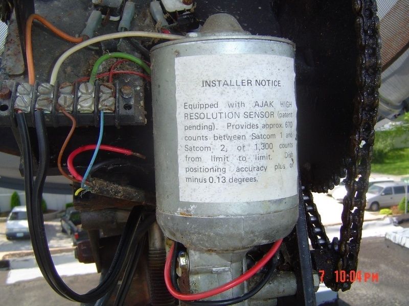

Well, I think you are in the catbirds seat with some pretty good hardware.
You don't actually have a reed switch.
I'm going to go out on a limb here, but based on the limited views I saw inside your motor, I think you have a Honeywell / Microswitch industrial hall effect magnetic sensor.
For the guys who do have a reed switch (does anybody, or am I in the wrong decade, here?) it's possible they close only between 12 and 1, not 10 and 2.
So, without knowing more, I'd have to say it's possible that the Gbox might do no good at all.
You'd still get your count at 12, but then again at 1, and none more 'till you got back around to 12 again.
It's that long run between 1 and 12 that benefits so well from another magnet.
If we had all these motors open here on the bench, I'm sure there a number of mechanical, electrical, and magnetic fixes we could apply to get more counts out of them.
But some might be easier to mod with an extra reed switch, some might be easier to double the magnets, and some might benefit from new circuitry.
Then, followed by the Gbox, you could go for even more.
I'd say the Gbox, when used in the right instance, is ONE way to get more positional accuracy.
And while not discounting the plug-n-play value of it, we might be able to electrically double counts on the old Vboxes.

The big winner is, of course the AJAK H-H mount on the Pinnacle which boasts a whopping 1300 counts from limit to limit. See Pic:

You have already doubled the magnets, to go from 24 to 48 pulses per inch
You can change the motor mount to extend to 24 instead of 12 inches, doubling your pulses.
The Gbox seems successful (on this motor) at doubling your counts, possibly counting on each edge.
That's a: 2 x 2 x 2 = 8X improvement in possible accuracy
I just read back through the posts for today and finally saw your edit Anole.
I was thinking about your extension theory earlier myself. It won't be too hard to put an extension on the backing ring because it has two points to attach the actuator. One on the East side and one on the West side. It will be easy to put a flat piece of steel all the way across from the East to the West with a 2 or 3 inch extension on the West side for more travel, and more counts for accuracy.
A three inch extension will give me how many more inches of travel? I am not very good at math, so can someone run the numbers?
Here is a picture of what I am proposing.
Hey George,
I will also have to re-read this thread several times to get all the techno-discussion to sink in
There's no techno-discussion on my part. I am the guy who gathers data and makes observations.
Anole, Caddata, and some of the rest of you are the techno guys. :)
experimental is good, too
Without knowing how far apart your existing east and west motor hookup points are...
...and how far from that white line the motor base is connected, I couldn't hazard a guess.
Let's say it's 18 inches across the mount points on the back of your ring.
I'd make my bar that long, plus half again (18 + 9 = 27")
Then, I'd put mounting holes for the end of my motor about every 3/4 inch out to the end of the bar.
But, that's just shooting from the hip.
Use your own best judgment.
edit:
oh, I just thought of another consideration
Minumum and maximum extension of the motor may require relocating where the heavy end of the motor attaches.
We sort of need to really know what part of the motor throw you're working with now.
In other words, what is the minimum length and maximum length now, when you are east/west.?
...and how much more throw does the motor have at each end of that run??
