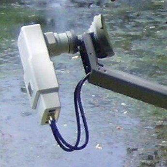

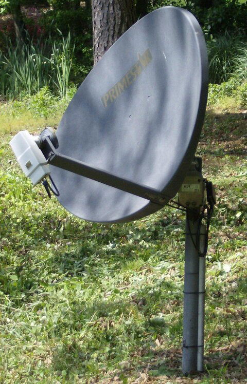

I just got a large 39x32" eliptical P* dish with the feed arm and lnbf and I'd like to mount a 40mm throat std linear LNBF in place. I've been searching for hours for pix & threads but no luck, I'd like to get ideas of innovative ways to replace the original LNBF using the original arm, has anybody done this?

Okay. To use the stock LNB, you need a 3X4 Multiswitch. Hook the H and V outputs to the H and V inputs on the multiswitch. The hook your receiver to the outputs on the multiswitch. The receiver will change the polarities for you in concert with the multiswitch.
Now, to add an aftermarket LNB to the stock arm, you have two options. You can cut the plastic housing off of a LNB, under that pretty plastic is the same 20mm neck you need for the P* arm. Then make yourself a clamp from a conduit clamp or something like that, bolt it up, there ya go.
What I did was to drill a hole in the middle of my P* mounting boss, screw a hose clamp to that, put my QPH-031 Invacom in there, tightened up the clamp, and watched TV. Yeah the throat doesn't fit the 20mm mounting slot in the arm, but I am not cutting the plastic off of a 60.00 LNB either. Anyway my P* doesn't care, it works like a charm.
I am sure someone will come along with more ideas, but what I've shared is what I have learned and done since I started in February. :D
