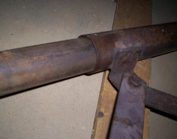

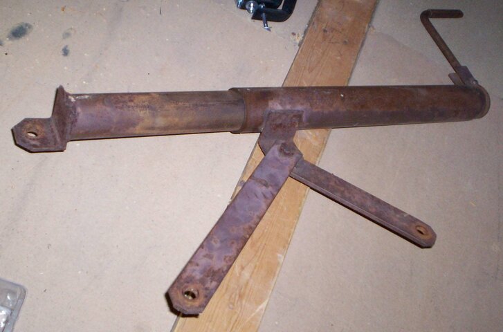

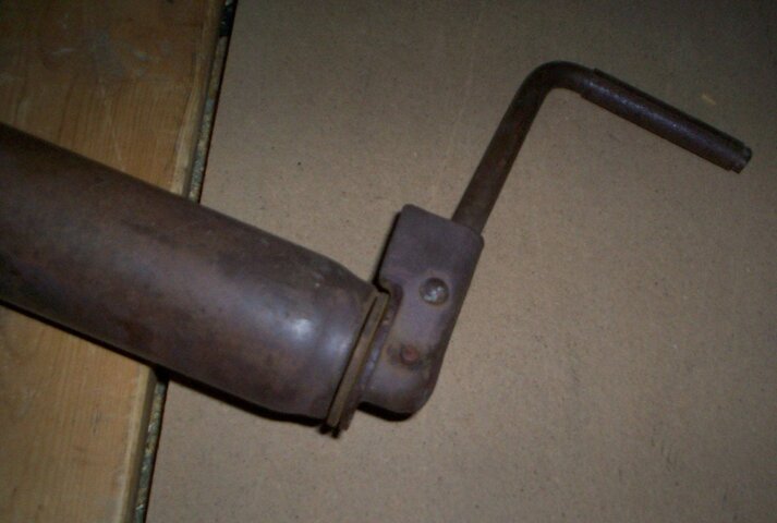

Here's the hand crank I have. It was originally on a 10 foot fiberglass dish.
It actually works very well, even on a heavy fiberglass dish.
Notches are sawed into the inner tube where it lines up with the outer tube for your satellite positions.
