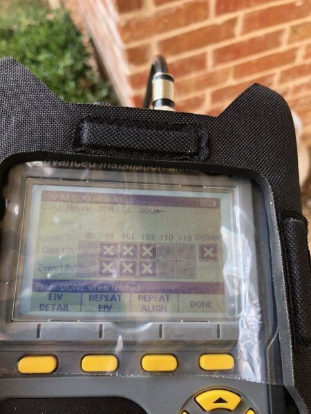

I have tried everything under the sun to point this dish and get a connected with no success. I have spent hours looking at the meter on the receiver and get all 0's. I have leveled the pole so many times I'm starting to dream about levels. I even bought an AIM 1.5 meter and still can't get it done - that's how bad I am at this!!
I'm in the Dallas area so it tells me to point as follows:
Az - 183
El -51
Tilt - 84
I start there and adjust Az to get strongest signal then adjust elev for the same. I have even had the signal "lock" on the meter (had the signal in the -32dBm range) but when I run the EIV I get all X's. See attached picture.
I have pointed non HD dish with great success but this one is getting the best of me. I have not idea where to go from here so any help would be greatly appreciated.

Ok, some success. I'm now getting check marks on satellite 101 but X's on 99 and 103. If 101 is coming in, is it a skew adjustment to get 99 & 103?
Could be. Are the numbers on 99 and 103 about the same? What signal strength numbers are you getting on all sats and transponders? Don't worry about 99s and 103s.

99/103 are so dam sensitive, the slightest warp will prevent you from getting a good signal.

Finally success!!!
Amazing advice from everyone, thank you! Here were my lessons learned:
1) getting that mast level is the absolute key. It's everyone's first advice for a reason. My problem was I would get the mast level then when I put the heavy dish on and adjusted it would move off center. Finally got small magnet levels that I could use on the actual dish bracket and leveled with the dish on.
2) I had a restriction that was blocking the dish pointing in the optimal direction. The satellite pointer app as recommended above really helped. I struggled with your basic compass getting consistent results.
3) Once I learned the dithering process I really got to a good reading.
Thanks again for all of the great advice.
