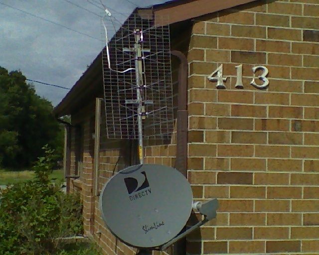

This is my tv antenna I can get Fort Wayne sometimes South Bend. I have off brand 4 bay tv antenna with a Antennacraft 30db booster from radioshack has worked well for 3 years now. During the summer months I can pick up a lot more tv stations.
