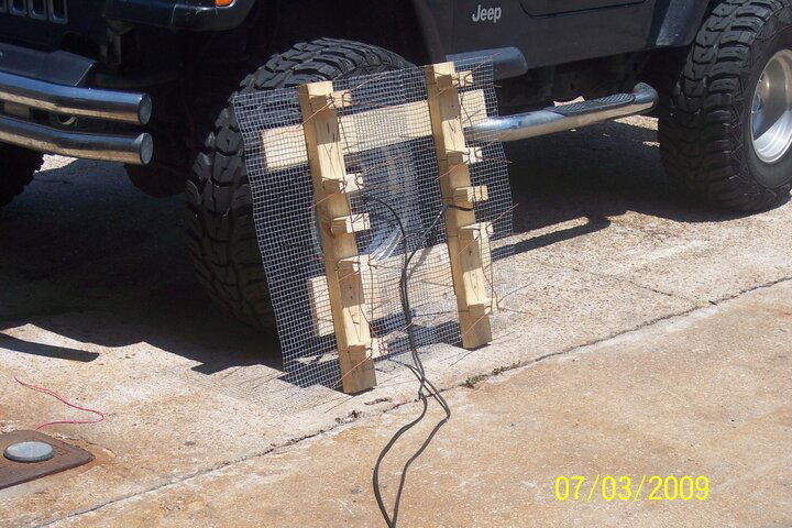

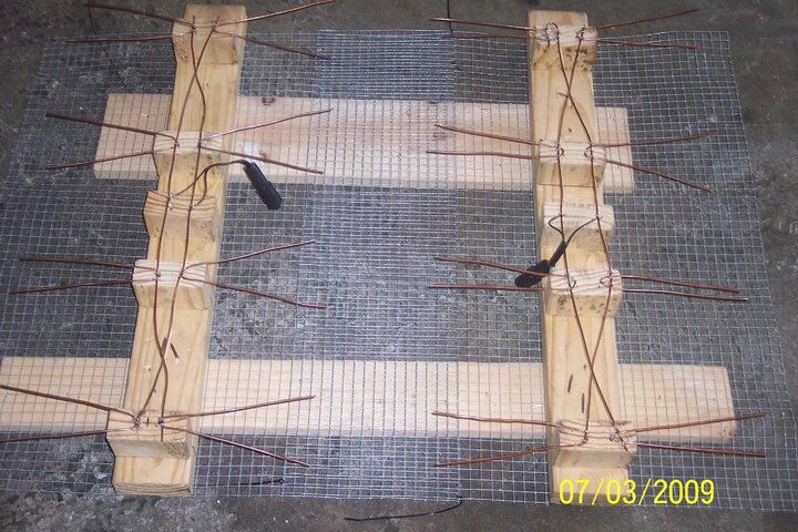

A two bay antenna. A good deal BUT I like my home made 4 bay better.

I built a GH about 6 months ago. It was pretty rough, I just wanted to see if it would work, then I intended to make a better one taking more time if it worked ok. It worked fine, my neighbour has it in his attic picking up a couple of uhf stations. The tower is only 15 miles away so I can't really say how good the antenna is for long range.
I used 14 gauge house wire for the elements and tin foil over cardboard for a reflector.

Yes the wires are stapled down but they need to be soldered to really work long term. I am about 38 miles out and have about 20 channels with my cheap conveter box.
