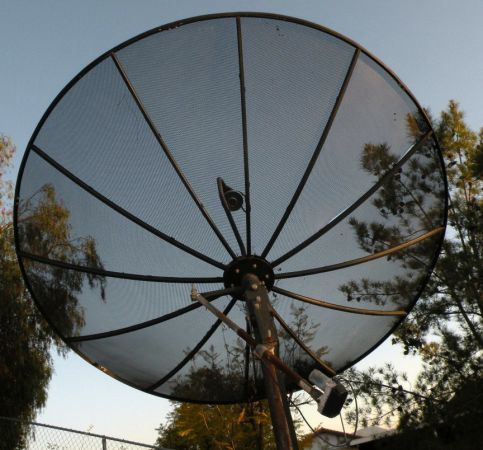

That looks to be a SE-10, 10ft Orbitron. My friend & member ivanyankoff has one just like it.

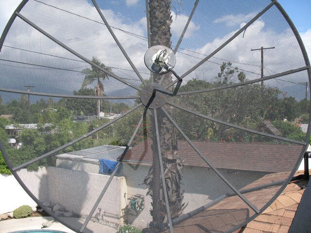

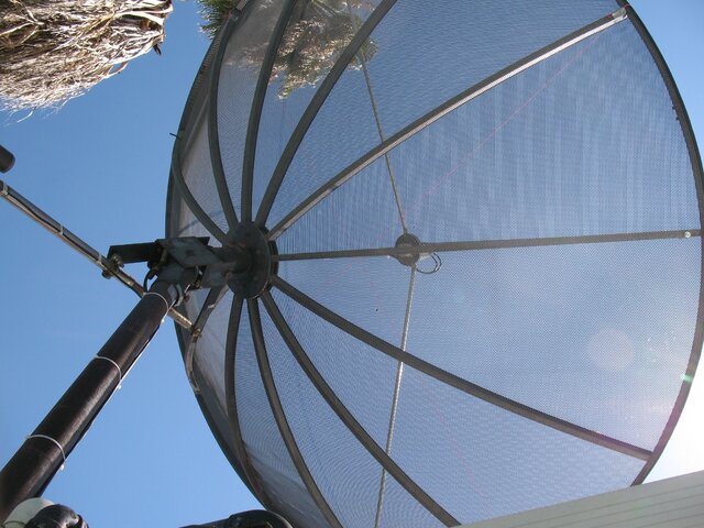

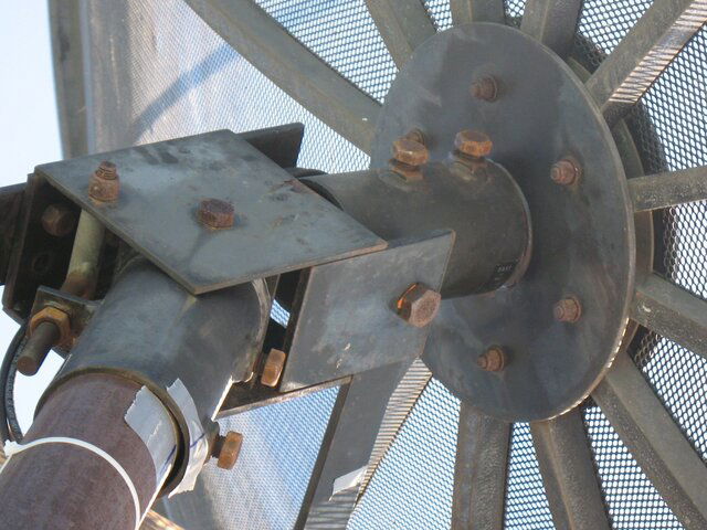

Yes, the ribs & rim disassemble into pieces - 12 ribs & 6 rim arced pieces, IIRC. Plus the rim beading & 12 panels, declination tube & buttonhook center plates. And of course the polar mount.

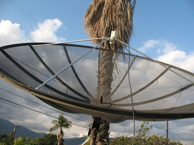

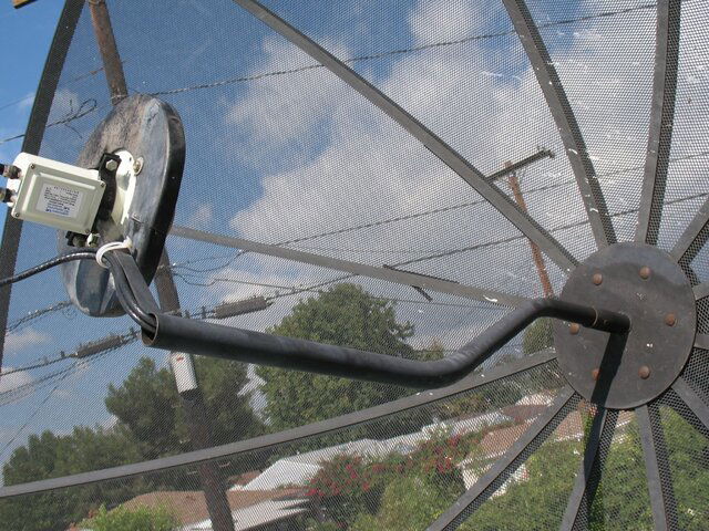

Pics show ivanyakinoff's SE-10 which I converted to quad leg with 1/2" emt because the buttonhook sagged so badly. I don't remember the leg lengths but they were less than 60". Then some wild winds blew palm fronds through the dish panels & I had to fix it again. If only he had had that palm tree trimmed. Yup. That %!**%#!!! palm tree behind it.
Use your search for posts about Orbitron teardown by member BrettBardi who had difficulties because of the aluminum center plate. Again, IIRC.
