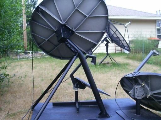

This picture was posted several years ago. *
Note that the top of the post is tilted back (north) by the same angle as your latitude.
The dish is then aimed down to where the birds are on the arc.
So, once the post is aligned for both north, and tilt angle, all you have to do is loosen one bit of hardware, and swing the dish left/right to sweep through all the satellites.

I can't see the link that woodheat/nooil posted due to software problems, but that pic that Anole posted was definitely posted by PBS. He used to be a member hear but not anymore. I tried to find the link ,but I am unable to. Follow Anoles instuctions, tilt mast to angle of your lattitude, and point top of pole to north (north star). Once you set elevation on any sat to get get best quality, you just loosen the azimuth bolts on the dish and rotate to get best signal on any bird. It works the same idea as a motorized dish, but you need to manually move the dish from sat to sat. You never have to ajust elevation or skew in this setup once it is locked onto any sat, just azimuth.

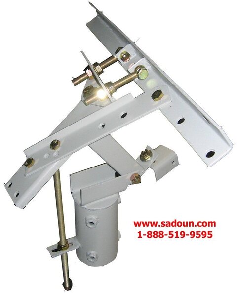

Is this what you are looking for?
We use it on the Fortec 180cm prime focus dish

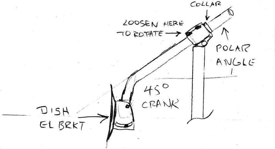

I was musing over what to do with the J-tube from my defunct SkyAngel dish and this idea struck me. Picture the J-tube mounted to the post with a clamp (see illustration) that can be adjusted for polar angle plus be loosened for rotation. If the 45 degree crank is too much for my dish's el adjustment to be in the range for declination adjustment it could be sprung open a few degrees. Some sort of an hour angle scale could be added behind the clamp. The collar shown above the clamp would keep the tube from slipping down when the clamp is loosened for rotation. I suspect a support bracket between the post and the polar axis would have to be added for stability.
Comments?

All my questions seem to be answered except possibly whether it's best to compensate for my 24.62 degree dish offset at the polar axis angle or with the dish elevation adjustment.
I was wondering what all the confusion was about.
I think this is the root.
The angle of the top of your pole is not negotiable.
It is your latitude.
The down-tilt of the dish to see the Clarke Belt is accomplished with the elevation mount on the dish, just like it is on the little H-H motors.
The problem with most dish mounts, is that they cannot go -25° to account for the 25° up-look of the dish.
On a Plumb Pole
When set for +25° in normal operation, the dish would be vertical due to its up-look.
If you could just spin the dish 180° so the LNB was at the top, without changing any other settings, the dish would still be vertical but looking down 25°.
edit: removed erroneous reference to skew plate.
In operation, it needs to look down about 5°, so tilt the dish up toward the sky 20°.
Now it looks down 5°.
Tilt the pole back the 35° (or whatever) of your latitude (depends on where you are), and you are getting close.
I feel the above is confusing, but if you pick your way through it, perhaps you'll find a light at the end of the tunnel. :)
