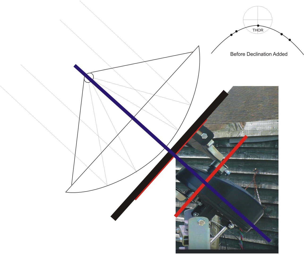

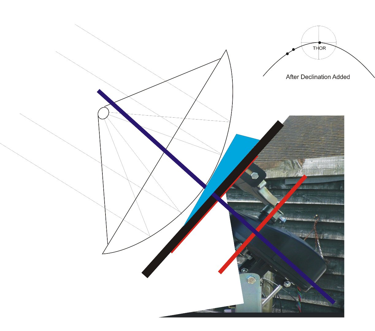

W/O going on a tangent. Declination is simply tilting the dish only after the polar angle is set properly and accurately. With the face of the dish parallel vertically with the polar angle. The pivots of the dish. If left that way. The dish will be shooting out in space over the equator.
Satellites are over the equator. So, you lower just the dish several degrees from tables, online setup aids.

Declination setting is only required if the dish will be motorized to move more than 20 degrees between adjacent satellites. Without declination setting the mount will not accurately track the arc.
Also, no need to change the leg length or scalar position for optimal FD/FL if you only wish to experiment to see if you can receive some programming from a satellite. Simply enlarge the feedhorn opening in the existing scalar to accept a standard feed diameter and fabricate a way to secure the new LNBF in the scalar opening.
In the future, if you wish to motorize the dish to move between more than a few adjacent satellites and optimize reception, then add declination setting to the mount and optimize the FD and FL by lenthening the support arms.

Declination may indeed not be an issue for a small sweep. I'm thinking for the maximum receivable signal if the dish is not going to be stationary, a well thought out method to to do it right at the get go would be appropriate.
Anyhow:

Anyhow:
View attachment 181767View attachment 181768
