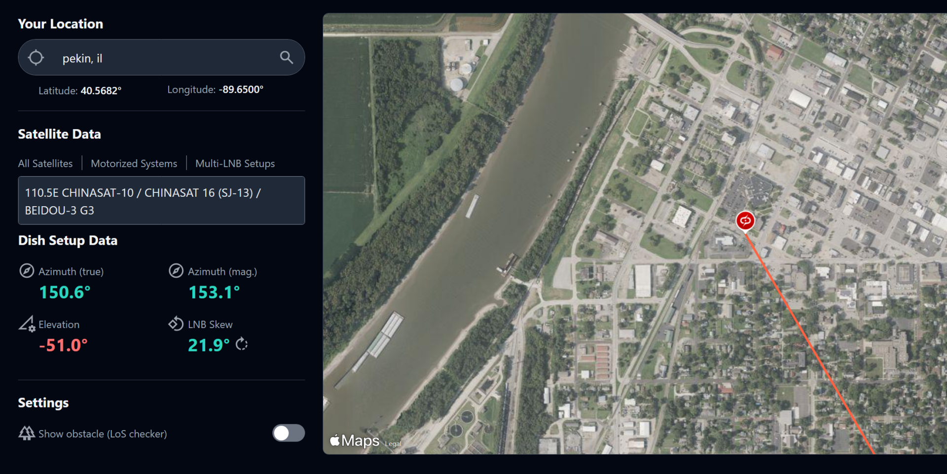

Huh... You're not wrong. I put in my city and the only sats that show up to choose from are Asian.
North here is straight up on the map
