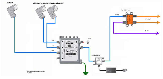

Just joined tonight. I've been with DISH for 20 years, starting with the old 3000 and 4000 receivers. Now I have a Hopper 3 and a pair of Joey 2's. Separately, I have a 211z and Tailgater. I want to migrate to a Wally. I just finished talking with DISH to verify that the new Wally's will work with less than 3 satellites (i.e. trees when camping). Is this true? Secondly, when the LNB was updated for Hopper 3, I lost my direct cable to the 211z when it is in the house and have been using the Tailgater. Can anyone verify the Wally can be use with the Tailgater and seeing less than 3 satellites? Thanks in advance ....
Yes it can. As far as in the house, it takes some modifying but changing that LNBF back to a DPP and adding a 44 switch and a 42 switch will allow you to use the Hopper and the 211 in your house.
You run 3 lines from the LNBF to the 44 switch and cable them port 1 to port 1, port 2 to port 2, port 3 to port 3. Port 1 output to the 211 with the power inserter inline before the receiver or output 1 to the power inserter and port 2 output to the 211.
http://www.prosatellitesupply.com/PDF_Files/DPP44_Switch_Installation_Guide.pdf
Then use 4 "jumpers" from the Add Additional Switch outputs to the 42 switch. Here's the wiring diagram for the 42 switch to the Hopper. Just make sure you run a check switch on the Hooper and on the 211 whenever you move it from the house to the tailgater and back
