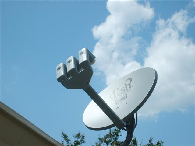

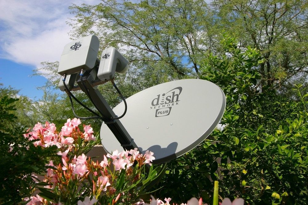

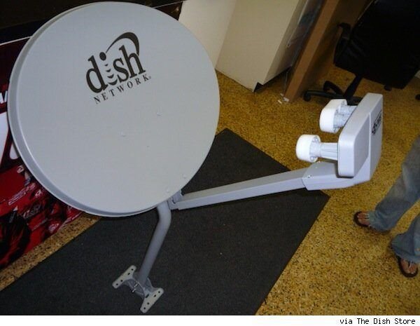

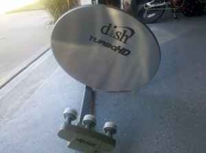

Im going to post 4 pictures tell us which dish you have, and then we can help you out, it isn't too hard

It does matter which cable goes in .. There is actually 4 lnbs thou it looks like 3.. On the center one there are 2 markings. 1 says 2D AND1 SAYS 1F. The 2D goes in the top port. The 1F goes in the bottom port.. The other 2 do not matter. The power inserter must go to the number 1 port on the bottom..Say if you have the power inserter on the 211 in must be going to the port on the far left.. Hope this helps..
Your right partly that it doesn't matter, but its better to have it in the correct order as intended incase an older box was connected, the order usually is 119=Port 1, 110=Port 2, 129=Port 3, and if you have 118=Port 4 (Port 4 is clearly marked use for FSS Connection), the OP hasn't told us what dish he has so I am still uncertain what to tell him anyways
