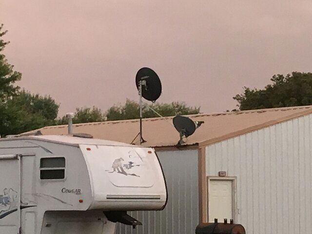

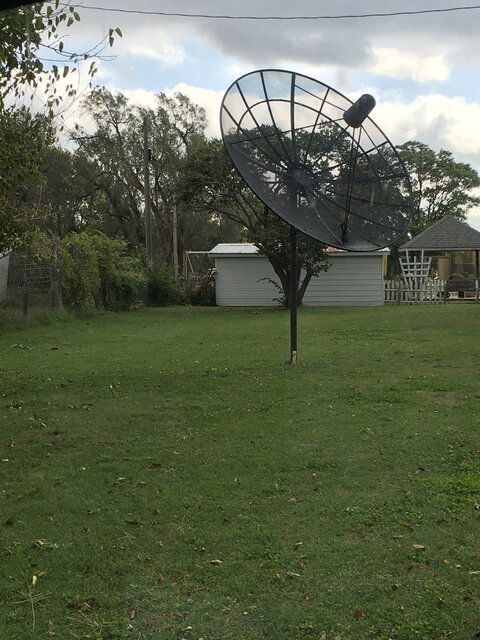

Here is a photo of the 10' dish im getting ready to replant that is around the corner from my shop, and a pic of the 90 cm dish that started the thread on the roof of my shop. Have no idea what kind of dish the 10' is as i havent really gone over it a whole lot. It does need a little repair of the mesh but overall its not in bad shape.

So i was unable to actually work today and my permits came in the mail today so i started work on accumulating misc items to start putting up fences and what not and i stoped by to actually look at the 10' dish this morning. It is a unimesh 10 foot dish. I beleive it was made by uniden if i recall correctly. It looks like I will be able to save the ribon cable too as it is run underground in 2" conduit all the way to the guys crawl space and there has to be 30 to 40 feet of it coiled up in the crawl space. SO it looks like i lucked out with close to 100' of ribon cable to boot. Ill have to spend a bit of time hammering hail dents out of the flimsy aluminum mesh, unless someone knows where i can fins some aluminum expanded metal with that small of holes.
I've had good luck with removing a mesh panel (one at a time), then laying it flat on smooth concrete and using a rubber mallet along with a piece of pipe to smooth out dents/hail dings. Perforated sheet aluminum can be used to replace damaged panels. A local metal shop may be able to order perforated sheet if they don't stock it already. If you are close to Wichita, you might also check with 'The Yard.'
I had forgotten about the yard, thanks for the reminder. I'm actually in Wichita right now but the wife says we don't have time to go by there today because we have to get the kid back to school. Maybe next time. I've nearly gotten the dish panels sewn back together and flattened out. Stopped by the other house and picked up an old video cypher 2 receiver/ dish positioner and an old Macom dish positioner. Now it's just a mater of figuring out how to use these old dinosaurs until I get the OK from the "BOSS" to buy an asc1
