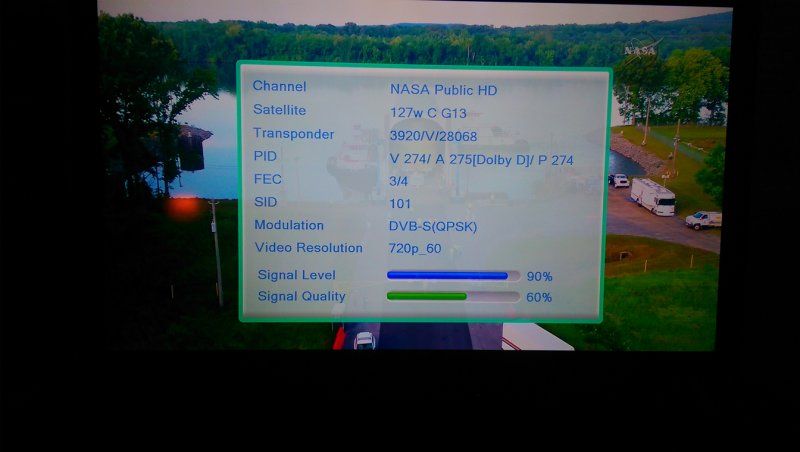

Alright so the signal for you is a little better today then yesterday and I seem to have a picture today.
Also by that screen cap It appears it can be hard to discern the desired signal from the undesired similar signals.

No, the SNR for these three transponders on my system was actually lower today than yesterday.
