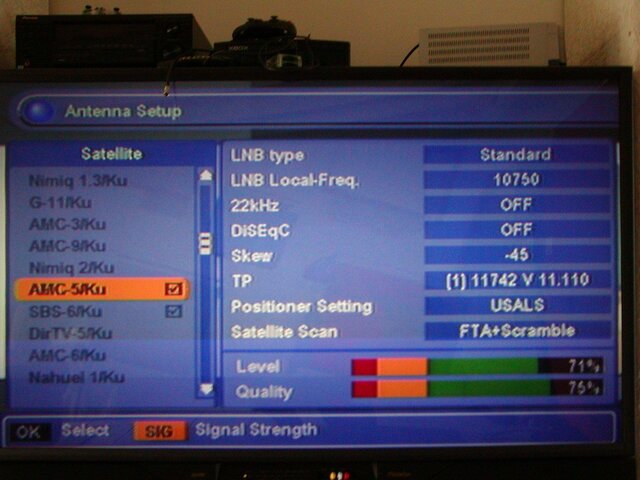

skew is 0 (stright up and down) for a mototized. The motor automtically skews the dish when it moves
Use AMC5 (much easier). Best thing to do is hook up the motor, put in your info in USALS (latitude/longitude) and let the motor move first (since you dont have a true true south)...once motor moves a little bit, then aim the dish. This way your arc will be right when you move to the differetn satellites.

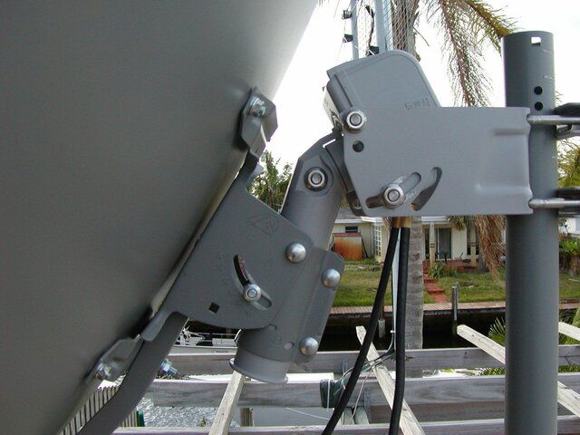

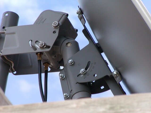

Lost
I'm lost :eek: set up my system = pointed at amc 5 - level 71% quality 70 to 75%
TP 11742 - USALS positioner - when i move the dish with the hh90 motor i can't lock on to any other sat. except sbs-6 with low quality 20-30% I have included a couple of pictures. If anyone can help, that would be great and thanks.:bow :bow :bow :bow :bow

Sadoun has a great motor installation help site here:
http://www.sadoun.com/Sat/Installation/HH-mount-installation.htm
As per his calculator, your dish elevation should be between 40 and 41 degrees. Your motor elevation should be set to your latitude. Once you set the motor elevation, bolt it tight and don't touch it. Peak your azimuth to the best signal by moving the entire motor assembly (dish + motor on the pole) east and west. Peak your elevation using only the dish mount, not the motor.
